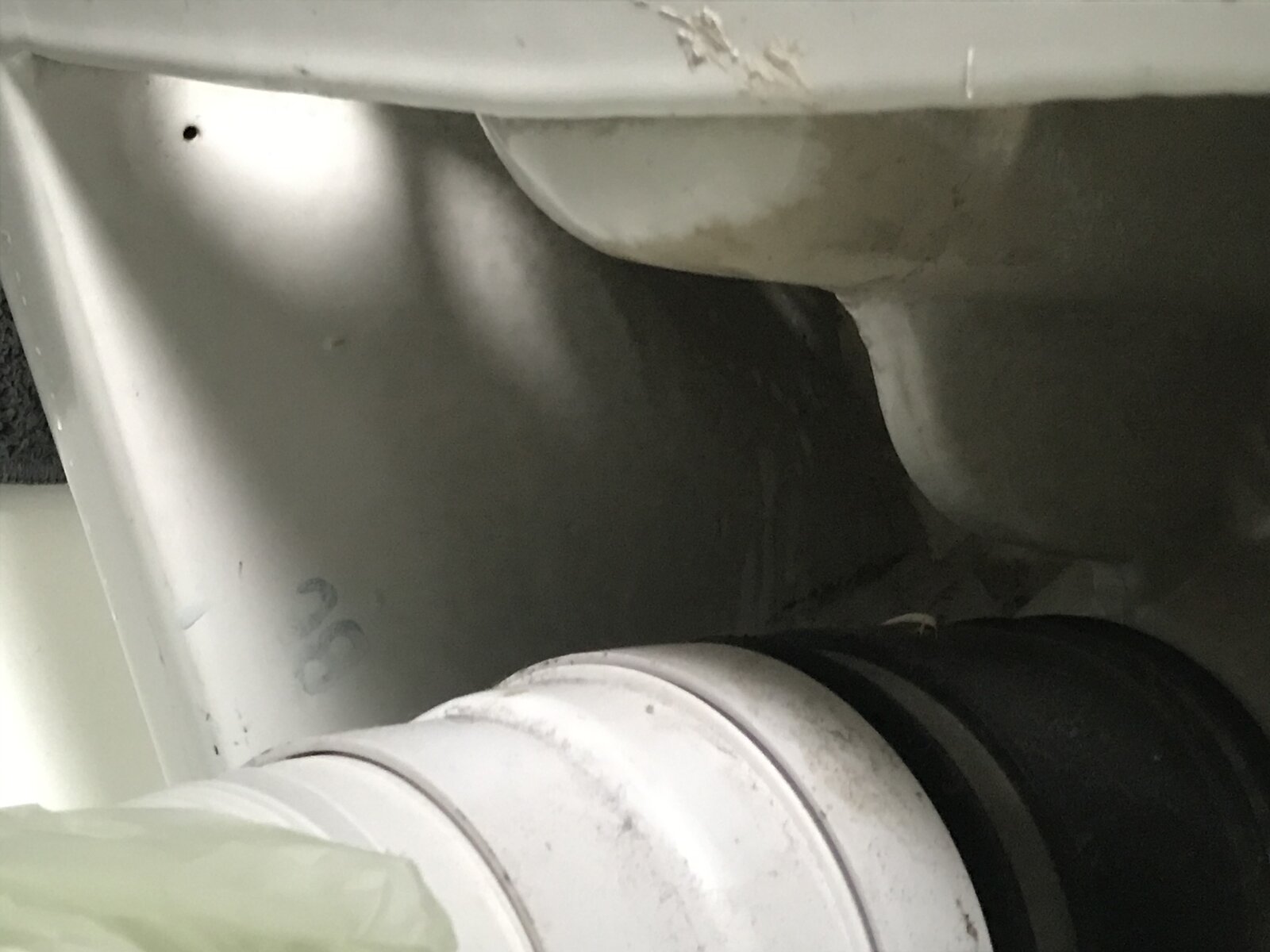

Condensation under toilet looking like a leak?
It’s leaking again but blue water, the blue dye I used in 2018, very strange!! There must be a void in the toilet somewhere.
I pulled it out and the water is coming from the small hole top left here:
