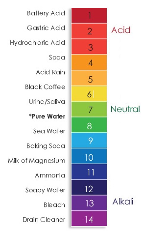

Canned tomatoes pH range is 3.5 to 4.7.
Tomato juice pH range is 4.1 to 4.6.
Likening the acidic condensate from boilers to be similar to tomato and orange juice is a little misleading.
The pH of condensate from a boiler is typically 2.9 to 4
