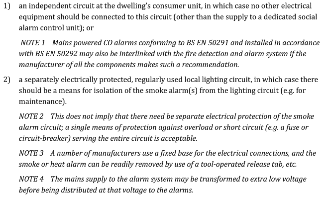

The reality of smoke alarms in dwellings:
  • BS7671 has no information on what type of circuit should be used, or anything else about smoke alarms other than 560.10 which states they should comply with the relevant parts of BS5839.
  • Legislation has no information on what type of circuit should be used.
  • BS5839-6 has two options for Grade D systems:
Option 2 being the most usual choice, as failure of that circuit is immediately obvious and smoke alarms are almost always located on the ceiling where a lighting circuit already exists.
For the Aico / Ei devices, the base is the means of isolation for each alarm.
Persons 'failing' an installation when carrying out an EICR are incompetent at best, and in many cases charlatans with the sole purpose of extracting money for unnecessary repair works.

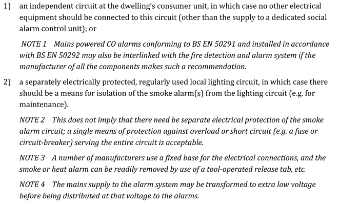

Thank you for the clarification. That all seems very straight forward to me. I'll just extend the lighting circuit to the alarm. Cheers :)
