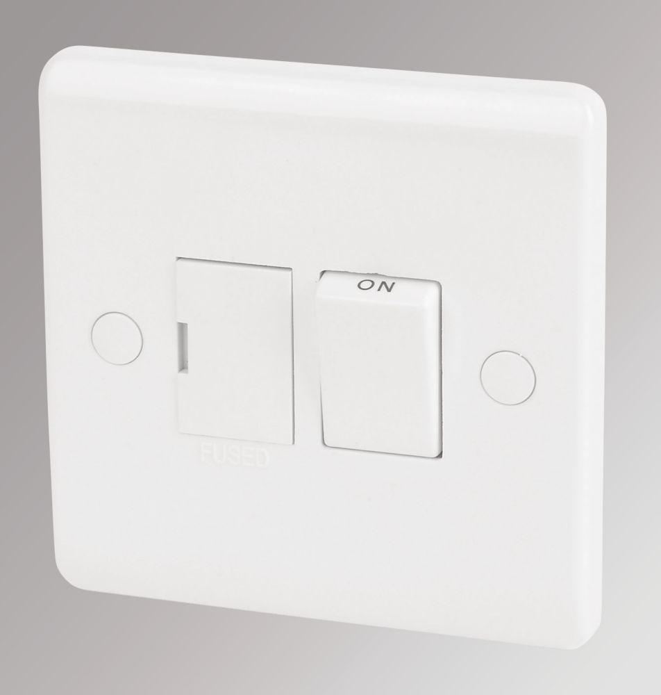

Connected shaver socket, fuse tripped, now no power - help!
trip switch consumer unit, trip switches now stay on. There are fuses behind the switches, right? How can I tell if one has blown?

no - you said spurred off
maybe something like this
somewhere
What was connected to the cable before
Does it get power from a light switch in the bathroom maybe
Although the seller does list it as such, that is NOT a spur, it is often used on a spur but it is wrong to call it a spur, it does cause confusion, even some electricians call it a spur. It is actually a Switch Fused Connection Unit. There are unswitched ones available too.
