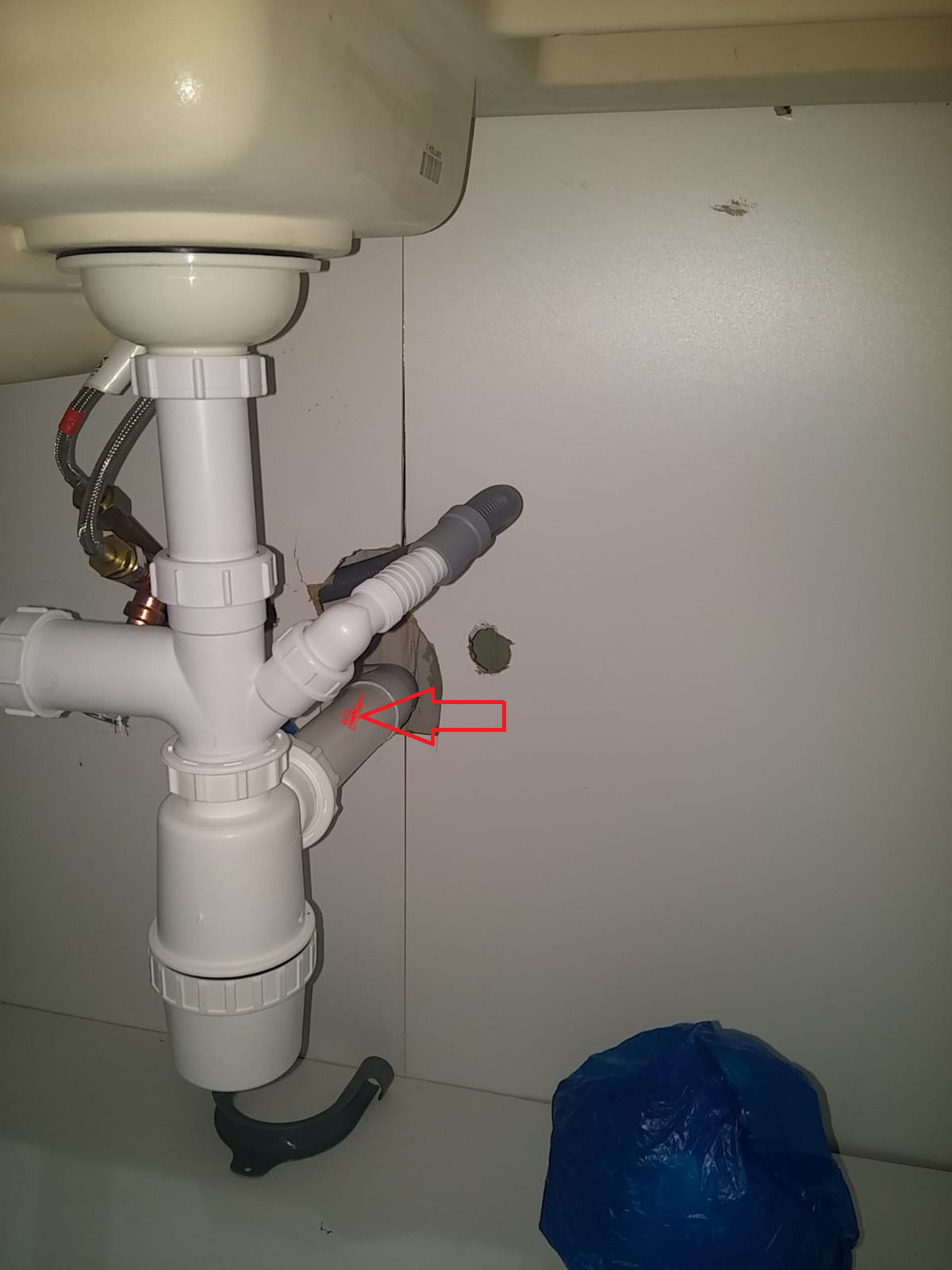

I'm want to connect my condensate pipe from my boiler to the waste in my kitchen sink..
However, my kitchen sink does not have a connection outlet for the pipe..
Does any one know how I can connect the condensate pipe to my existing waste?
Doing a bit of googling, could something like this work? If so, does any one know how to connect this to my existing set up?
Condensate Pipe Clamp
possibly ,but as we cant see your set up its a bit difficult picture a would help ,showing sink waste set up

Apologies if the pics are oversized
yes its fine,you need a hole saw.
Where would be the best place to cut the hole?
Are there any other alternative options out there, apart from what I listed?

Not had any blockages yet due to a new kitchen..
I would fit it after all the traps, just before that last bend ,going out. drill the hole on top, or cut in a 40mm swept tee, then 40mm to 21.5 reducer
just to add, that bottle trap is not good, your better off whith a P trap.

Just to clarify, do you mean here (marked in red)?
Why is the bottle trap not good?
Yes. Put a swept T in there, middle up and sweep directed away from unit towards back wall.
Bottle trap will collect crap from sink in no time as it is more restricted than a P trap.

Thanks for the help.. However some of the jargon is going over my head..
All i am going to do is create a hole with a holesaw, then stick the condensate pipe clamp from my initial post in there (with the use of solvent weld)
Hopefullly that'll be the end of that job
Thanks for the advice, re: washing machone hose and flexi taps.. Will make the adjustments
