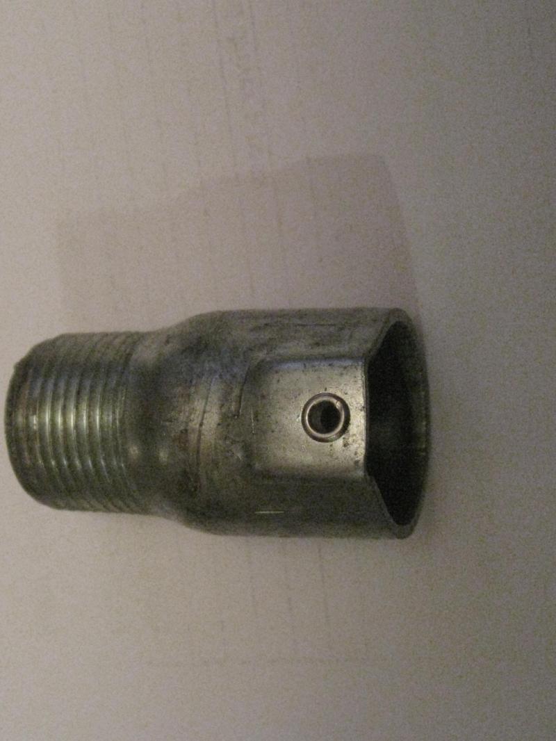

What would you use to connect conduit to trunking?

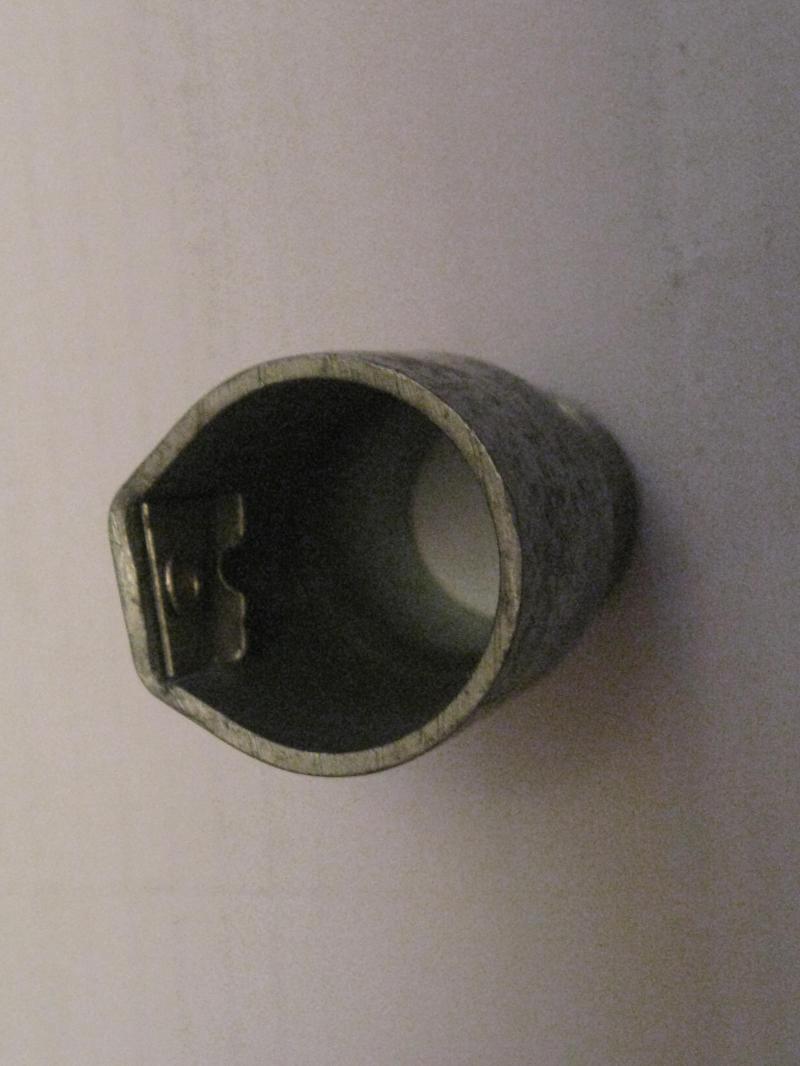

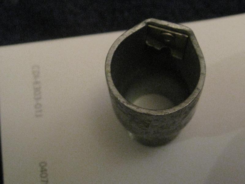

If you like them BAS, by all means recommend and use them.
Personally I think they are tat. They also most likely do not conform the BS.
Why would they not comply?
I would use a British Standard conduit coupler and bush, and cut a thread on the end of the conduit, as intended.
I wouldn't use a flimsy piece of steel attached to the conduit with a grub-screw.
