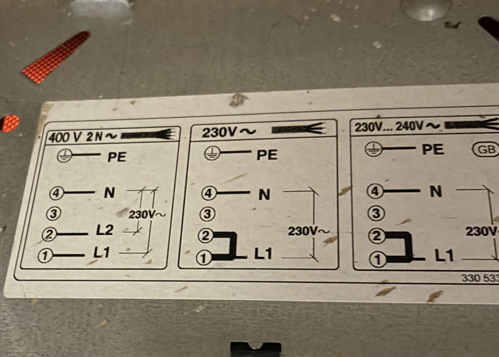

But here's the wiring diagram from the hob:
There's 2 leads, one from the mains and one from the cooker.
I've tried various permutations with the live as follows:
Cooker - L1, Mains - L2 = 2 right hand rings on hob works, but 2 left hand rings or cooker doesn't
Cooker - L2, Mains - L1 = 2 left hand rings on hob works, but 2 right hand rings or cooker doesn't
Cooker and mains - L1 = 2 left hand rings on hob and cooker works, but not the right hand rings
Cooker and mains - L2 = 2 right hand rings on hob and cooker works, but not the left hand rings
I'd appreciate any advice on where I'm going wrong!
Many thanks
John

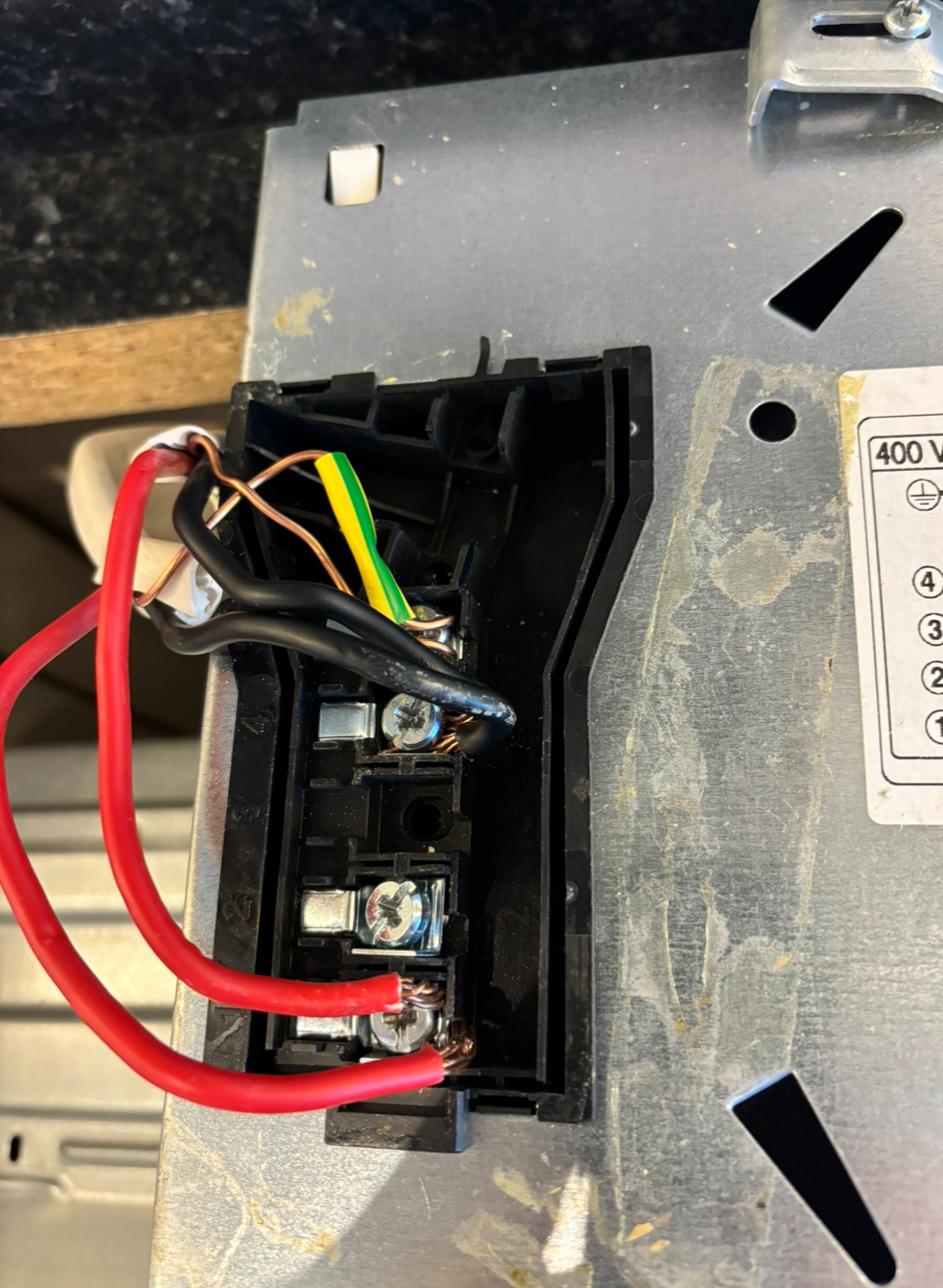

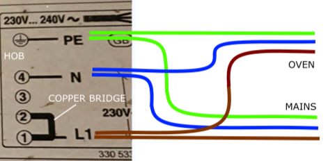

Thank you both and the annotated picture! Apologies I don't know what he copper bridge is! I've attached a photo as below which I think is following the diagram but no copper bridge and the 2 left hand side hobs work, not the right hand side.

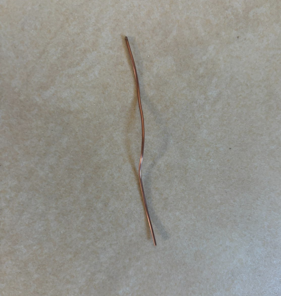

There should be a copper link which connects together the two L terminals.
If you don't have one, just use a piece of the large size wire.
Thanks, yes I don't have one. Sorry, please bear with me, not sure what you mean when you say use a piece of the large size wire?
Usually the mains cable will be larger than the oven cable - but looking at the picture they look the same.
Sorry I was being thick! So as below and just use this to connect between the 2 live terminals?
Sorry do you mean that I shouldn’t cut a piece off the red mains wire and use that?
