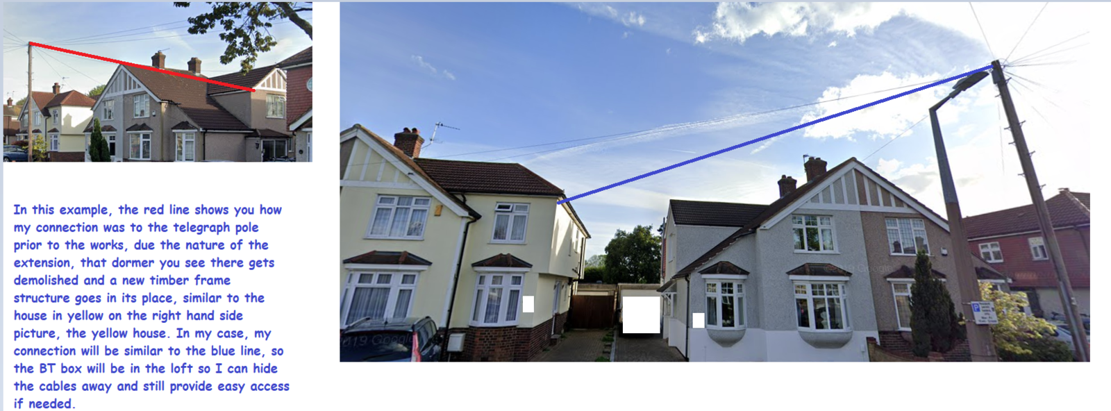

We just had an extension done, and due to the nature of the works the cable from the pole was detached from the house, now we are at the stage where it can now be added back.
Before the works, below is a summary of the setup.
From the pole there is a black twisted copper cable attahed to the fascia board of the house, thesame cable goes into one of the rooms with a BT branded box, from the BT wall box, there are 2 extensions that go downstairs, one for a phone socket and the other for my broadband socket.

Now I want to imitate thesame setup above, but things are a little different now. Prior to the works, the twisted copper cable goes into a room (its one of the 3 cables shown above), now with the extension which now has a roof at a raised level, the connections will now go into the loft. So the BT box can now be in the loft, and a new cable can be dropped from the BT box/loft location to where I intend to have the modem/telephone.
I want to have 2 sockets coming off the main BT box in the loft, one for a phone and 1 for broadband, should I extend the broadband one first from the loft, and then run another extension from the broadband point, or run 2 seperate extensions from the BT box in the loft onto the 2 locations.

I dont think this matters now, I have explained on the picture below.
The pole - and the cables coming off of it are AFAIK the property of BT and your interference with it could get you in deep doodoo with them.
I only disconnected my cable as the fascia board on the dormer it was hanging off got demolished.

The other end of the cable was just tied to my scaffold temporarily, normally what happens is that it has a hook which gets screwed onto the fasia board timber/wall etc, ensuring that its not sagging and very tight. What I saw everyone else doing was just taking it off and connecting it back when thier works are done. In my case, the cable only crosses the footpath.

Have you still got the old hook and dropwire clamp then to re-use? You can at least get the cable into the loft then and you don't need the scaffold any more, unless you are running the extension cables down the outside out the house?

Yes, I still have those 2 things intact from when it was taken off the old dormer, I just need to adjustt it as now the building has extended outwards by say 400mm, so the dropwire clamp needs to be adjusted, a small hole in the soffit and then screw the hook on the timber holding the fascia, then the rest I can deal with inside the loft, that is the openreach box and further extensions.
Is this the correct approach ?

Yes.
To add to bernard's post, get yourself an NTE5C Mk4 VDSL plate to go in the loft as the master. This has dedicated terminals for all three cables, you won't need jelly crimps and it will be easier to understand wiring it all up.
Extension cable should be CW1308 for indoor wiring, CW1308B for outdoors.
