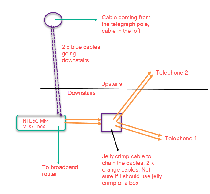

I happened to be around when a BT engineer came around to fix an issue for a relative, so whilst he was there I asked some questions and also discussed the proposals on this post to him, he has suggested a different approach to what was originally discussed in the posts earlier, so I decided to sketch this and get some feedback from others. I cannot afford to wire it wrongly and suffer low speeds etc.
I dont know why he suggested that the master socket should be downstairs instead of the loft, could be that if an engineer came out to troubleshoot an issue, it will be easier looking downstairs than going into the loft, who knows. He did say something that if there was a fault with the phone line, I can just remove the face plate of the master box or something.
Does the above look right, he said that if i went ahead with the first proposal which was to wire from the loft directly to a box downstairs, and then broadband, he said I need a different wire to do that (a wire with a plug in place already). This is possible but a lot more hassle as i would need a wider wood drill bit to drill the stud walls and have to also source a long phone cable instead of the 100m drum i already have.
Mostly, yes, stick to the blue pair for all of it, don't switch to orange pair after the master.
Thanks for this, so you are saying everything in the sketch is correct apart from the 2 x orange cable coming off the master socket and daisy chanined for the 2 telephone lines ? Here you want me to use blue instead of orange ?

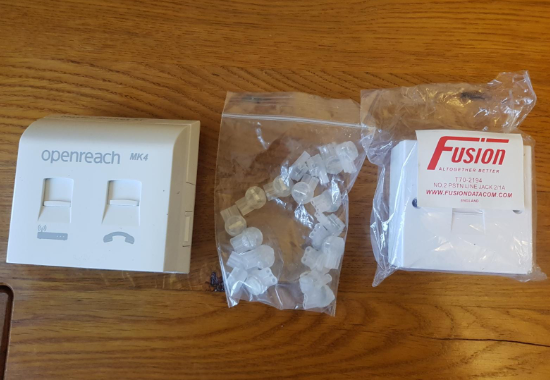

I showed him the NTE5C Mk4 VDSL plate. I ordered the following.
Yes.
Daisy chained is better than 'star wired' like your diagram. The IDC slots on the back of your extension sockets are designed to accept two wires in each slot, and NOT three. So daisy chained is easier because you won't need jelly crimps.
They look like 8A crimps and not 8B crimps(which take three wires each). You'll need 8B crimps to 'star wire' the extensions as per the diagram.
He's probably never taken any notice of the extra connection for the broadband, it is, after all, for the homeowners use and not his use. He'd normally only connect to A and B on the back, and re-instate any existing extensions on the 2,3 & 5 connector on the 'middle bit' (i.e. the 5C part).
Sorry I got my terms wrong concerning daisy chaining and star wired, the jelly thing has 3 holes for a cables and not 2.
