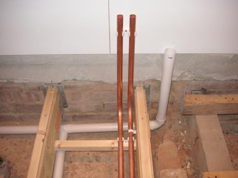

What is the vertical pipe made of?
Looks very good from that photo!
Tony
The pipe that comes up from the floor, as far as I know, is the original pipe, which at this stage I'm assuming to be Galvanised steel.
The floor above that is expensive porcelain tiles and with underfloor heating, so pulling it up would be carnage. If the pipe had failed, I would have to do it, I accept that, but at this stage, it hasn't so tearing my beautiful bathroom up is less than appealing.
It's one of two ways I can see to join to the existing blue pipe, with the other being to remove bricks beneath the DPC through both skins of the cavity wall and attempt to make a connection among the spiders webs and god knows what that lurks under there!
Actually, saying that, the vertical pipe does look good doesn't it?! It actually looks like plastic.
The first time I see it is horizontally, coming out of the foundations about 1 metre down on the other side of that wall.
I need to dig further I think, see what I find.
Right, I've had a further dig. It's more mysterious. Here's what I have. This photo was taken immediately outside the wall to the right of this picture...
(original pic reposted)...
Outside...
The pipe coming in from the right is the supply. It's magnetic, so I assume it to be galvanised steel. The vertical branch pipe is the current outside tap. Again, magnetic.
The pipe going out of the left side is the one that comes up through the floor inside the house . It's not magnetic. Black plastic can be scraped off it, but it appears to be inserted into one of the (threaded?) ports on the T-piece.
So, what could it be?! Bear in mind that it's likely that it was original. If it was plastic, it wouldn't be into that fitting, would it? Could it be some sort of plastic coated lead?!

Are you saying that since taking pic 1. the area shown has been covered up with a new bathroom floor? If so, there is still ample room to work in the crawl space.
Pic 2. shows a galvanised steel supply, riser and Tee. The black pipe is plastic, probably ABS as suggested above.
Wherever encountered, galvanised pipe, like lead pipe, should be replaced by more modern materials.
The water service pipe should be in one piece MDPE (the blue stuff in pic 1.) from external stop-tap to accessible internal stop-tap.
Some "water inspector's" dont allow Tee-offs until after the internal stop-tap.
The plumbing arrangements in pic 1. are amateurish, they will possibly give difficulties in future use.
All pipework should be hung from joists -
compression fittings should not be used in inaccessible places -
the waste is falling one way, and the new WC drainage (grey soil pipe) appears to be falling the other way?

Looking at the first pic, you'll see hefty joists in place over some of the sub-floor. These now span the whole sub-floor. What is 'crawl space'? I'm pretty sure that this type of structure was never designed to enable someone to crawl around under there retrospectively.
Bottom line is, there is no way to get to any of the pipework inside the property without such severe disruption that I would take the other option of simply burying the existing pipe and forgetting about it. (bear in mind there are no evident symptoms at this point in time).
As I said, the bathroom is complete and I've just finished a really advanced kitchen project. The pipework internally has been completed to a very high standard, as has all the work, but getting to where the blue pipe connects to the stop-cock would be next-to-impossible.

I've had a chat with my local Water Authority and, although I've not had an inspector round at this stage, they didn't have any concern for a connection being made to that Black ABS, providing it's done in a suitable and reliable way. They were of the opinion that it's on my property, so they take no responsibility and consequently, no real interest.
Understand that in an ideal world, I'd have no hesitation in pulling the steel pipe up and replacing it, but this is very far from an ideal scenario, hence politely asking for some help (but not just taking the easy option and pretending I never saw it).
Your new pic shows that there's obviously no space to crawl or work below the joists.
I have never seen a plastic pipe threaded and inserted into a steel fitting like that as far as I can recall.
But it seems to be ok and will not rust.
Is it possible to connect to the blue poly pipe inside the house and run a new one in elsewhere from the outside?
