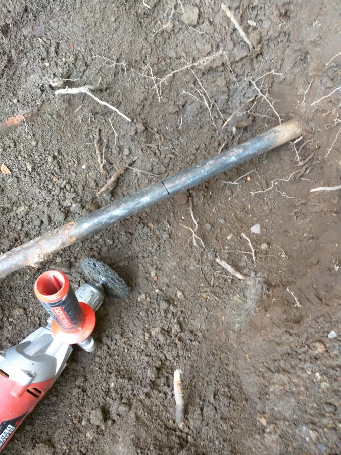

I ended up getting the Plasson Plass4 universal coupling because a local plumbers merchant had them. They didn't have the elbow version so I had to go for a straight connection.
Firstly I cleaned up the pipe with a wire brush on the drill. The pipe was covered in big lumps of rust but they wore down eventually as the fitting needs a smooth surface.

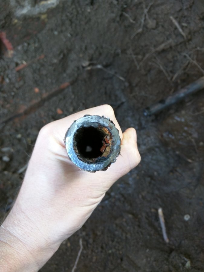

I cut the pipe with a little angle grinder with a cheap metal cutting disc from screwfix. Went through like a hot knife through butter!

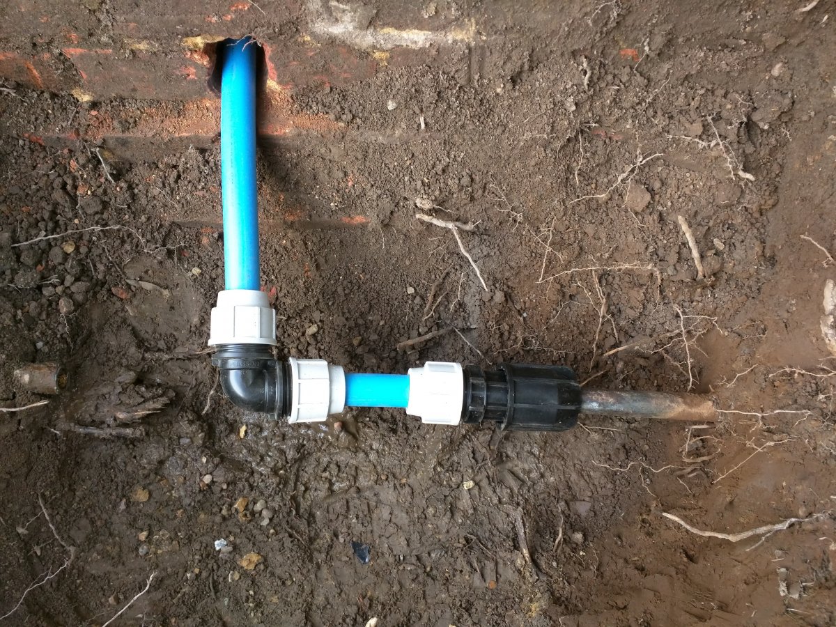

Finally the Plass4 coupler and elbow went on without a hitch
Yes I know the MDPE should be in a sheath through the wall but this is only a temporary supply whilst the builders dig around our property.

The fitting is surprisingly solid. It has 3 metal teeth inside which sink into the outer surface of the pipe when you tighten the nut. I pulled hard on it before turning the water back on and it didn't budge, and that was before I found a wrench to tighten it up further.
You should always pull hard to help the teeth dig into the pipe.
As well as making sure it does not pull off!
