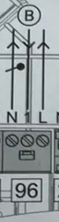

Hi,
Does anyone have any experience with connecting a new viessman vitodens 050 to a hive receiver. I’ve posted the book .
It’s looking like we connect it to D for opentherm on viessman and hive receiver
Connection 1 and 3 but i am not 100%.
Help appreciated.

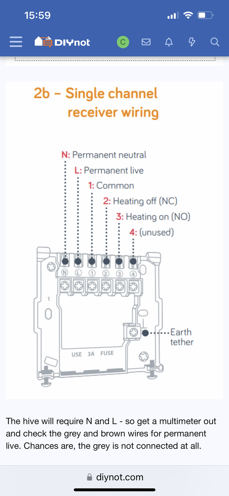

Hive is just an on/off 'stat. It does not have Opentherm connections.
If you wanted to use it on your Vitodens, you would use these connections:
N to N on Hive
L to L
Add a link wire between L and 1 on the Hive
And connection 'B' on the boiler would connect to 3 on the Hive.
...but an Opentherm 'stat would probably be a better choice!

Hi we are a tad confused, so to the hive receiver we need 3 core cable , from 1 on the thermal back to 3 hive , live on hive to L on boiler x96 , and N on hive to N on x96 , with a link between L and 1 on boiler x96 .
No.
L from x96 to L on Hive
N from x96 to N Hive
using a small piece of brown wire (from 3 core excess) link L Hive to terminal 1 on Hive
B from x96 to 3 at Hive
