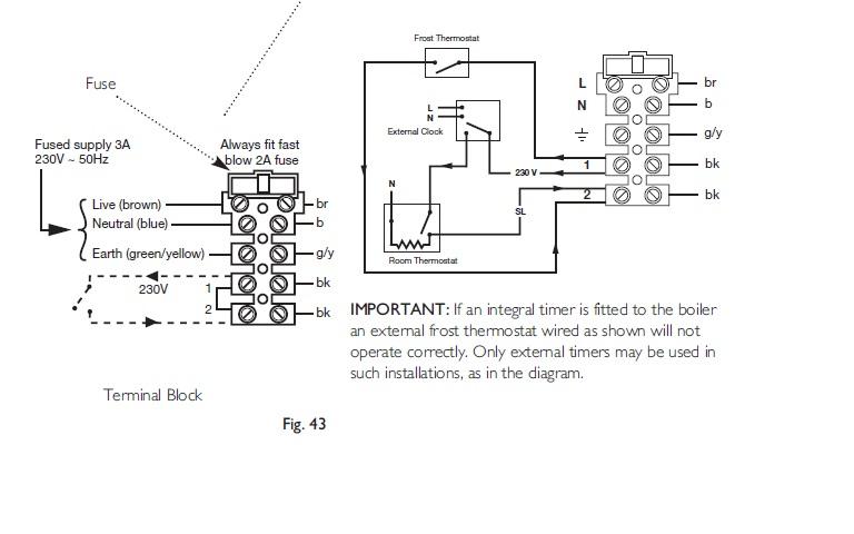

Hi there,
I have some help connecting DT92E wireless thermostat to my existing Potterton Performa boiler. The boiler has integral clock fitted.
The thermostat has N,L,L & A,B,C connection while Boiler has L,N,E,T1,T2 connection. I have connected T1 to A and T2 to B.
I understood that I need to disconnect line from Boiler L and connect it to first L of thermostat and then connect second L of thermostat to Boiler L. Also connect Neutal to both Ns and leave earth connected to E of Boiler.
Is this correct?
Or buy four core cable and connect T1 to A, T2 to B, L to first L and N to N.
Thanks, Shelvin[/img]

Thanks for your suggestion. I will have a go tomorrow with this. It does make sense but confused with the boiler diagram given in the boiler manual.
One more question: The boiler diagram has said that the frost thermostat won't work as it shown and DT92E has frost thermostat functionality as well so I guess your way should enable that function as well. Not sure why do I need to use frost thermostat function if we keep boiler on time control while away.
Also I need to remove connection between T1 and T2 as well.
Shelvin
Just ignore the boiler manual. It was written before digital/wireless stats etc
were available.
Yes the DT92E frost function will work. If you are leaving the boiler on timed control (presumably with a low temperature) that will be OK as well. The frost function comes into play if the heating is turned Off and the room drops below the set temperature (about 5C, but user settable)
Yes. I should have made that clear.
The thermostat is now working. I have made slight change to connection.
Boiler T1 to Thermostat L.
If I connect Boiler L to Thermostat L then it will by pass all internal boiler switching between Boiler L and Boiler T1. That means, the switch on boiler to set off, water only and water & central heating doesn't have any effect. Also Timer switch won't have any effect. After connecting T1 to L, it worked as expected.

The only problem with the way you have wired it is that the relay box does not have a permanent supply to the L and N terminals. It only gets it when the timer goes ON. This is not recommended as the two units have to remake communication each time the relay turns on.
The better way to connect is:
Boiler L to Relay L
Boiler N to relay N
Boiler T1 to relay A
Boiler T2 to Relay B
The link between L and A is not required and should be removed.
