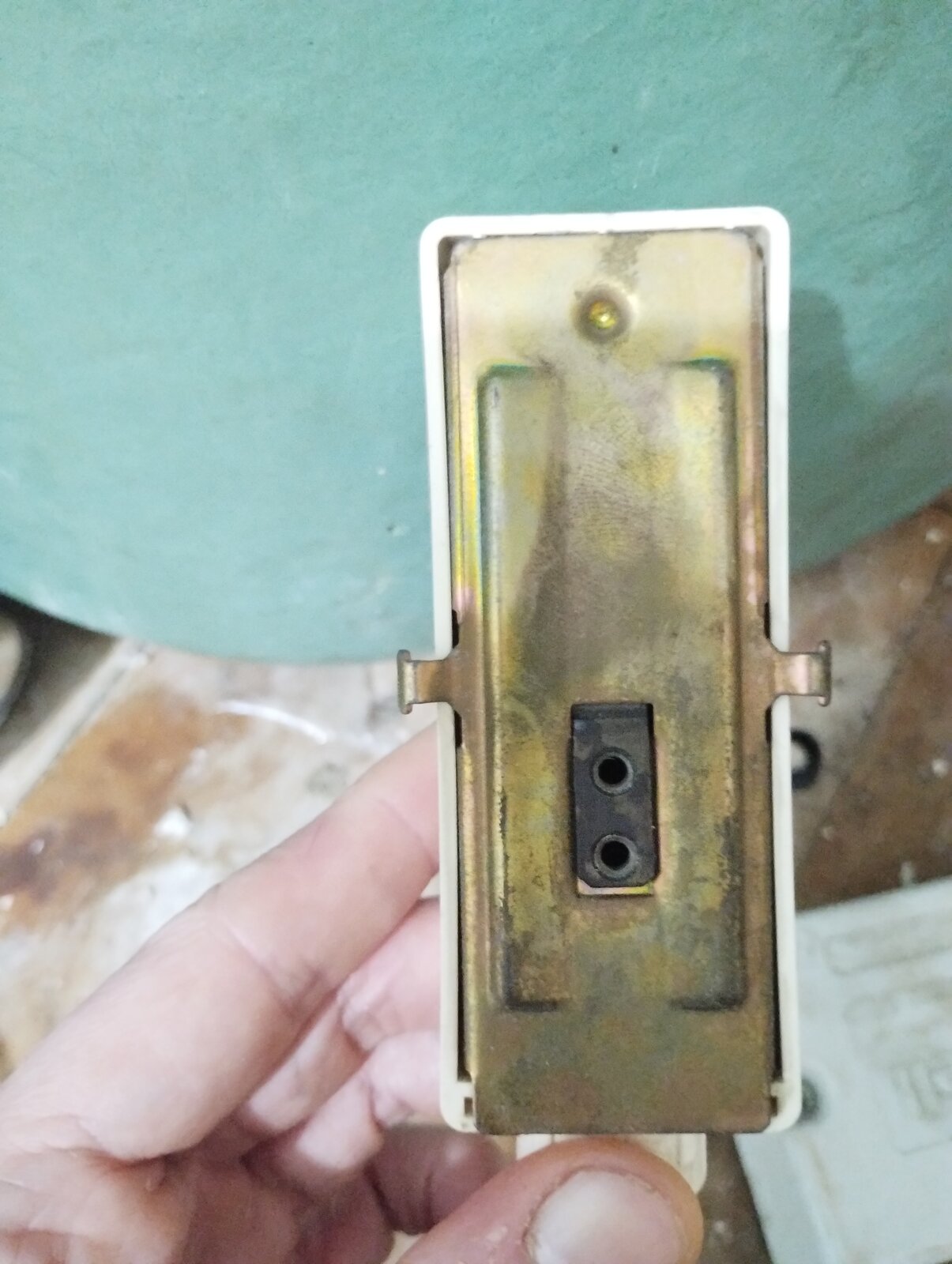

Hope someone can shed some light.
To cut a long story short when I turn my ideal logic heat boiler on it immediately starts heating water (flame icon).
Can't override with HIVE, in fact the only thing that stops it is turning the Danfoss cylinder thermostat down to near zero.
If left running it just seems to keep going even when water is well above the temp set on the Danfoss.
3 way is brand new, is the issue the cylinder thermostat?
The boiler was doing the same before the 3 ways was replaced, first place I looked was the 3 way, and it wasnt behaving correctly so was replaced. Boiler still doing the same. Further investigation led me to the cylinder thermostat.

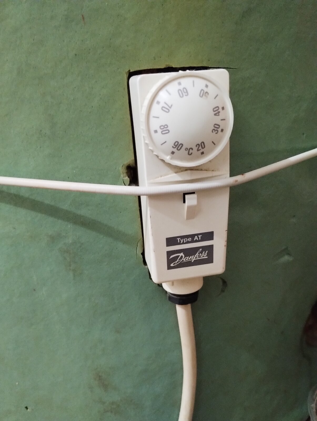

Yeah it touching the cylinder mate, although I did just go and check.
With the Hive removed from the backplate, does the boiler still fire?
As @Exedon suggests, looking at a Y plan wiring diagram, (good information here);
the Hive should definitely override the call for heat.
Im assuming you mean the hard wired part of the hive. Might take a look tomorrow. Thanks.
Further info, when the hive says off (no call for heating on stat or lights on on the hardwired part) it's still firing. The only thing that stops it firing is to turn the Danfoss to near zero. (It's like it does on and off but doesn't recognise temp I guess)
Although I appreciate if it's wiring it could be anything.
Yes, we can perform a couple of troubleshooting steps by removing the Hive receiver from its backplate.
With the receiver removed and the power isolated, you could connect a short link wire between L and terminal 1 on the backplate.
When the power is reconnected, the HW should be off.
With the link wire then connected between L and 3, the HW should be calling for heat.
If this works correctly, the Hive will likely be at fault.
If there is still a call for heat with the link between L and 1, there is likely to be a wiring issue elsewhere.
Interesting. How would this explain what's going on with the cylinder thermostat?
Or is it a case of although the hive may not show on, it is stuck on. And the Danfoss it the reaction?
Something is sending an immediate Live to the boiler to fire - with a y plan that comes from the cylinder stat and out on orange to boiler and pump live.
