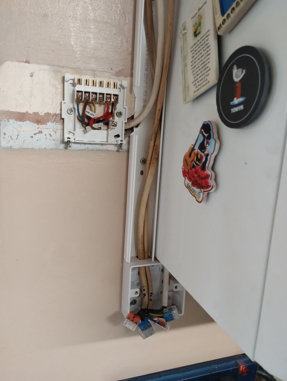

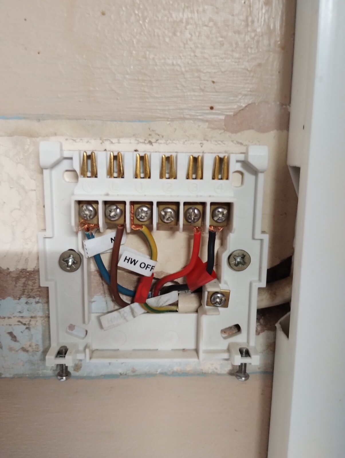

I've been looking at the hive wiring today, as a suggestion was to bypass it as a mean to see where that was the issue.
This is what I'm looking at right now, which wasn't quite what I was expecting....

If you put the brown wire from L into terminal 1 (on the Hive backplate, ensuring power is isolated beforehand), the boiler shouldn't call for heat for hot water (when the circuit is re-energised).
If you then move the brown wire to terminal 3, the boiler should start up for hot water.
If this works correctly, it is likely to be the Hive at fault.
If hot water is called for, with brown in terminal 1, the problem lies elsewhere.

Also before I swap wires around, does my hive wiring look normal to you, terminal one threw me.
Yes, the wiring will likely be 'ok' - until fairly recently, it was allowable (but not good practice) for a green/yellow wire to be used as a switched live, if it was oversleeved.

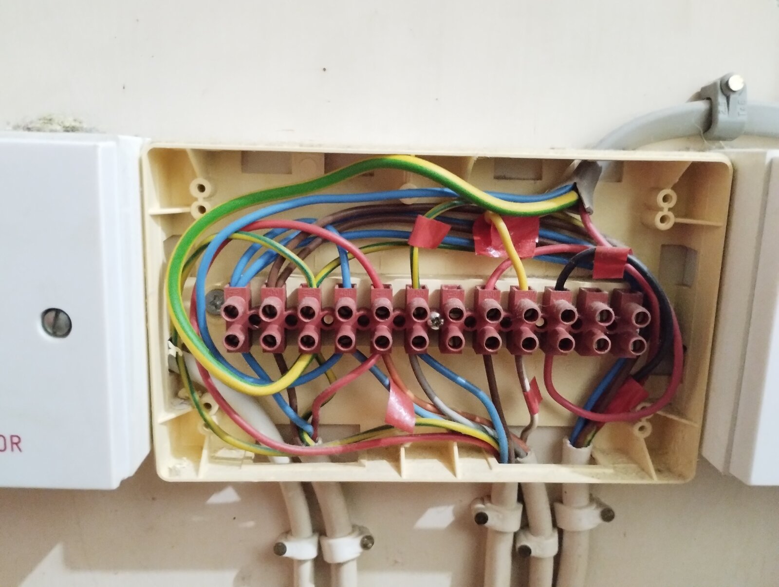

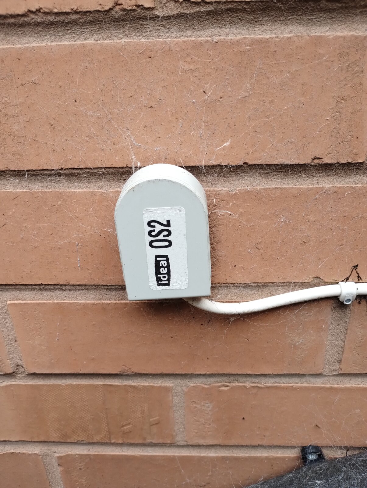

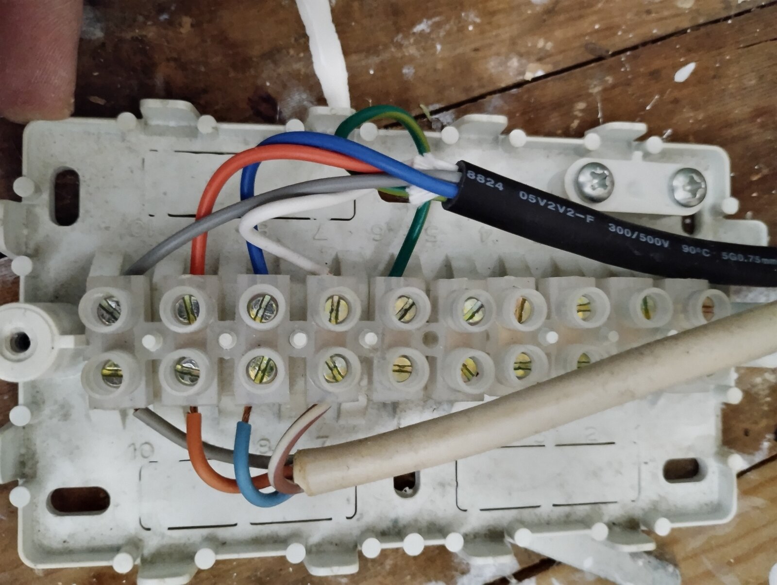

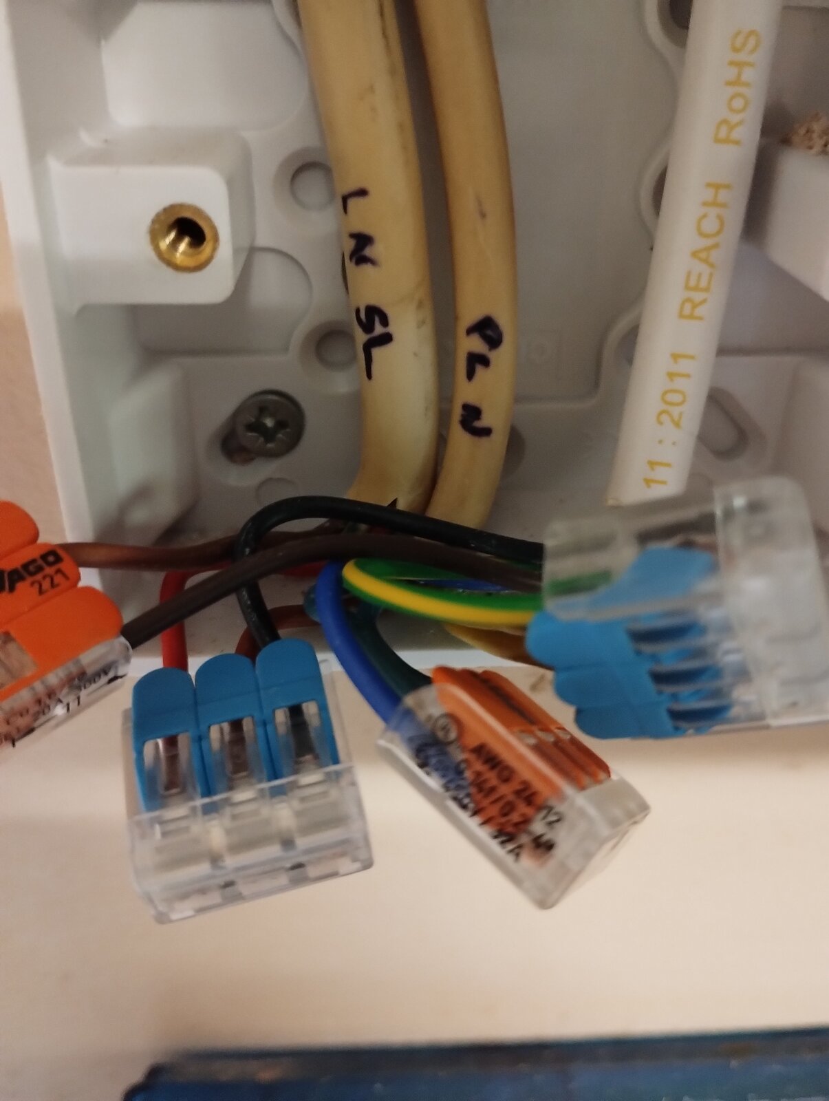

Yes, there are lots of parts and wiring on this system, I'll post some pics up for you to look at, the main wiring center I have never touched. There also some sort of frost monitor thing outside. 2nd pic is 3 way.

Wiring issue right away.
Boiler and pump feed from controls.
Look at the manual. Assume nothing.
In some cases a pump over run kit may be needed which Ideal make.
That green used as HW off is bad practice
I would rip all the wiring out and start again.
