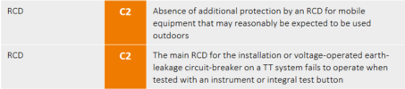

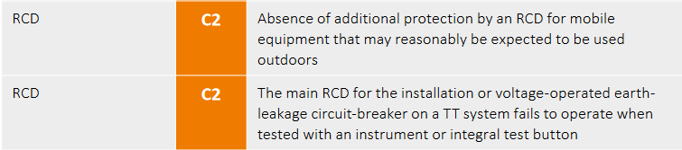

The EICR has the code C2 defined as "potentially dangerous", and I would agree hard to see why when feeding the three items shown on the CU labels it would be considered as "potentially dangerous"? It may not comply with BS 7671 as a new install, but code 4 was removed from the EICR so we no longer have the option of giving it a code 4.

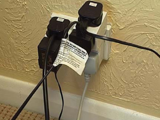

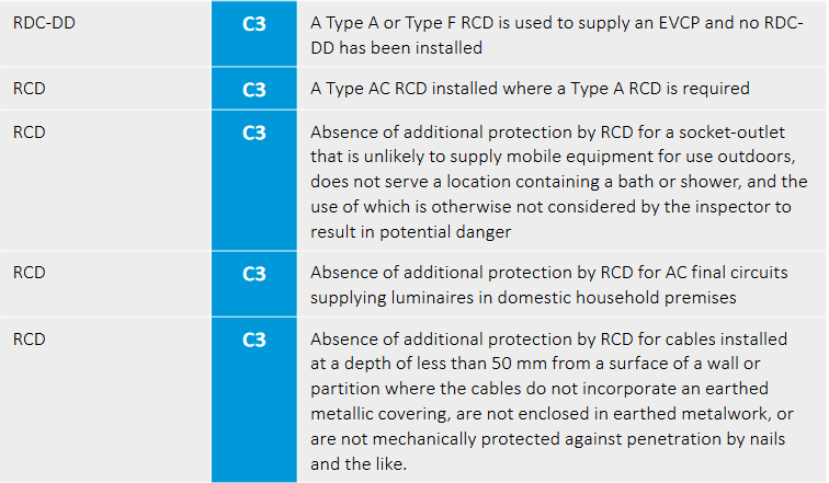

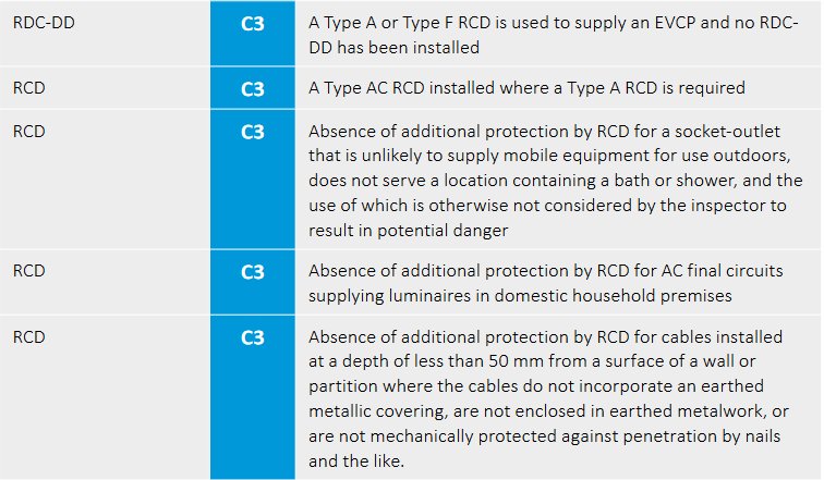

However it is up to the inspector as to what codes he issues, not us. He could decide with LED lights one needs a type A not AC RCD, I think that would be rather OTT, however it is up to him what codes he uses, most of us would use the best practice guide 4, however I Don't agree with all it says to me this 1707218059945.png to my mind is not a fail, bad practice yes, but to say more sockets must be fitted on an EICR to me is going OTT, so we have 1707218553848.png and 1707218637257.png for the C2 and C3 codes relating to RCD's so Best practice guide 4 does seem to say that should not be a fail. But at end of day it is up to the person testing not the person writing the guide or us, and it is likely cheaper to fit the new CU than get some one else to test it.
