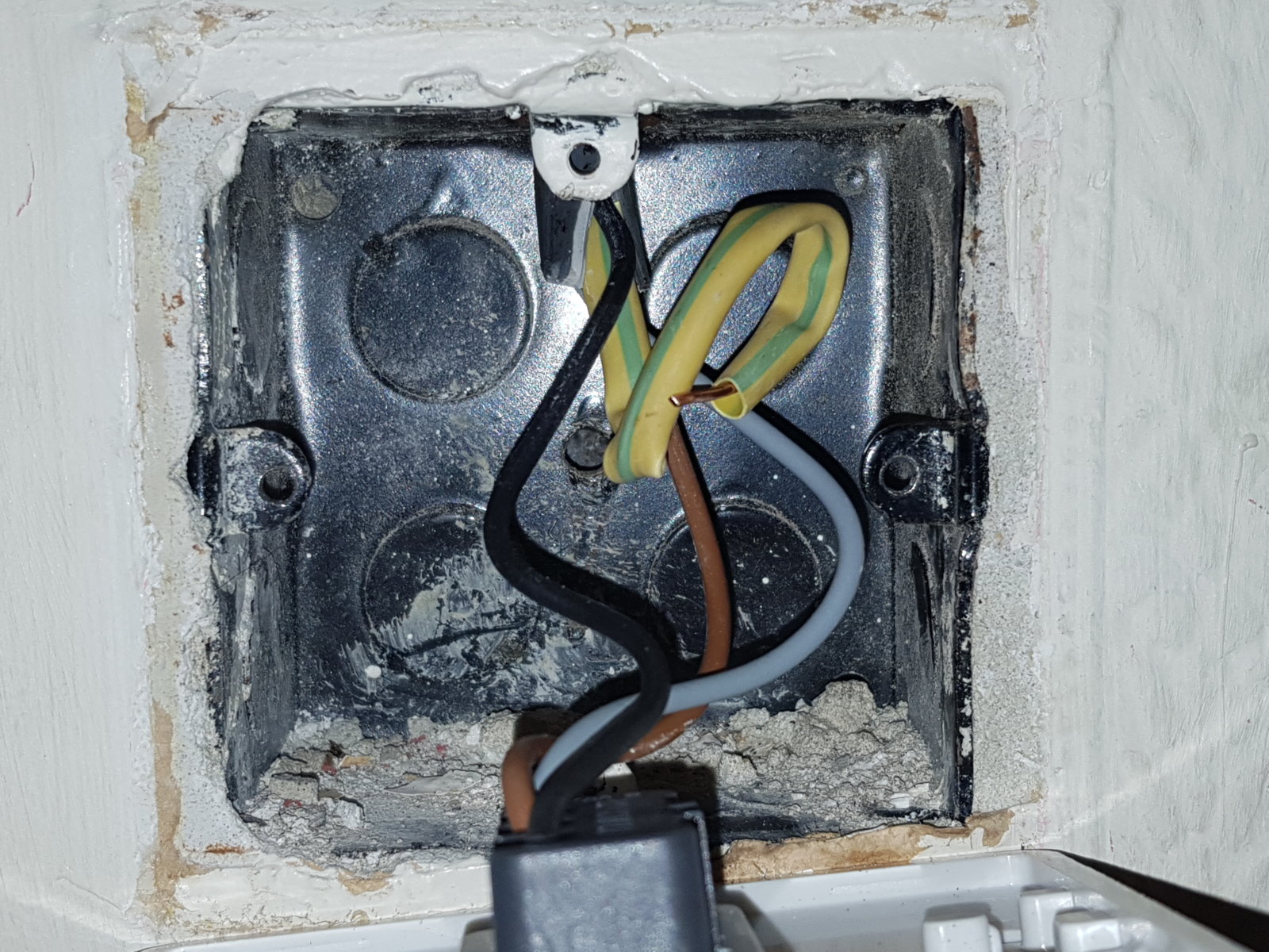

Just to clarify what I have been trying to say, I just taken the face plate off the hallway passage switch and taken a photo.
Note as I said earlier its an old style back box with no earth terminal and the screws aren't earthed as I got confused and I was remembering a socket face plate and not a simple light switch face plate.
I was thinking of drilling a hole in the corner of the back box and tapping so I can put a screw in it and connect the floating earth lead to it but I am not sure if it is worth the effort or not now ?

Just to clarify what I have been trying to say, I just taken the face plate off the hallway passage switch and taken a photo. ... Note as I said earlier its an old style back box with no earth terminal and the screws aren't earthed as I got confused and I was remembering a socket face plate and not a simple light switch face plate.
Ah it looks as if the box is held in with plaster/cement rather than 'fixing screws' - so, so much for EFLIs suggestion (with which I agreed)!
If it's a plastic switch going on there, then that would probably be the only way of doing it. However, to tap a hole you'd have to drill significantly into whatever is behind the box, so why not just drill into the wall through one of the existing holes, put a wall plug and screw into that hole and use the screw to attach the earth wire?
