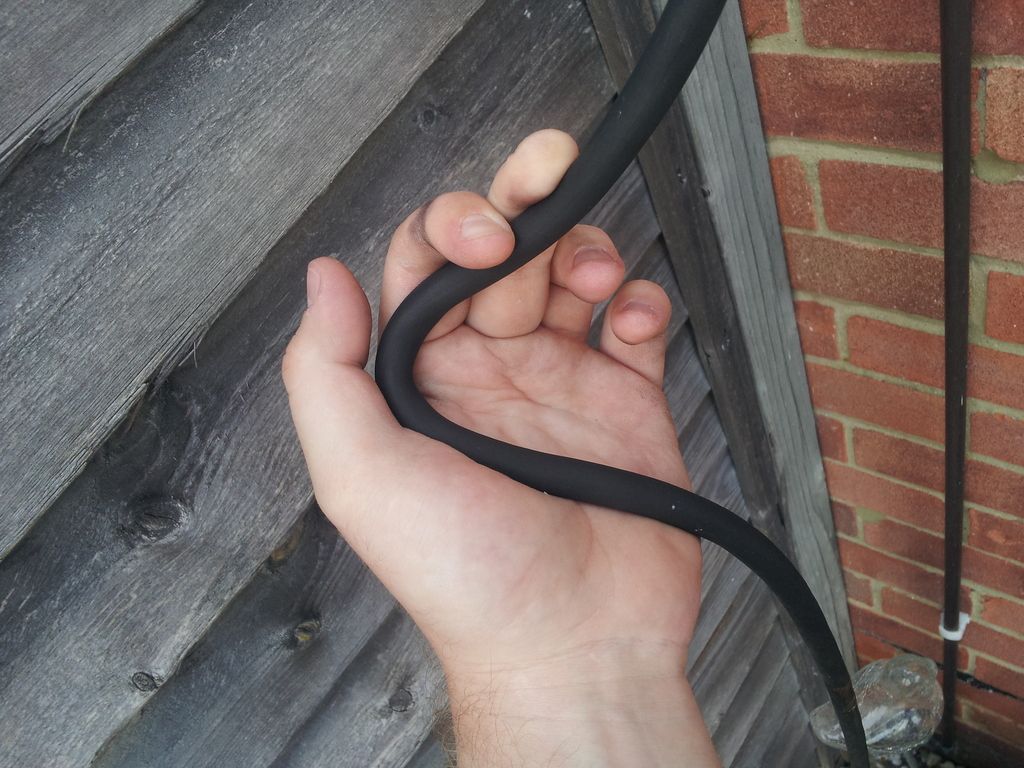

That doesn't look like armoured. Any markings on the cable? I think you need to be thinking about redoing it with the correct cable and at the right depth.
Or confiscate your wife's spade. She can dig over my garden if she's desparate !

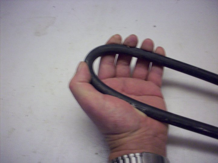

I also agree that it doesn't look too much like armoured cable, but it's impossible to be sure from the pics. The degree of 'bendability' does not prove anything very much - this is 3-core 2.5mm² SWA (sorry about focus, or lack of it!)....
As has been said, seeing what happens at the ends of the cable is the best way of being sure (plus the fact that SWA usually has raised lettering on the outside).

Edit - where did my photo go? It won't let me re-insert it. I'll try again later!
The sheath looks more like rubber to me than pvc.
Looks it's taking a lot of force to bend that SWA into that U shape!

It does to me, too - but, as I said, it's impossible to be sure.
It may look that way, but it really didn't involve any appreciable force! Mind you, it's again impossible to tell from a photo - that bit of SWA now has a semi-permanent 'U-bend' in it - so I could now take another photo appearing to show me 'bending' it to that shape with my fingertips (maybe even 'through an egg'!!)!!

There is no permanent deformation in my cable. It went back to hanging vertically and you wouldn't tell which bit I bent.
As such, pretty sure it is not armoured.
Outside did feel more like rubber than pvc, left black marks on my hand. No lettering that I can see.
Will check the end of the cable when I get chance.

There is no permanent deformation in my cable. It went back to hanging vertically and you wouldn't tell which bit I bent. .... Outside did feel more like rubber than pvc, left black marks on my hand. No lettering that I can see.
I agree that those facts, taken together, suggest that it's extremely unlikely that it's armoured cable (SWA).
