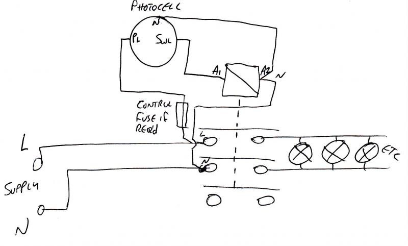

CONTACTOR/PHOTOCELL HELP!
ah nice 1 mate!! so i take the feed comes in to the contactor itself then take a live feed to the the PIR then the switched live from the PIR goes to the A1 which i take it pulls in the contactor?? and the neutral goes to A2 to power the contactor and when the contactors pulls in it supplys the lights is this right??
Yep, sums it up OK. That is just one way of wiring it, you can of course use a totally separate supply altogether for the control wiring.
