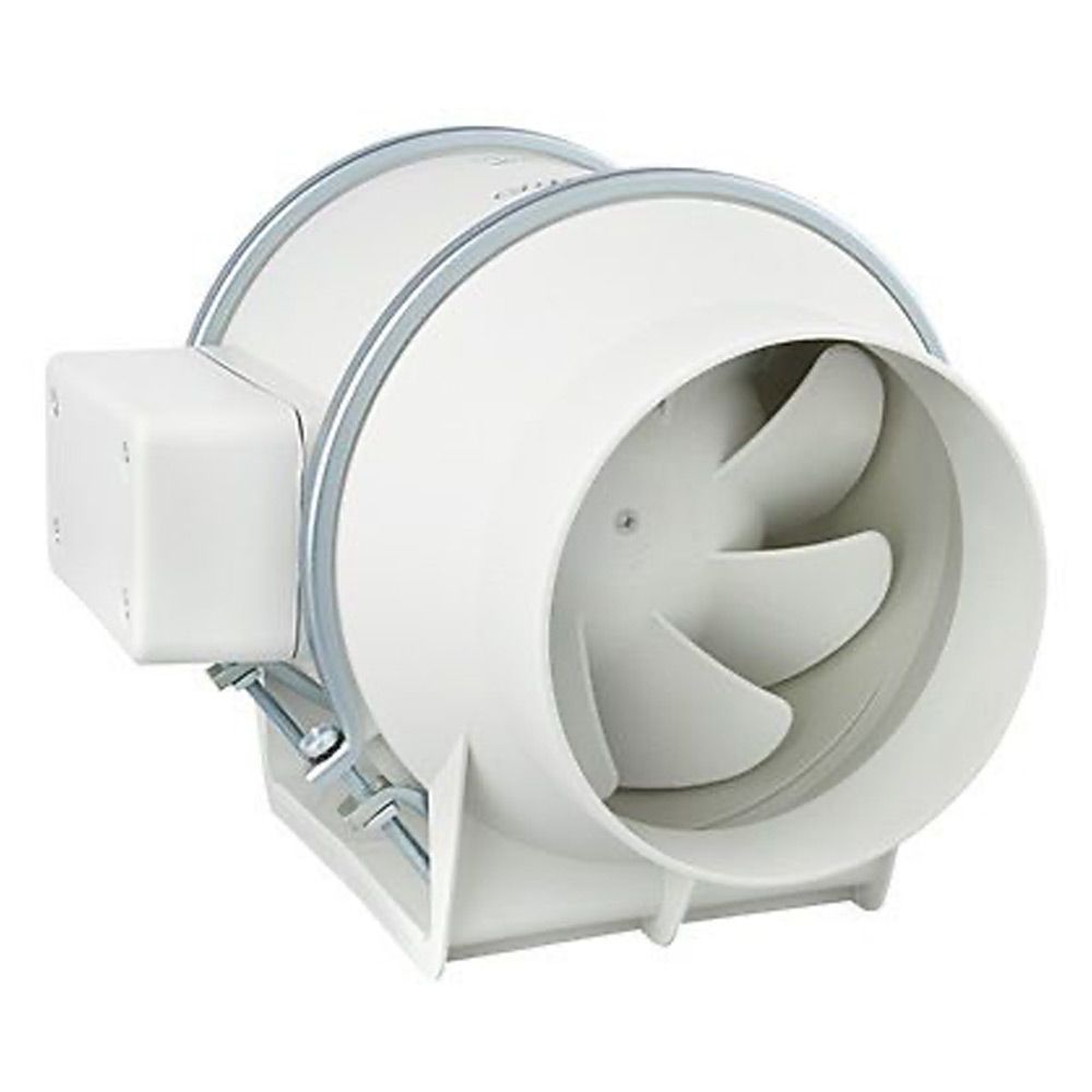

Thanks. I've thought about a PiV and the two main problems seem to to be:
It seems to be mostly a matter of luck where the air gets vented to and
Since it pushes air in from the loft, which is cold in winter, you are left with either a cold landing or get one that uses an electric heater to warm the air (about 200W) which is expensive to run.
So I thought using negative air pressure from the inline extractor fan that needs to replacing anyway would create a pull of warmer air through the bathroom and achieve the same effect.
Despite much searching I can't find an ithevwsll.nline fan with trickle. There are plenty of the ones designed to fit through the wall type where the fan unit is actually on the wall.

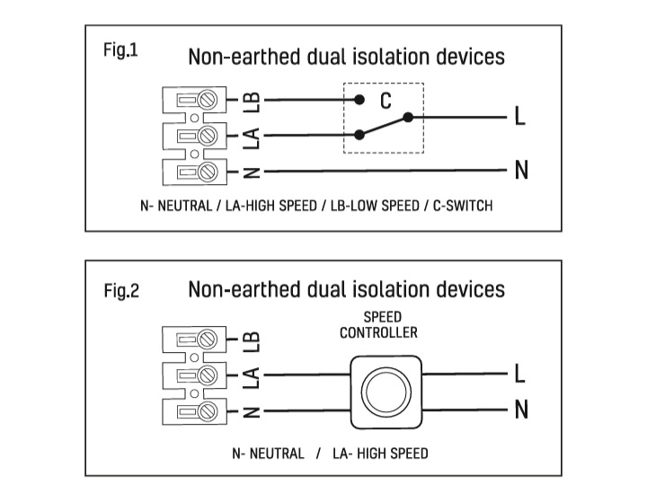

The Envirovent MV160 line appear to have 2 speeds including continuous running...
Although wiring up the fan won't be as simple as taking a single switched live from the light switch...

  • 1125919_03_SILMV250100T_InstructionManual_dbc6cd1c56c72914cb1fec456968fb1f.pdf

Agreed. Continuous extraction is what I'm trying for but one that will boost the speed when the light is on and a timed delay so it runs in boost mode for 15 mins afterwards. The faulty inline extractor is already a unit with timer so the wiring should be the same (permanent live, permanent neutral, and switched live).

I'd come across the Envirovent range but they said (as per your link) "intermittent OR continuous operation" which makes me think they can do either mode but not both. The other link (dmev) isn't inline as the fan unit would be installed in a wall usually. Thank you for taking the time to do a search but I seem unable to find an inline extractor fan that runs at low extraction rate when "off" but at high speed when the light is on and preferably with a timed function.

I did ring Envirovent and the closest they sell to what I want is the MEV 160. It can switch to high speed when the light is on and switches back to slow speed when the light is off. It has a built in humidistat so the slow speed actually varies from low to high depending on the humidity.
It is 5" not 4" but you can get adapters. It is also about £425 which is more than I was hoping to pay but I'm thinking about it. It wasn't described as quiet or silent so I'm a little concerned it might be noisy when at high speed and the tenant might be tempted to turn it off.
