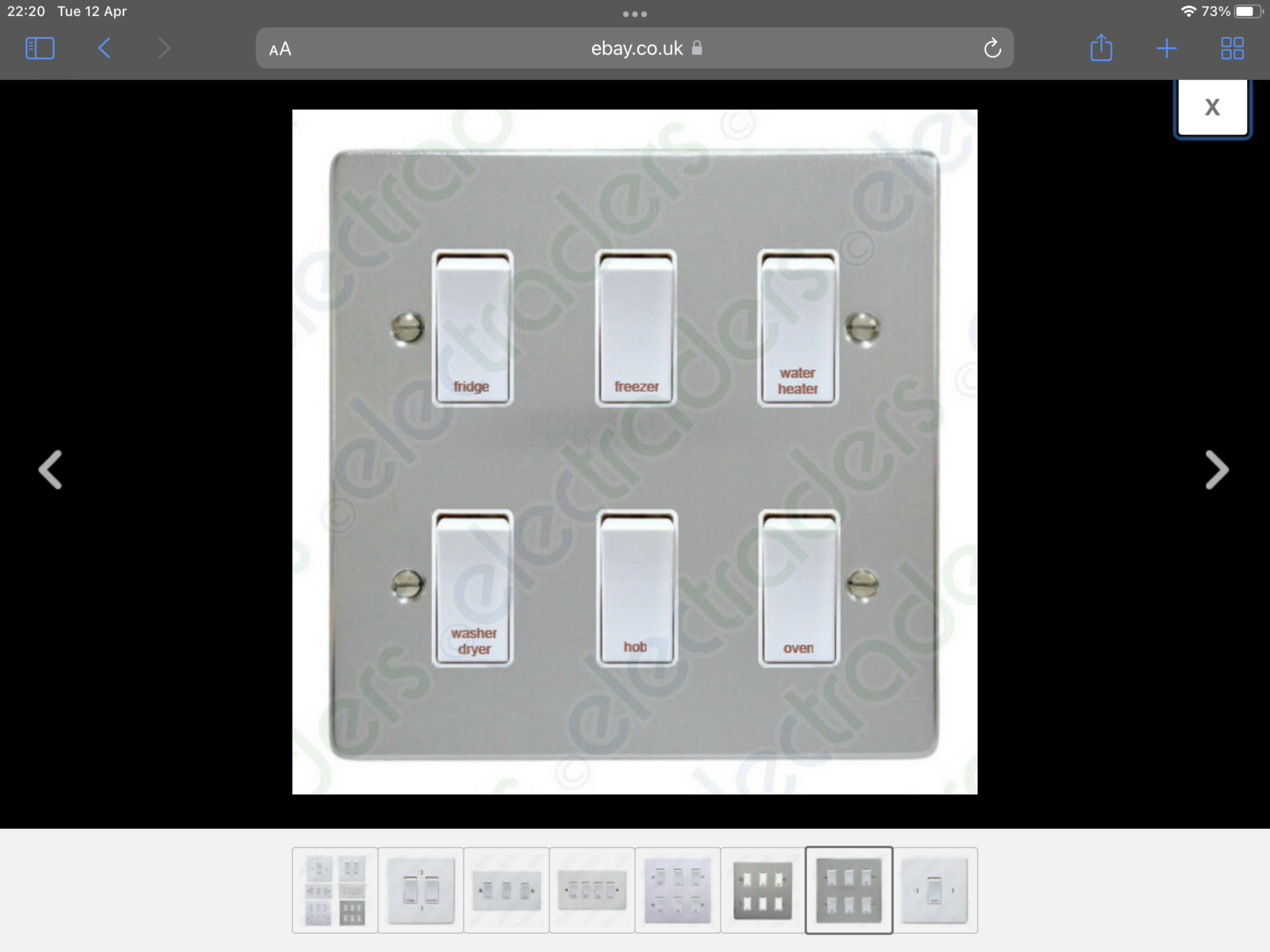

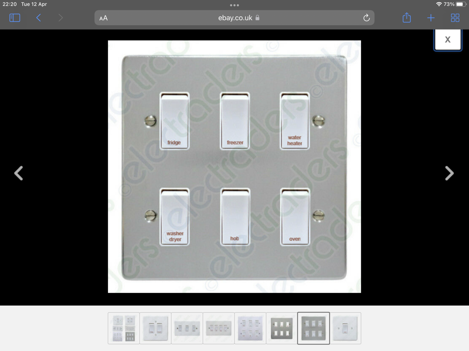

In the main we use conductors in parallel rather than a true ring final for a kitchen for dedicated equipment supplies, the only reason for two x 2.5 mm is can't get two x 4 mm into the switch, so although theory all switches feed with 4 mm is OK in practical terms we feed with two x 2.5 mm to the grid switch bank and then from central grid switch to each socket, and would use unswitched sockets.
However this is at design stage, not really after the first fix, in the days before washing machines auto turned off if not balanced it was considered prudent to have a switch remote from washing machine to turn it off, and with fridges and freezers some way to turn off for de-frost. Today the fridge/freezer normally has built in on/off switch.

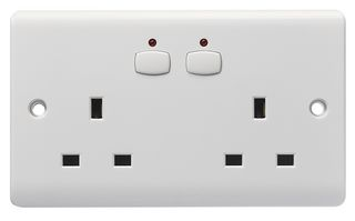

Do the need for remote switching has reduced, so some miss out the standard grid switch. I know you can get sockets like this
Energenie MIHO007 which can be remotely controlled, but default state is off, so any power cut even for 5 seconds could mean power stays off, not a good idea for fridge or freezer.
So in real terms now too late, the position of grid switch would be decided at planning stage, not after first fix.
If the job truly is at first fix (bare walls) then you do have options- either the grid switch distribution as above or FCUs (make sure they're double pole switched) above worktop height (or accessible behind an adjacent unit). Either way you'll be redoing a fair amount of work and you need to keep an eye on safe zones for the cabling.
Tying to get my head around this as I find it interesting.
Are these working a bit like FCU's where there is power supply coming into the FCU and then out to the next point and the "load" cable is effectively powering the individual unswitched socket?
Yes that's the plan.
