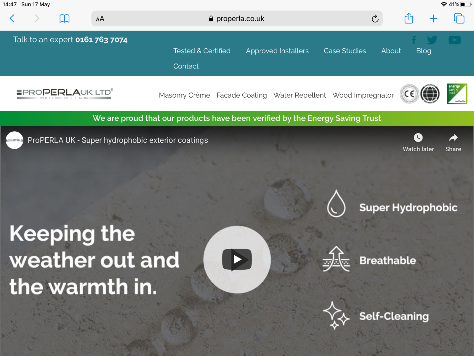

Hi Gste, one way to get the boys on here to debate long and hard is to mention, damp, mould and ventilation. I see your in Lancashire you might want to speak to these people see attached. Hope this helps.
