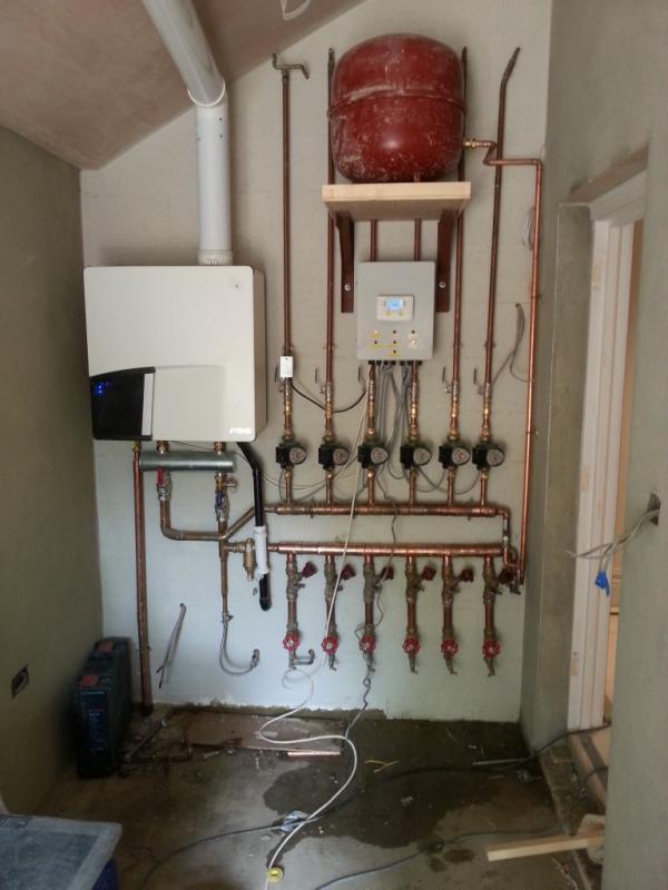

Here is a Q60s we fitted and commissioned last week:

There is a 330 litre unvented cylinder in the basement. If you think a house that needs 60kw of heating is going to be satisfied with a combination boiler then you truly are an idiot.
Oh wait. ..you don't know the difference between a pump and a zone valve :LOL:
There is only 1 zone valve there and only to satisfy the local building inspector.
So tell us wet fingered plumbers how a house that only needs say a maximum of 12kw of heat for 3 or 4 weeks a year is best served by a monster boiler that can only go down to 9.8kw?
