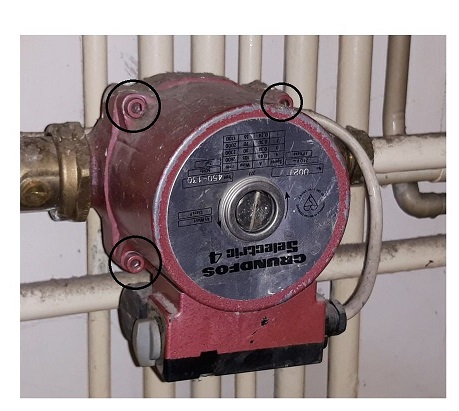

No, it's not a question of being upside down, the control box should not be at the bottom (though it clearly hasn't given a problem). The pump body has to be the right way round for the flow direction, but it could easily have been fitted correctly - remove the Allen bolts and rotate to any of the other 3 positions. It could still be put right, just need to close the valves first.

Hence why the diagram shows the terminal box shouldn't be below the pump. Very lazy of the installer to put it in like that, at the time of installation it would have taken a couple of minutes to remove the 4 allen head screws and rotate the pump head 180 degrees.
As @fixitflav said, to do that now you would need to isolate the pump using the valves at each side of it, so probably a 5 to 10 minute job. (this is a DIY forum :)) Unless, the valves don't close off fully in which case the system would need to be part drained, so take a little longer.
