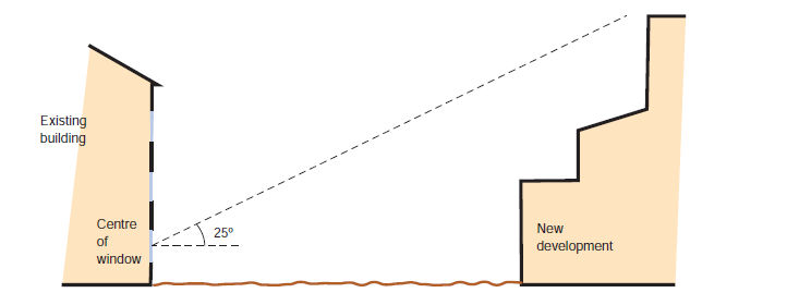

Measuring from the centre of their habitable room window, can you keep your development under a 25 degree line? this guidance comes from the Building Research Establishment doc "Site layout planning for daylight and sunlight". If you can, I think you should read this doc and reference it in a planning application.
Yes, the application property is all under 25 degree line. Does the 45 degree guidance affect only adjacent properties or does it also apply to properties at right angles to each other? This is something else that I couldn't find an answer to when googled. Your response is very much appreciated, thank you very much!

sorry I wasn't clear. What I meant was, in planning terms, there is no right to light, as I understand it, but there is a legal right. Whereas the 'daylight and sunlight guidance' is a planning term according to BRE, that planning officers use. Please put me right if I am mistaken. I just found this if anyone else is interested in this complicated subject ...... https://awh.co.uk/2019/11/11/rights-of-light-vs-sunlight-and-daylight-whats-the-difference/
Yeah, I mentioned all that above.
For planning, you need to refer to your council's planning policies regarding what criteria they use how they apply it.
