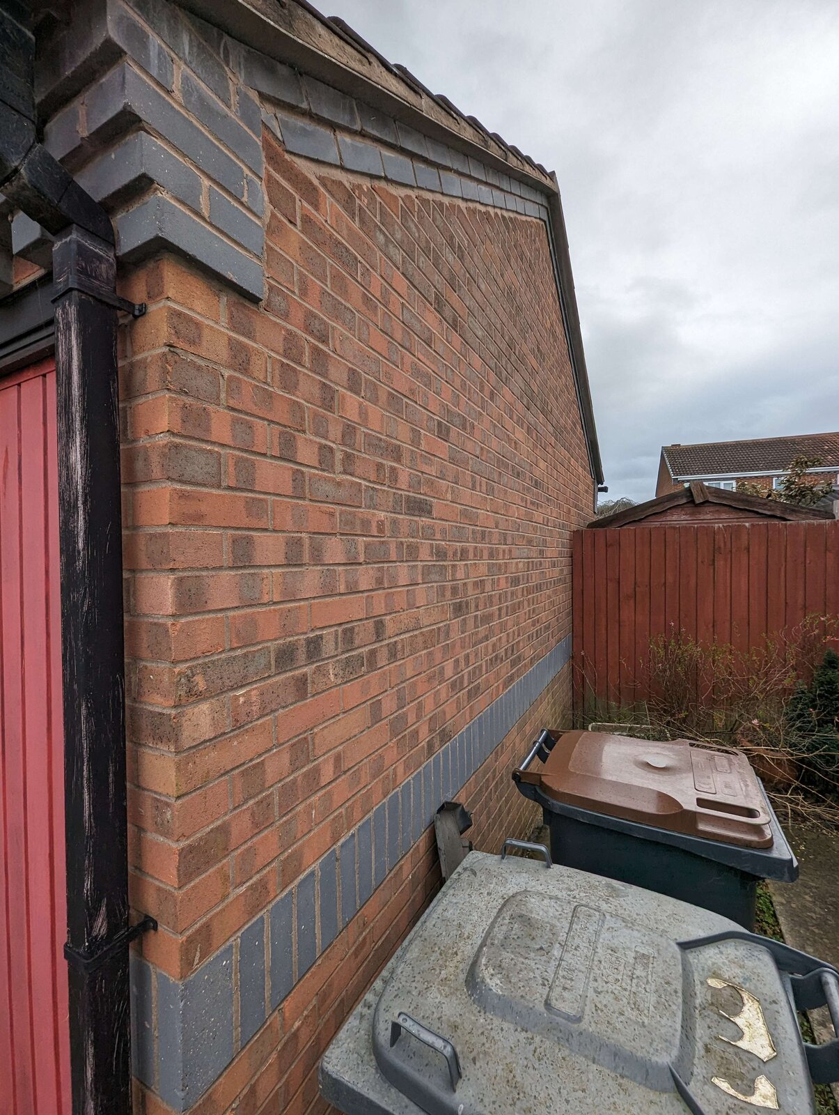

No, I'm thinking this could be solid brick instead of single skin, although I cannot confirm.
Single skin is solid brick, do you mean a double thickness wall?
Double thickness is highly unlikely for a single garage
If you have a picture of the garage, you can tell by the brick bond

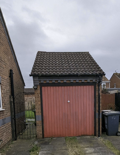

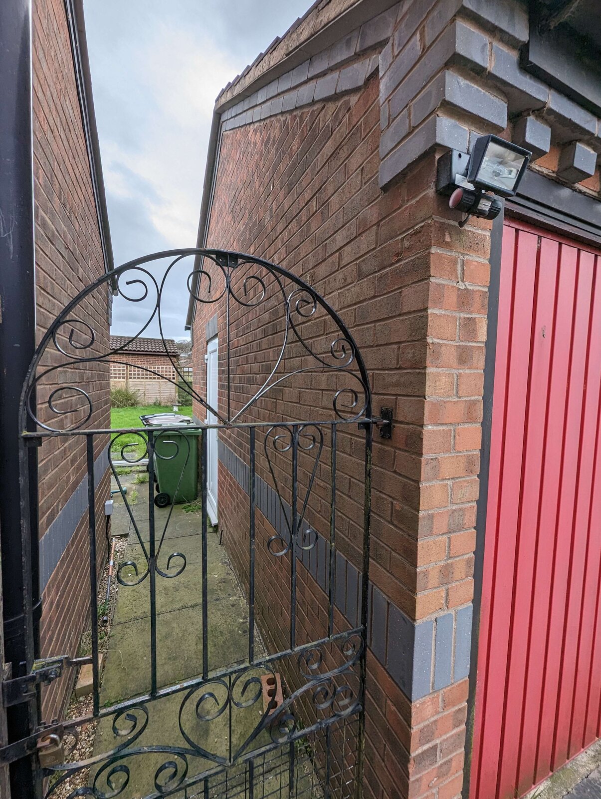

Yes I'm thinking double thickness I believe, I'm going to drive pass and take a few photos and measure external width
Just drove past, externally the width is 2.72m, internally 2.5m. I believe this is indeed single skin brick?
How should I be doing the roof? Cold roof or warm roof? I'm more inclined to do a cold roof, tho I'm not 100% sure if this is the best idea? I'd also like to install a loft hatch for storage
Well the roof is already there. No point in redoing it.
But you'd need to do a plasterboard ceiling tied in with your plasterboard walls to keep noise in.
That door though, is your weak spot.

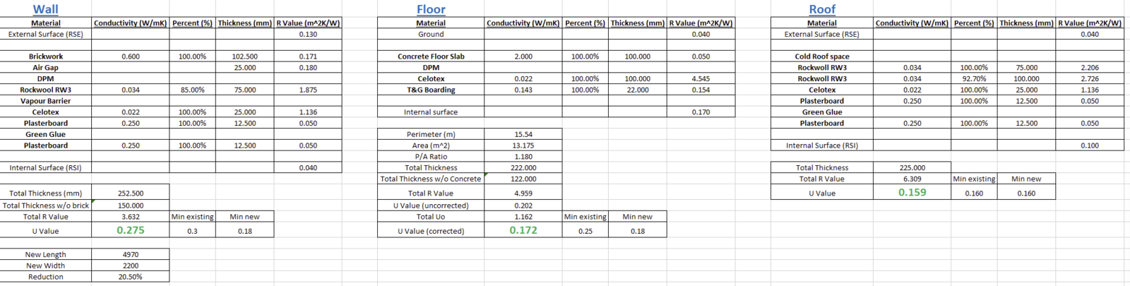

I'm trying to understand these u values stuff, all the online calculators I've seen I can't seem to get on with.

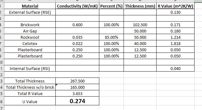

Does this look correct? I'm not including stud works, DPM, vapour etc in this
I'm hoping this would satisfy building regs. 50mm of rockwool in the studs + 52.5mm insulated plasterboard (40+12.5mm) + another layer of plasterboard

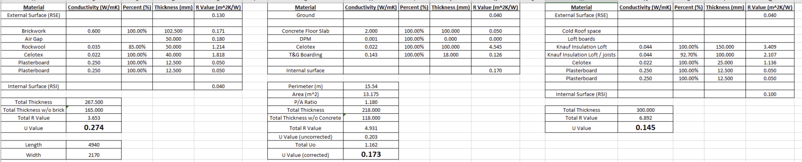

Here's my U values for wall/floor/ceiling.
I'm hoping that as my ceiling and floor is better than minium required I can offset the amount I require on the walls, will have to speak to local auth.
My plan for the floor is floating floor, DPM + 100m celotex on top with some T&G boarding. The plan for the roof is 100mm loft roll between the ceiling jousts and 150mm on top of that on right angle. With some celotex backed plasterboard + another layer of plasterboard.
Does this sound all right?

So I think I finally have a plan for insulating my walls, ceiling and floor. Had to make my own U Value calculator as all these online ones suck.
I plan on using 75mm of RW3 rockwool in the walls and ceiling, with insulated plasterboard to prevent any cold bridging + Green Glue + Another layer of plasterboard. Hopefully an u value of 0.275 will be enough for building control. From their documentation, it should be.
Floor is a floating floor with 100mm of PIR + 22mm T&G Boarding.
The ceiling is just 100mm of RW3 rockwool in-between the joists, with 75mm on top of the joists going the other way. With celotex plasterboard + green glue + plasterboard same as the walls.
