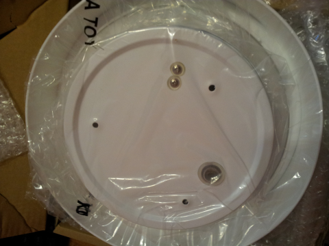

Second failure of a light with no space at the back. This is the screwfix unit. I will be able to return this one.

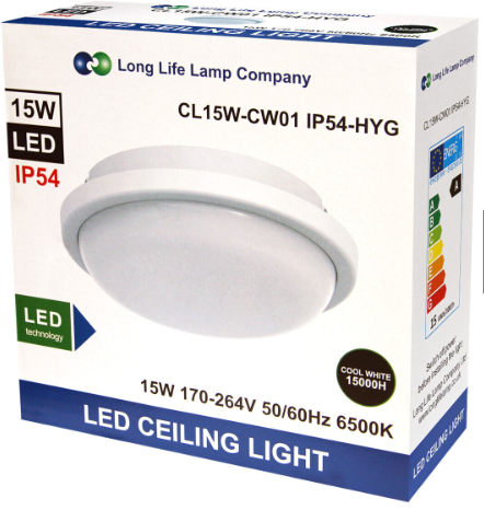

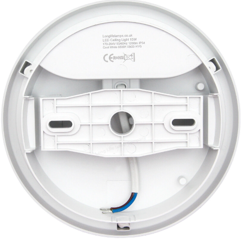

While looking around for interior pictures of the kosnic unit , I found this alternative which might work. It looks to have space inside for terminal blocks. The wattage and light colour are switchable also. It's £20 from ebay or direct.
This looks like the easiest to install. £14 for 20W. Light colour limited to cool white.
I settled on the ledbrite for its central cable entry point, and changeable light colour and brightness.
