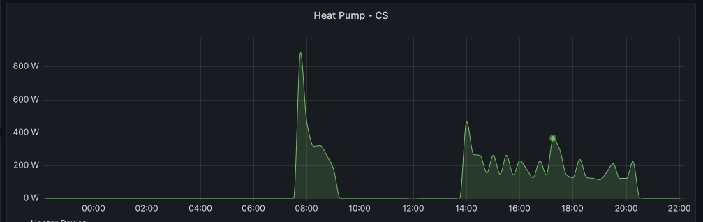

The part I really cannot wrap my head around is the unit in the annex. I cannot off-hand find the measurements for it but every online calc said he needed a 4.2KW unit. I bought a 5KW job. It does the job bloody well and only ticks over and sips juice.
Today I even had the door and window open for fresh air and the heater running :)
Yes, today was an idea day for COP so slightly skewed.
This thing, once settled, is sipping around 0.2KWh.
I'm really not understanding where your power demand is coming from. 20KWh every hour?
Of course sipping 0.2kw looks impressive, you really have to know the HP output, not easy with a air/ air unit.
