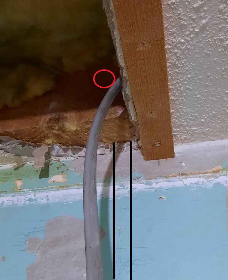

Push the cable up to the joist and you'll see it's higher than the face of your batten.
I plan to put a bit of plasterboard back up to cover the holes, I'll need to notch a bit out to allow for the cable to pass through, what you think?

Yep, youll probably even have space to secure it to the underside of the joist with a clip to keep it tight and out of the way, or all round band if youre putting oval in your chase.

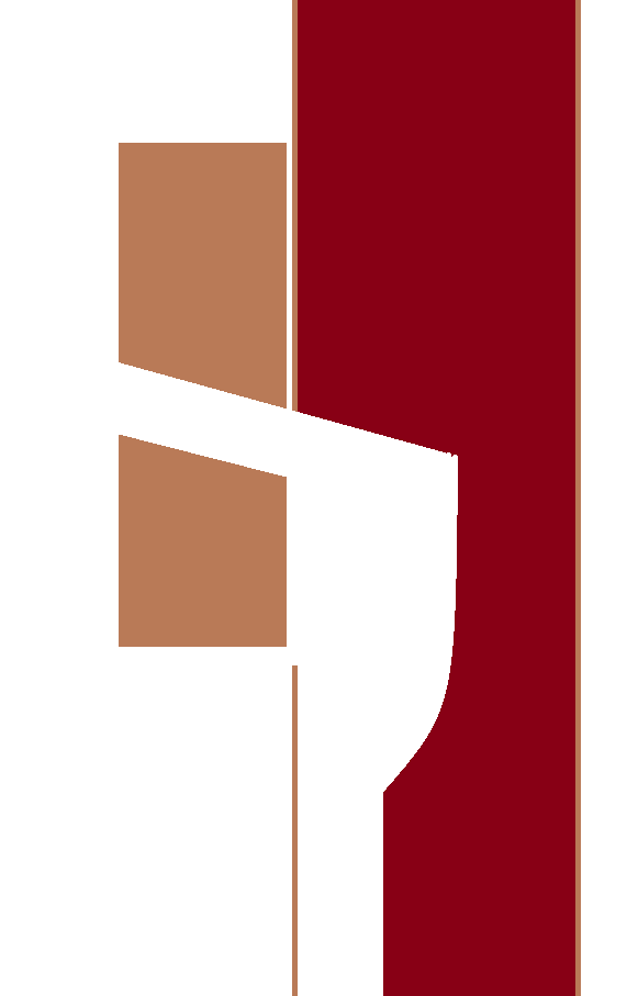

As I understand this: Drill through the joist (red circle) as steep as possible downwards, Make your chase (black lines) and drill/chisel out behind the joistView attachment 376483View attachment 376484.
However as you have the new battens giving the extra space between the joist and new cladding View attachment 376486
both methods have their own merits
Chased the top of the wall out directly under the joist for about 150mm. As you suggested the cable should run as you predicted.

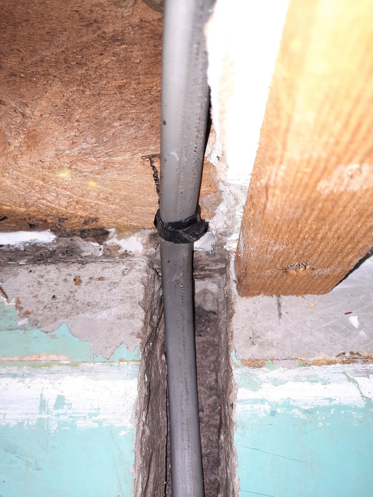

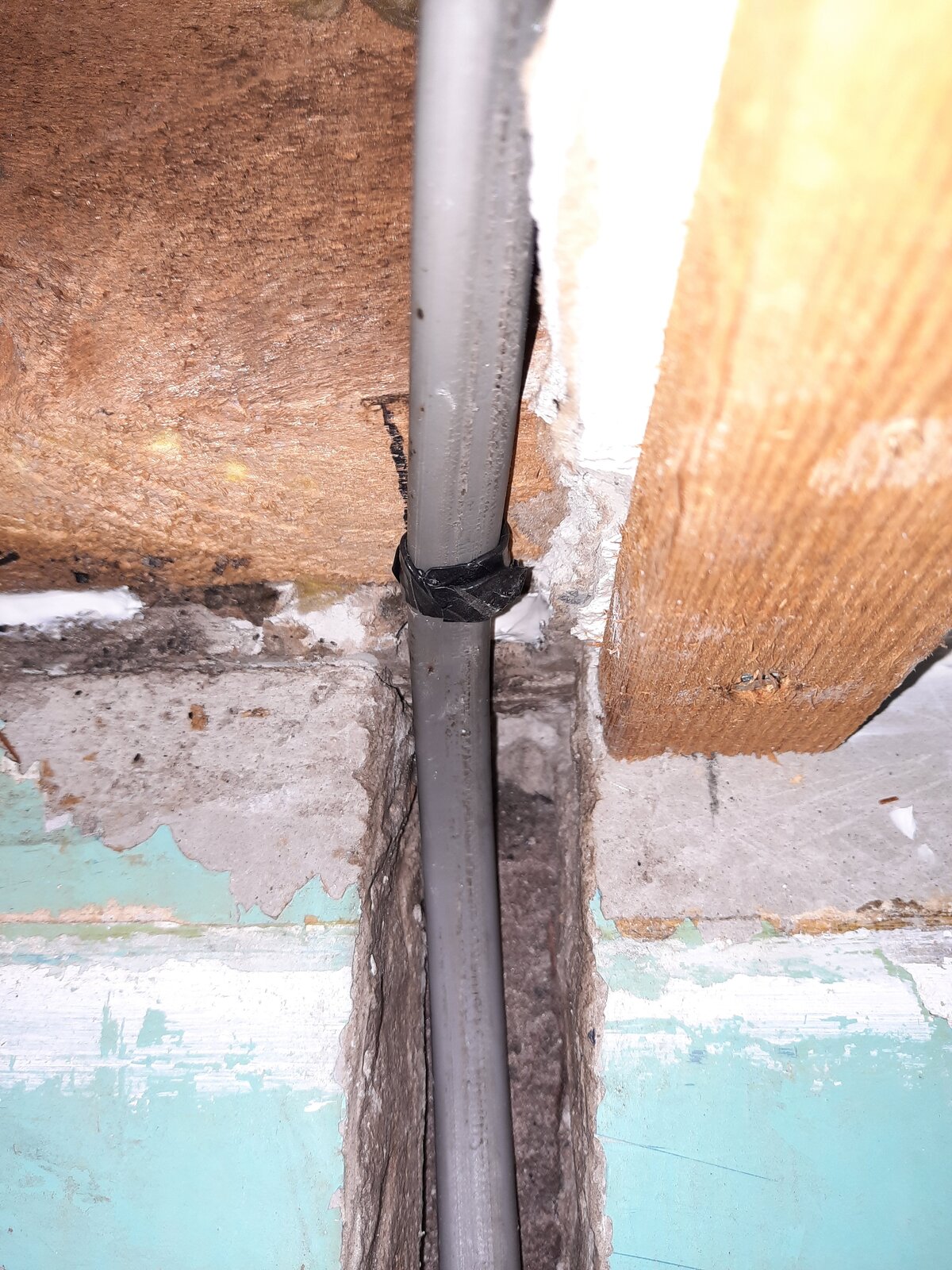

Hi there, is this the solution you suggested? I've used all round band wrapped in insulation tape to protect the cable, many thanks for your help.
Looks good to me and seems to be plenty of clearance when the ceiling cladding goes in.
