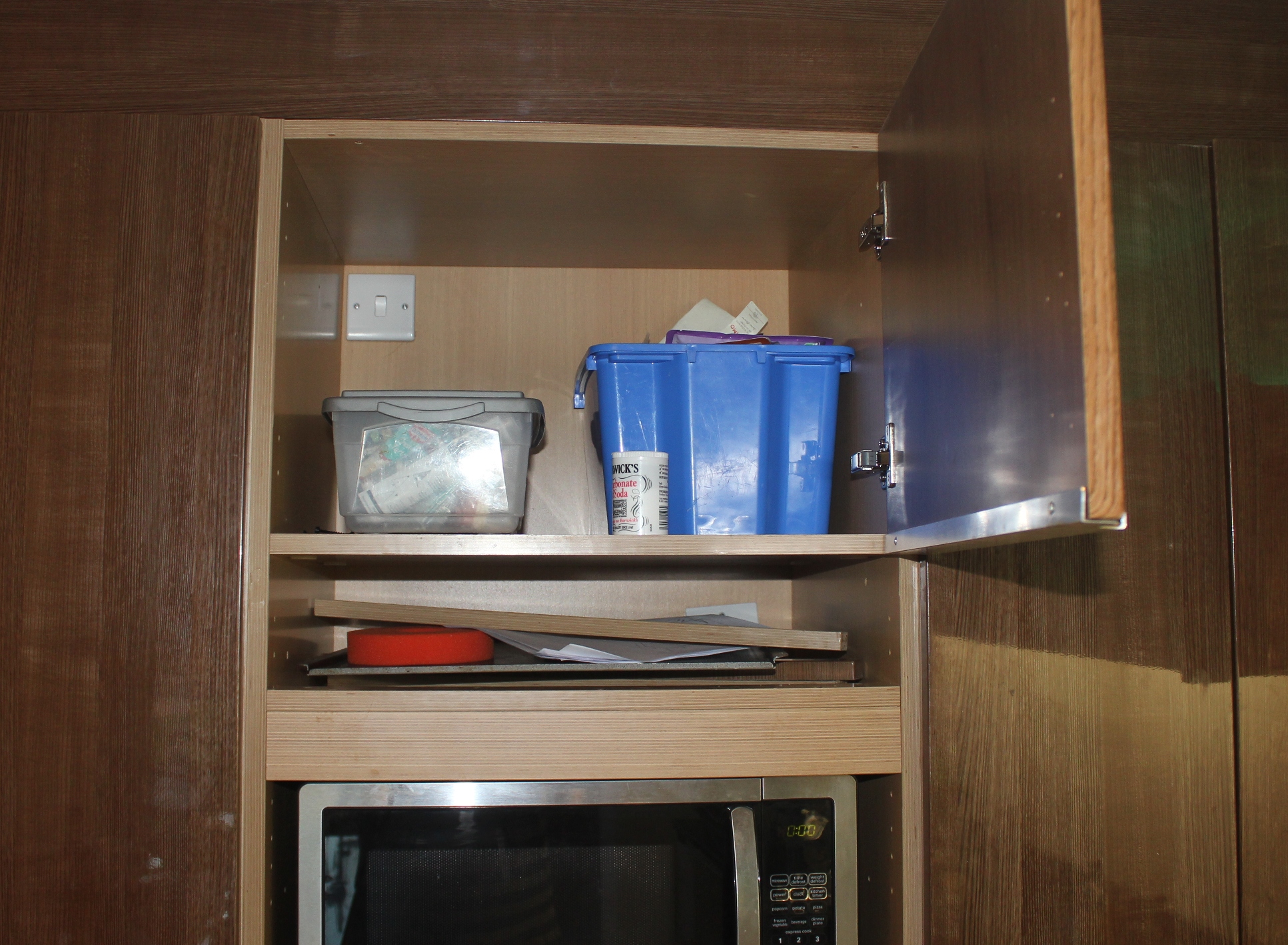

New isolator ready for when Combi Oven Microwave arrives tomorrow. Know the new isolator is not in the best position and that a disabled person would not be able to access it and that you have to reach above the new oven to isolate it, but at least it is not hidden behind a large draw.
R1+R2=0.49Ω, 500V IR (L-N,N-E,E-L) all >=200MΩ, polarity √, 25M run of 2.5mm² T&E from DB to Appliance (2.6% VD); so all good there.
New Isolator, Top left of top cupboard:

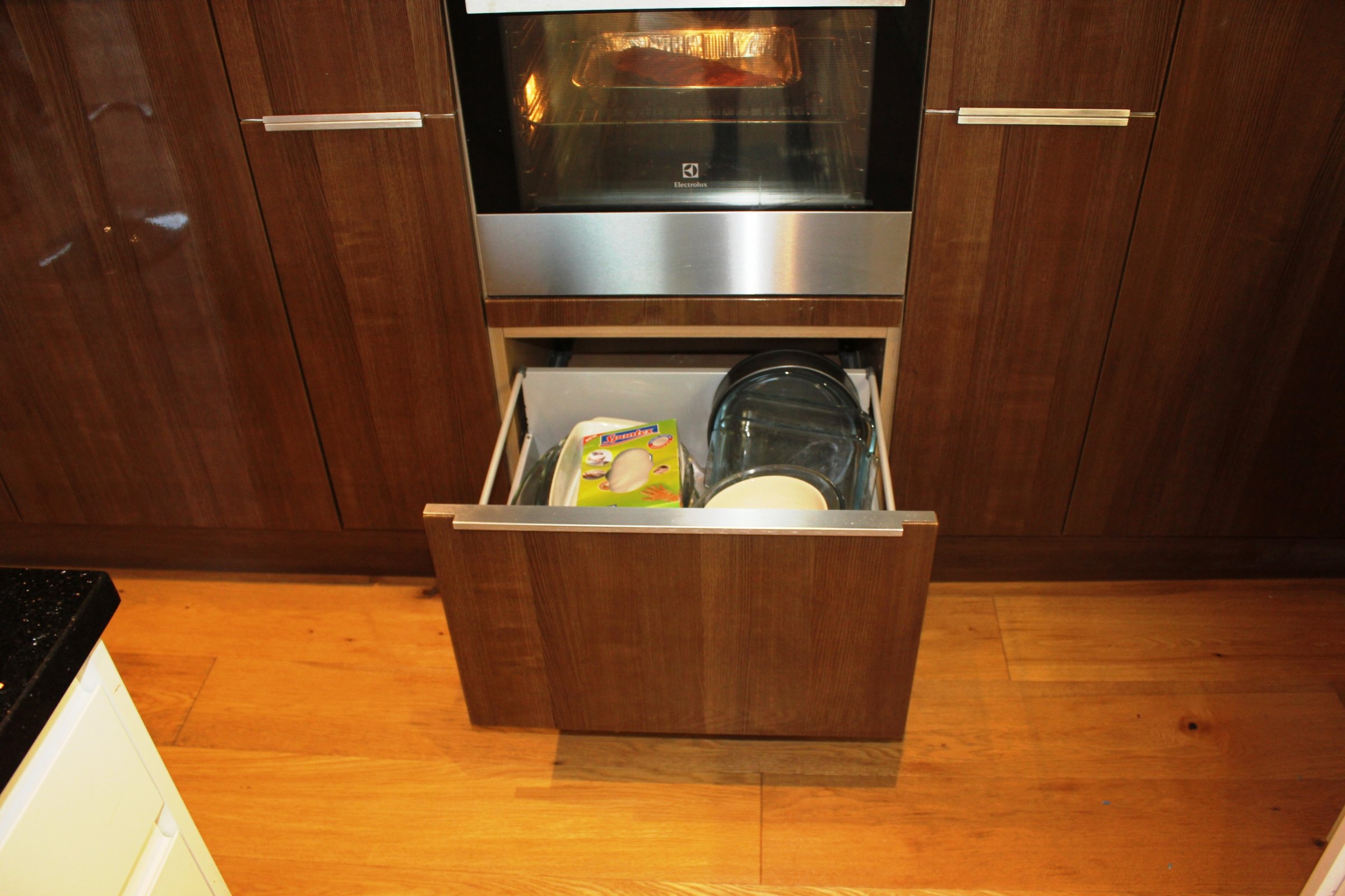

Existing Isolator behind draw:
(n) Just realised that you should not place isolators above cookers/ovens in accordance with the OSG. Looks like I am in breach of reg 537.4.1.4 & 537.4.2.5
The isolator for the main bottom oven in behind a draw and awkward to get to, but that was not my doing.
