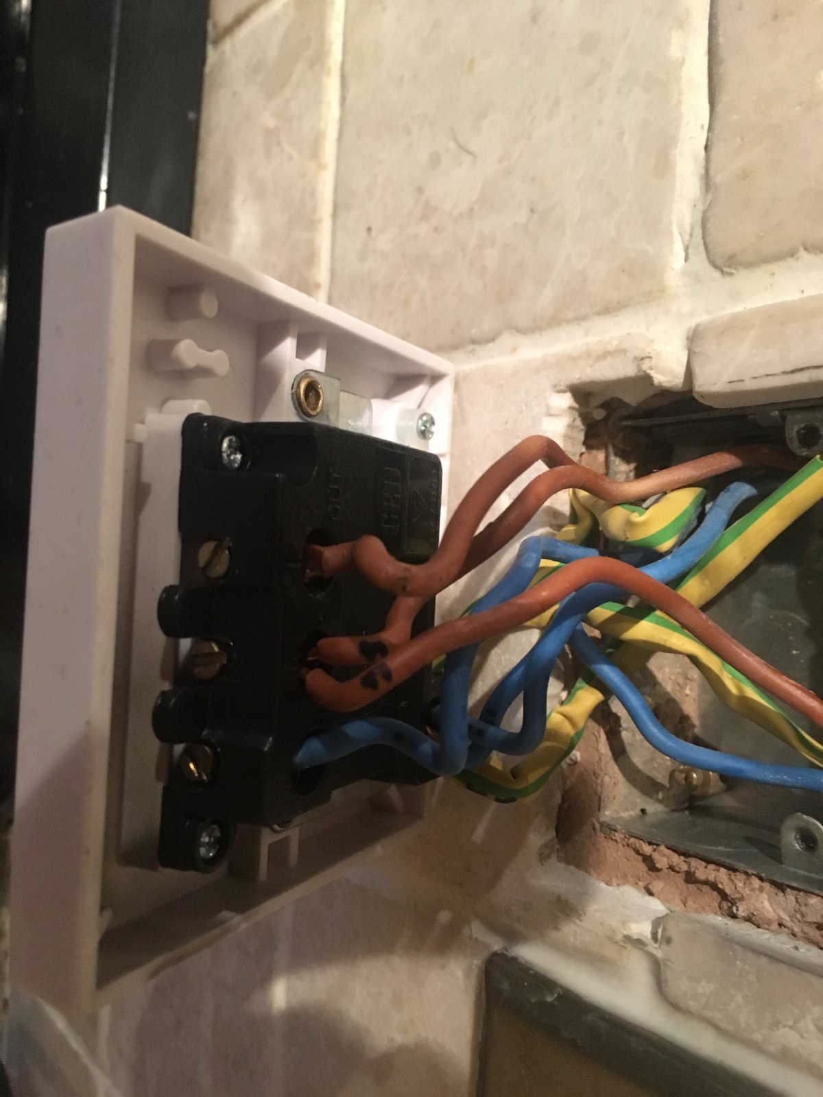

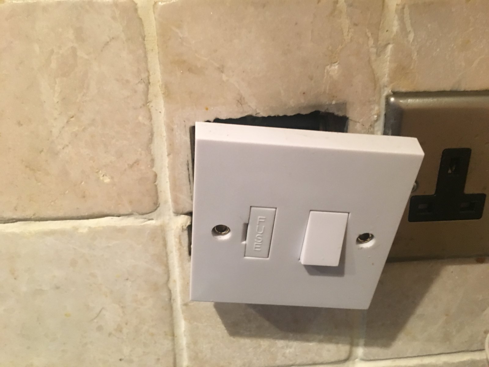

It looks like my cooker is connected via a fused switch where a double socket at either end is attached.
I'd previously had a 13a switch which kept blowing (clearly!) so what do I replace it with?
Is there any reason I can't put in a 45a cooker switch in?

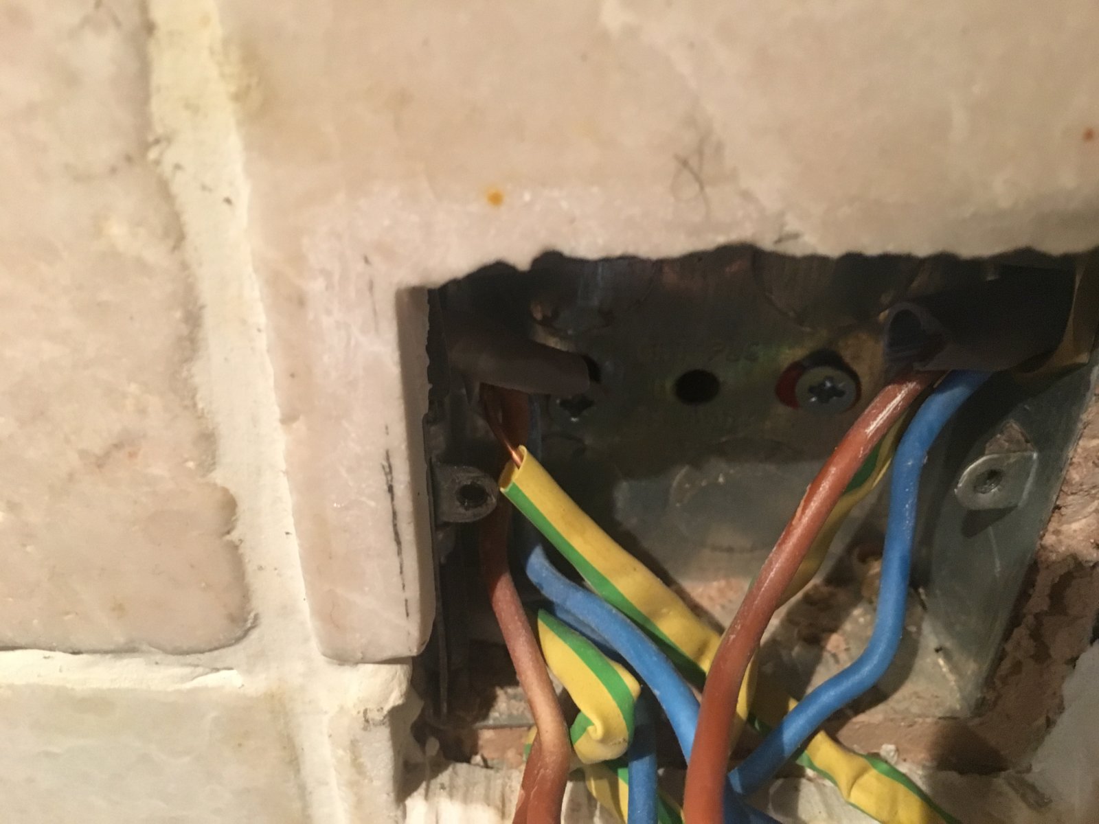

Also, does this section of earth need taping up?
I connected a new white socket, which worked, but when I screwed it down and turned on the electrics it blew the socket. The cables are really hard to push back in - what's the solution?

It looks like the FCU is on the socket circuit so no, you can't swap it for a 45A switch.
The earth wire needs connecting to the back box terminal in the bottom right corner.

Cookers cannot be connected to the socket circuit. Do you have a cooker circuit marked on the consumer unit.

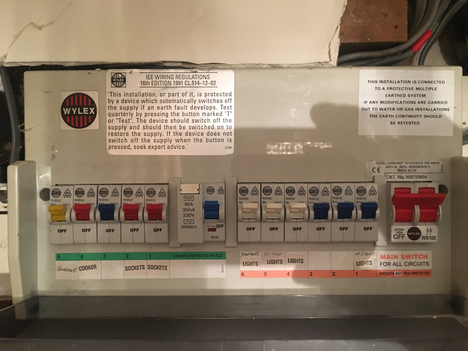

How old is your consumer unit? Show us a pic

There might be a proper cooker circuit behind the oven. Do you have a label stating cooker on your consumer unit - 30A or 32A. Picture?
aha, so it says you have a cooker circuit. Turn off that breaker and see what stops working.

I don't think it's there anymore. Nothing happens when I turn it off. Whilst we were remodelling the kitchen the first electrician we had tore out a load of cable where the cooker used to be and I went mental with him as I still wanted power to that side of the kitchen. After I booted him off the job the next electrician I think was just making the best of a bad job.
