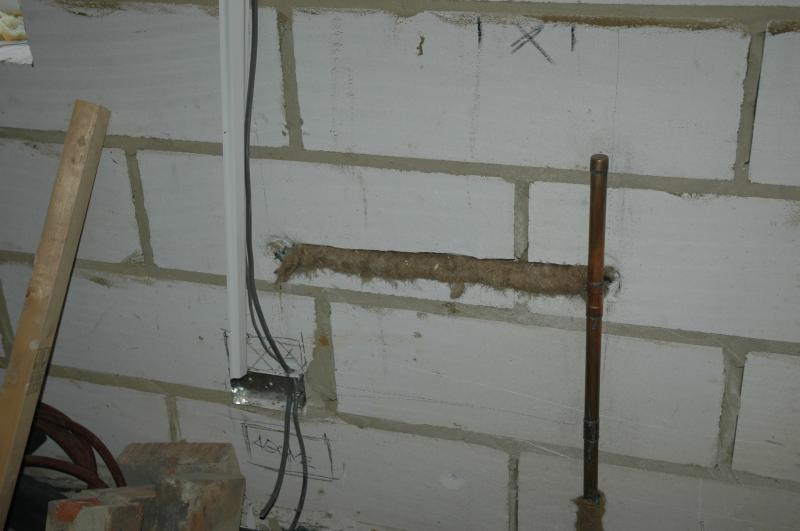

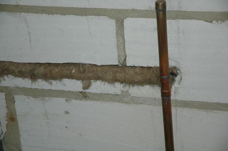

dont know whether these help or not....
To be fair as long as the pipework is sleeved through wall that looks o.k apart from the fact that it reduces to 15mm pipework almost immediately. :eek:Is this the main run to all gas appliances or does it branch off other side first in 22mm? Or is that 22mm? need me glasses. :LOL:
its 22mm and the down pipe feeds a gas cooker only.... the vertical cap will feed the boiler in the loft.....
why is it in the wall anyway? did you ask for it to be like that?
