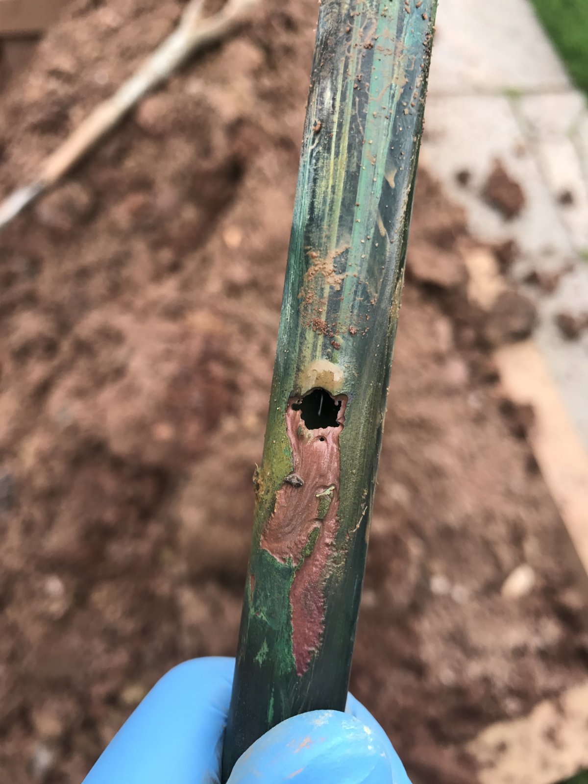

This was plastic coated copper that rotted:
That coating is not Denso-Tape
And it appears from the scour marks it has been leaking for a considerable time?
Yes, it would originally have been a pinhole that expanded to that. Luckily this was outside and easy to find and fix.
