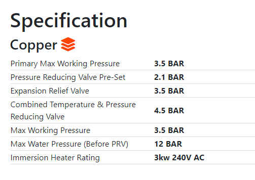

you can get copper unvented cylinders , maybe thats what was already there , they are slightly less pressure than SS is all
Slightly!
Stainless Steel​
Pressure Reducing Valve - Max Inlet12 BAR
Operating Pressure3 BAR
Expansion Vessel Charge Pressure3 BAR
Expansion Relief Valve Setting6 BAR
Pressure & Temperature Relief Valve - Pressure Setting7 BAR
Pressure & Temperature Relief Valve - Temperature Setting90°C
Energry Cut-out Thermostat Setting80°C
Primary Heat Exchanger - Max Working Pressure6 BAR
Solar Heat Exchanger - Max Working Pressure6 BAR
Immersion Heater Rating3Kw - 240V AC
You're right but given there was a capped vent pipe, no indication of a control group with a reducing and release valve (just a reducing valve), nor any other kinda controls kinda points towards it being a standard cylinder unless the OP can confirm whether there was any other indications that there was an correctly installed unvented cylinder - D2 relief pipework/tundish, a control valve group, EV, etc?
Nah. It was a copper tank bypassed to make unvented without safety controls.
