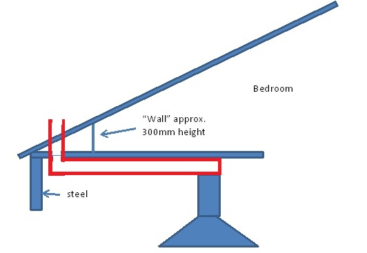

This on it's side only would only need a 90mm notch out of the side of the pier.

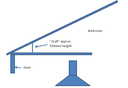

Yes, that was suggested earlier in trhe thread and looks the way to go. The only thing is it means I have to core drill 4 x 91mm holes and I hate core drilling! I have diamond drills but that is still probably 45 mins per hole and a lot of aching arm muscles!
Can you get on the roof, lift a few tiles and membrane to establish exactly where the steel end is, and look for options to go around it. If you have good access from above you might find it's safe to slice a diagonal corner off the top right of the steel without compromising it.
Possibly. The "simplest" route would be to go vertically up from next to the right side of the beam. I haven't measured it but I think that would come up through the roof tiles (rather than the floor of the room above which starts further to the right).
It would need a soil pipe roof kit, cowl, condensation drain etc and that is probably beyond my diy skills!
If this is a bungalow, isn't there an eaves void above that area where you can take the vent vertically?
The only way to access that area is to lift roof tiles and cut through the membrane and I'm not sure I want to do that (or can even access it easily now that the conservatory is "in the way").
If you can get to it, that would be the much simpler, practical and better looking option - up through the floor and out through a tile terminal.
Lifting tiles, cuting the membrane and sealing everything back up again is relatively easy.
Can't you see the eaves void from the room above?

That's where I would run it. Tile vent, or roof terminal and lead slate on the roof.
