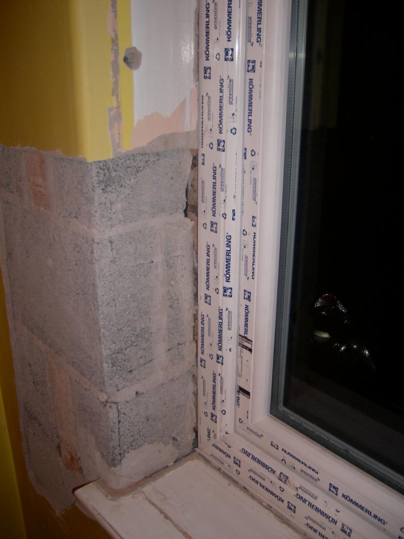

I'm struggling with choosing the correct corner beads :confused:
From the pic, I need to fill in the missing plaster (bonding after application of PVA/water mix) and then skim Wall and Reveal to leave a right angle corner. The existing corner is rounded (which from a previous post - a bead will give a better result due to the significant plaster damage).
The question I have, is which type of corner bead to use??
Some beads are for skim with just a thin coat, others for full plastering etc. I seem to have a bit of both here. :confused:
An appropriate Web link would be excellent and ideally for an easily available supplier! :)
Thanks!

What is your plan for the other sets of "bull- nosed" reveals in the room? If you square up the reveal/s in the photo, will you make the others all the same, (square) ? also, is the soffit edge, square/ish?
Roughcaster.
This room has only one window and the other reveal is in the same poor state as this, so was planning to make square also. The soffit edge on this window is square (due to the large concrete beam/lintel over the window). A square soffit edge is the same for all windows throughout the house.
For the reveals there seems to be a mixture throughout the house. The kitchen and dining room both have square edged reveals, but the other rooms are 'bull nosed'. Was planning on keeping them bull nosed if there's only minimal damage to the reveal - but square otherwise. There are wall corners through the house that are bull nosed also, so only wanted to change where absolutely necessary.
If it was me, I would use (thick plastering coat) an 8 ft length/s of Expamet (trade name) corner beading on your reveals,,,, readily available from most sheds and builders merchants..... Seeing as how a lot of the old plaster on the wall face/reveals on this particular window has already been removed back to the blockwork, I would remove the rest (identically),,, on both sides. "The soffit does "not" need to be touched"..... Ok,,,,method,,,,, you are now starting off with bare blockwork on both reveals, returning round onto the blockwork face of the wall some 200--300 mm or so... Cut your corner beading to length, with tin snips, for the left and right hand side window reveals.... Clean off the wall and give it a damp down, just on the reveal corners for now. Mix up some stiff but workable multi finish, and put on say 4 dabs of the stiff mix with your gauger on each reveal, one at the top/bottom,, two in between,(do one reveal at a time). Make sure when you put the plaster dabs on, they go onto the "corner edge" of the reveal, half on the wall face,, half round onto the reveal. Put on more than you need. Get your length of bead and then bed it, tapping gently, into the plaster dabs, but don't push on it too hard, or it will go in too far. Keep a plumb thickness/margin up the window reveals,, and make sure the bead is out to the thickness of the original plane of the wall surface. Once you have them alligned plumb both ways using the spirit level, tidy up the excess dabs carefully with the gauger, keeping the plaster below the flush and clear of the bead's spine,,, check the plumb once more,, and if they'e ok,, leave them to set,,,, don't fiddle with them. After preping as you said earlier (water/pva), you can now bonding coat the wall and reveals, using the bead as your guide...This would be by far the strongest way to do the job.... I think you would have a good idea what I'm on about Newbee99. ;)

If it was me, I would use (thick plastering coat) an 8 ft length/s of Expamet (trade name) corner beading on your reveals.............After preping as you said earlier (water/pva), you can now bonding coat the wall and reveals, using the bead as your guide...
Thanks Roughcaster, given me a much clearer picture what is necessary for these damaged reveals. The only remaing question I have is how to get the level right for the bonding? I'm guessing I need to keep the bonding below the height of the bead's spine by 2-3 mm. Then this will allow for multi-finish skim to be applied nicely flush (after the bonding is set - of course!). Any tips to get the bonding level right or is it nothing to worry about? I've only ever used skim beads with p/b previously. :oops:

Once you have the corner bead on, you would coat the wall out to the thickness you need, (bring it out in two coats of bonding). Then,,using a small straight edge,, work off of the existing edge of original plaster, and the spine of the bead, and screed the s/edge horizontaly up the wall to remove excess plaster,, filling in any hollows as you go,, repeat that until you are out to the flush, let it set up a bit, rub it over with the float and you're ready for the multi. For the inside of the reveal, make yourself a gauge,,, a piece of wood with a small nail ( a thin 30 mm panel pin type, or similar,,, very small head),, half in the wood, half sticking out. Put your bonding coat onto the reveal, then run the gauge up the reveal, using the beading,,, and the "small gauge nail" on your "window frame" (carefully) as a guide, to give you a 90 deg angle...... I bring the bonding coat more or less out to flush, then when it's nearly set,, scrape it back slightly if I need to,,,, more at the edges, or where it meets the bead. It feathers in no problem at all, to give a neat flush finish...... Sounds like you might need someone on hand to help you along the way, but give it a go on one side of the window at least, and see how you get on..... We'll be hearing from you. ;)

You can make a simple "reveal" gauge out of say, a small piece of 9mm/12mm wood/ply, or similar,,,,, size,,6"x 2" ish,, depending on the size needed for the width of the reveal,,, just tap the "thin, small-headed pin/nail" into the end of the "ply",,, where it suits the inside edge of the window frame you'll work/guide it from,,,,, to get the reveal bonding plaster square.....Running the window-gauge/nail up the window frame is the only thing you need to be careful with...... Wrap a little bit of insulation tape around the nail though, and it'll cushion and protect the pvc frame,,,,, then Bob's your uncle,,, go on,,,,,,give it a go. ;)
