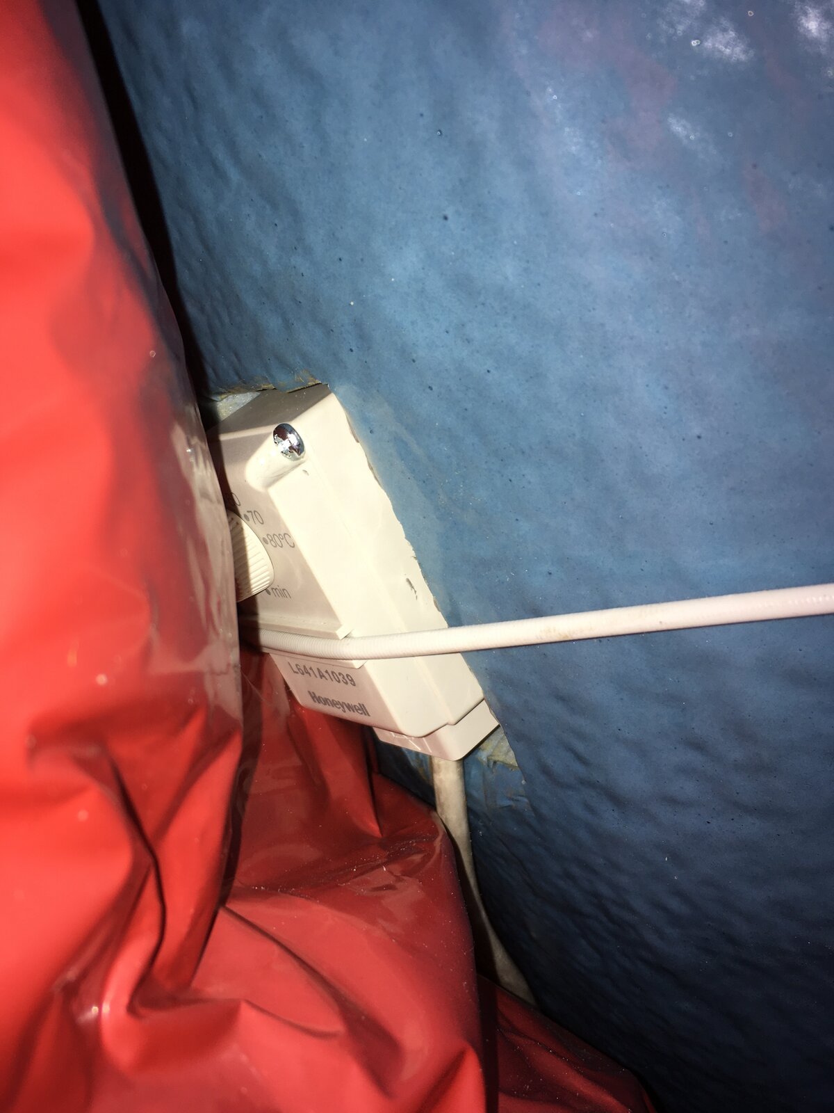

Hoping this is just a small one. Last year we had our HWC replaced with a steel one as the size it came in was best for the space we had available.
At the time I refitted the previous surface mounted thermostat from the old cylinder and found that the temperature control wasn’t as good as with the previous copper cylinder. I’m guessing this is because of the excellent heat conductive properties of copper vs steel.

If it’s foam lagged, then you need to remove a little bit of it to work properly. A photo may help.

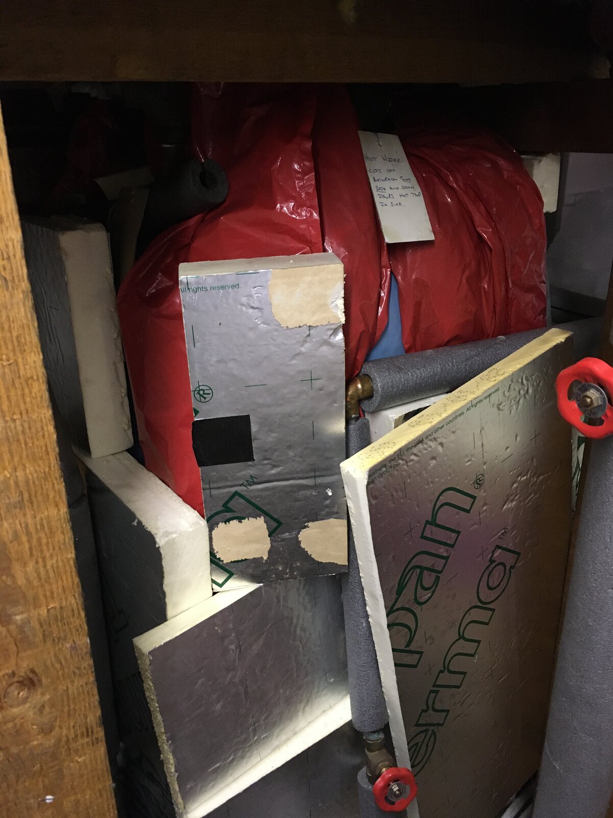

It is foam lagged and I've removed a chunk of it so that the thermostat is touching the surface of the cylinder. Sorry you can't make out much in this pic but it's buried behind 3 layers of insulation.
All that insulation is unnecessary - the cylinder is fine with it's factory sprayed foam and the stat cut in as you've done(y)
Hmm, I don’t think it is fine because there are long periods when the pump is still circulating due to not receiving the off signal from the thermostat even though the water inside the cylinder is all heated up.
Are there thermostats available that would more accurately monitor the internal water temperature rather than the surface temperature of the cylinder?

It also works the other way in that the water inside can be going cool which leads to a lukewarm shower because there is still latent heat within the casing causing the stat to think it’s up to temp.
I’ve now refitted the stat with thermal paste and it seems slightly better but still not right I don’t think
Difficult to see from that photo, but I wonder how high up the cylinder it is mounted. The bottom of the cylinder is where the cold water comes in and is below the heating coil, so tends to stay cool. As heat rises, the temperature will increase further up the cylinder and the water at the top can be 40 degrees or more warmer than the water at the bottom. With such a varying range, it can be difficult to regulate the temperature precisely when measuring it at just one point.
Manufacturers tend to recommend that the thermostat be located between one quarter and one third of the way up the cylinder, by which time the water is no longer cold, but not as hot as it is at the top.
