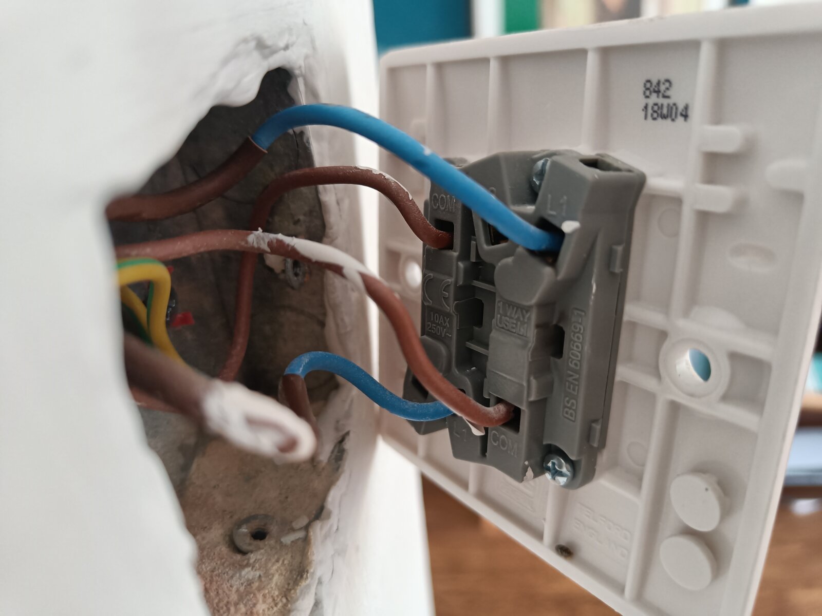

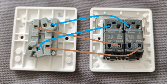

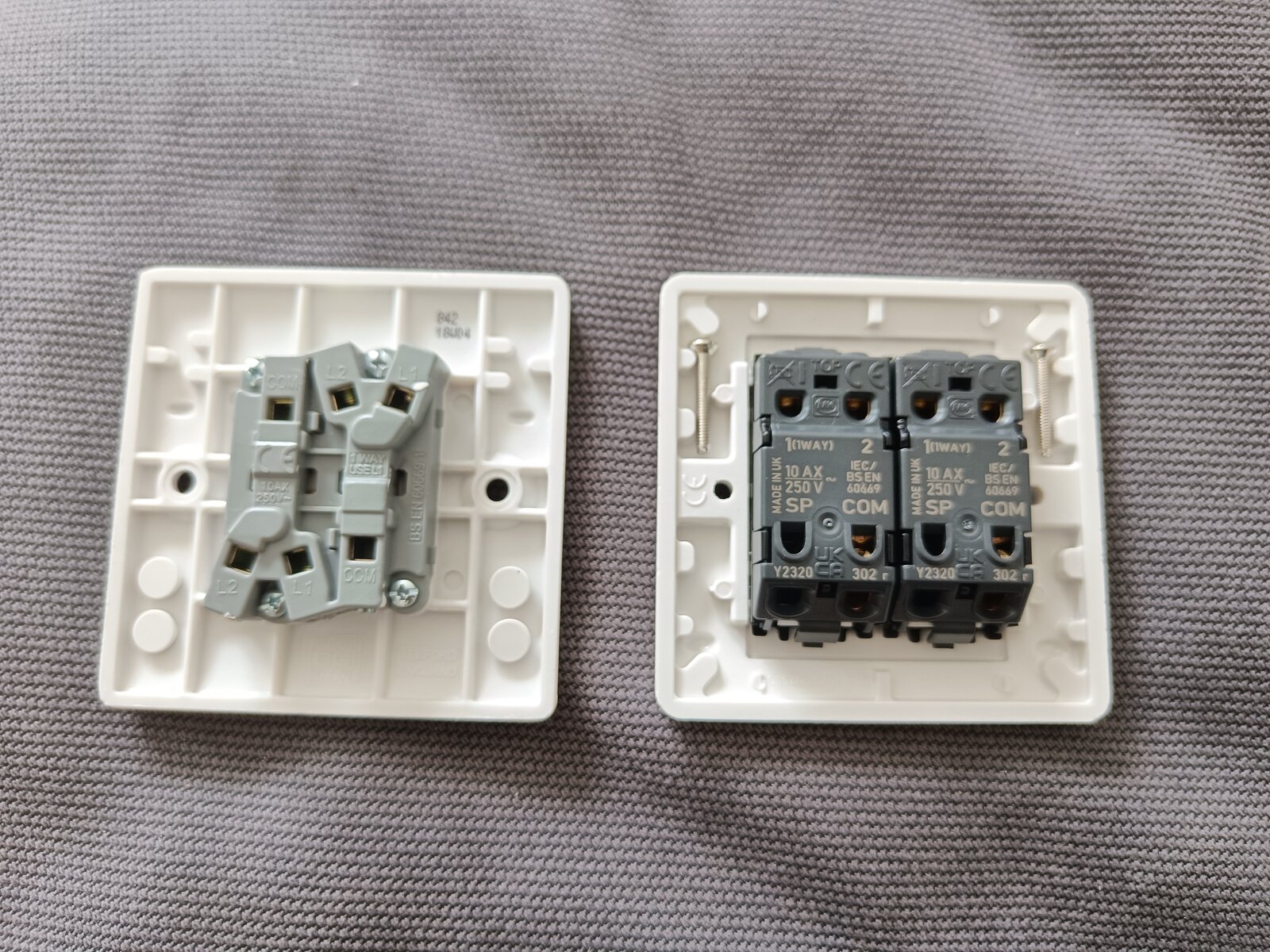

I see this is a common topic, but every single one seems different! First time rewiring a light switch (yes I've taken all appropriate precautions).

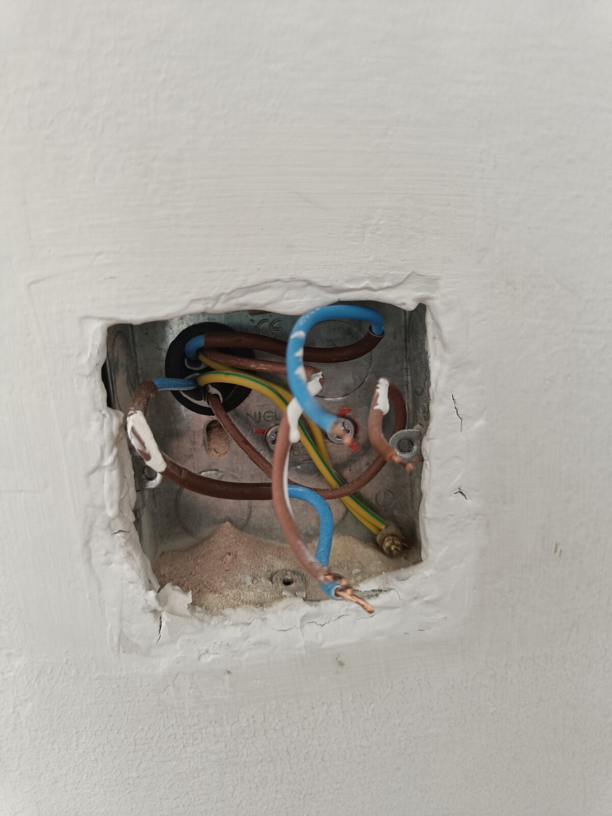

Old switch (left one on picture of backs) has neutrals in L1 and lives in COM as you'd expect. New one is plastic but has a warning on it about earthing all metal front plates, which is confusing me as I thought I'd bought a plastic light switch. As you can see from third picture, earth is just attached to back box.
Can I just put neutrals in L1 and lives in COM on new switch or do I need to do anything with earth?

You must copy the wiring exactly but bear in mind -
your present switch is two triangles with one upside down and
the new switch is two triangles the same way up.
