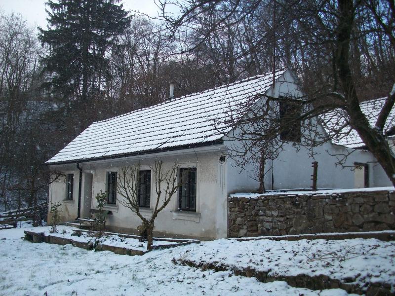

Reconstruction of a Moravian miners cottage about 30 mins from Brno, Czech Rep's second city. First built around 1890 with graphite mines nearby as a place where they cleaned and sorted the graphite, then reconstructed in 1924 by a miner who ended up owning the property. The miners family died out in the late 70's. Great location right in the forest set about half a mile from the village and with a stream running by.
The place was bought by somebody who didnt look after it and made a p**s poor reconstruction of the place in the 80's. He basically added a square roof extension with lots of lovely cement and asbestos. Then set about concreting the floors and cement rendering the walls. There isnt much conservation culture over here only on castles and Unesco buildings, plus from the communist era and people being more self sufficient due to lack of services many people do their own diy and building which results in some hit and miss or botch jobs.
The place looked okay when we bought it, just thought it needed a re-paint and new slates on the roof and re-wire the electrics and slowly convert the loft. Its our second house and we learnt a few diy skills and house knowledge from the previous or so we thought. We mostly bought it on the beauty of the location and looked past any problems with the house. Probably should of really read up and researched into old houses before buyng it as we have found many problems like the damp coming out when the house is lived in(previous owner stopped visiting regularly in the 90's). As we know now the concrete floors and cement rendering should never have been done, also the owner leathered the outside paths in concrete as well. He worked in construction in commie times and was some sort of blackmarketeer lifting a load of concrete, cement and material and set about selling it and trying to shoehorn the rest into this and another property he owns in the village. He also left us two skip's worth of old ****e around the place which were still getting rid of, at least we can ofset the cost with loads of rusty old scrap metal and we were able to find loads of antiques amongst the place.

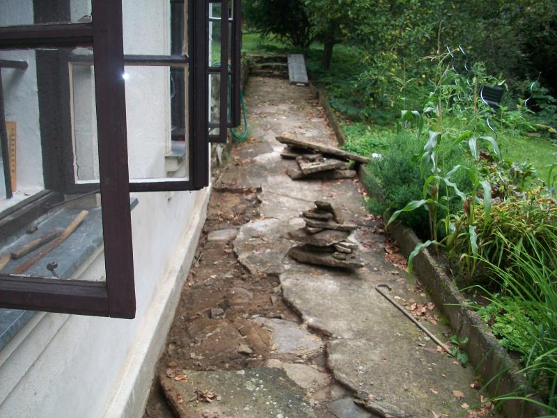

I agree with the advice about living in a property for a while before making any major changes, we've been here over a year now. As the damp gradually got worse we were able to use measures like destroying the concrete paths which were outside built up against the house trapping the moisture into the walls and not allowing the foundations to breathe. This stopped the damp creeping up the wall and that horrible damp feeling in the air in the rooms. A French drain and a drying period when we got our old wood burning stove going again has stopped it altogether. Also after looking into and receiving advice on using lime as the main material I rendered some outbuildings and the garage using hydrated lime as a test with good results. Although new advice says non hydraulic or naturally hydraulic limes are the best choice long term, these are a bugger to get hold of here and I might have to go to AUstria, Germany or even the UK for it.

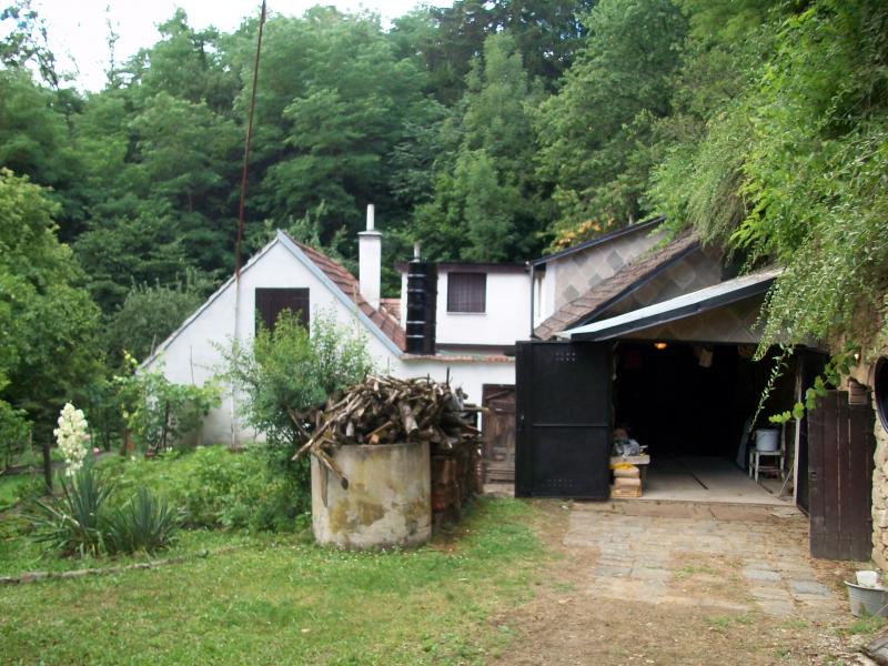

See ugly square roof extension in background and higher stepped then garage extension both to be demolished, garage as well in time, there is an old workshop behind it and a wine celler dug into the hill/stone wall on the right. Basically the property will be cut back to what it was like pre 1980's.
