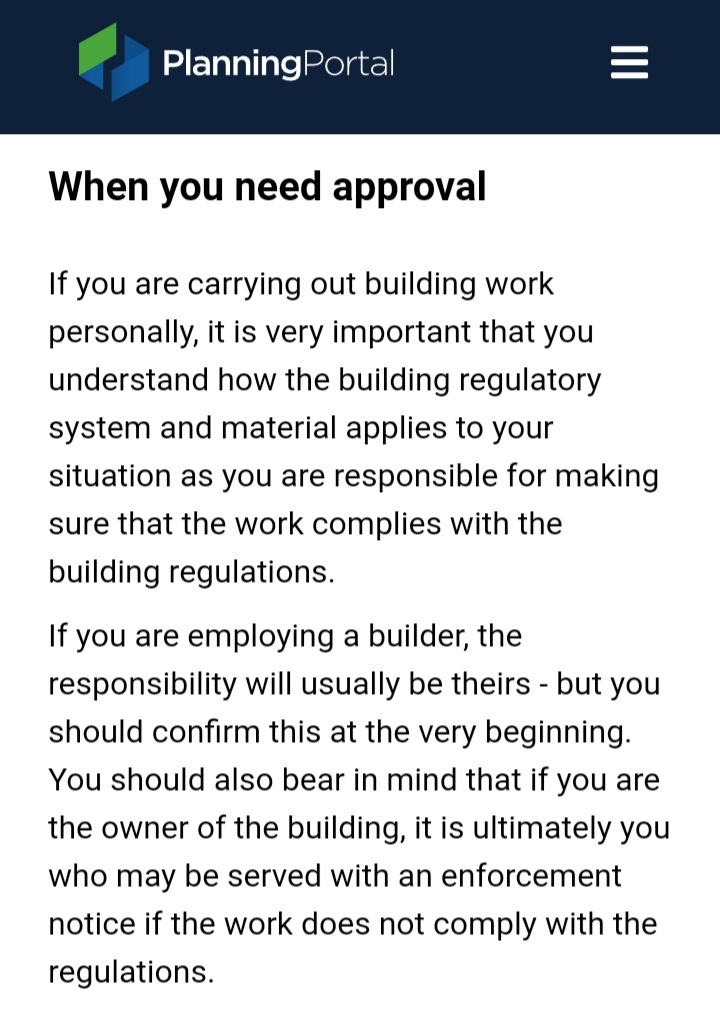

I might be playing devil's advocate, but I always thought it was our responsibility to ensure that the work complied with the regs?
Obviously it is a homeowners responsibility to make sure their property meets building regs and building control can't inspect every nook and cranny of the build.
But their job is to inspect key elements of the build that relate to safety which is paramount and basic. Most people are not aware of fire regulations and it's not reasonable to expect the general public to know that you need sprinklers in your house because it is not very common.
To turn up at the end of the build after the same officer visitied the build multiple times and say you need to destroy your newly renovated house and chase pipes into walls is not a very good service at all
