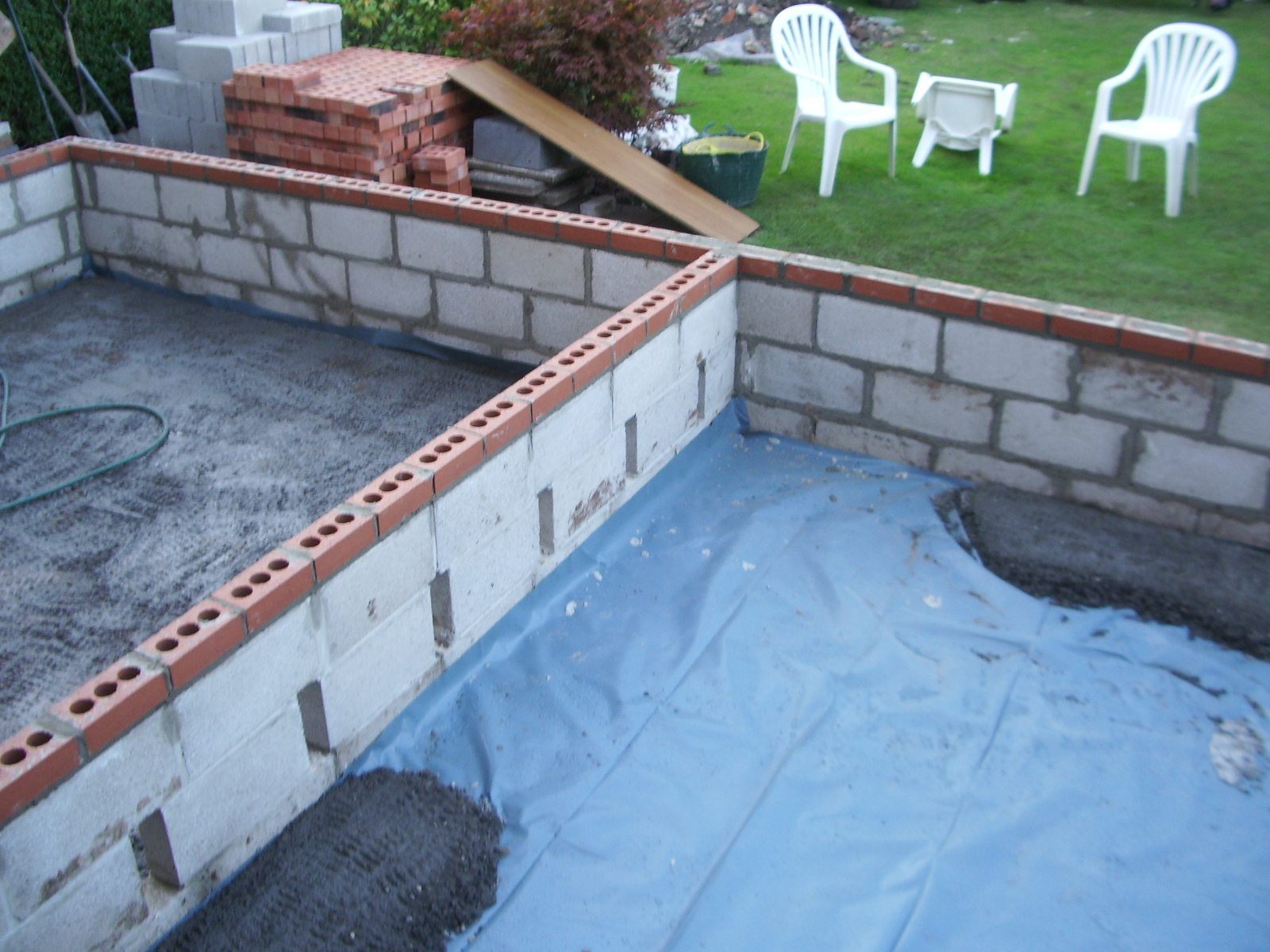

Cowboy brickies!???
That "brickwork" is in no way acceptable, and i am a bricklayer with nearly 40 years experience, the bonding of the blockwork is wrong too,letting them carry on will not end well.
oh yes - the left hand corner.
Right hand corner near fence panel,random half going towards corner.:confused:
Oh yes, in fact it looks out all across front pretty much.
beds aren’t even thickness and brick ends haven’t been buttered properly.
mind you I’m no brickie, I’m not sure I could do better - not that that is the point.
I have never laid a course of bricks in my life.
However, I think even I could do a better job than that one.

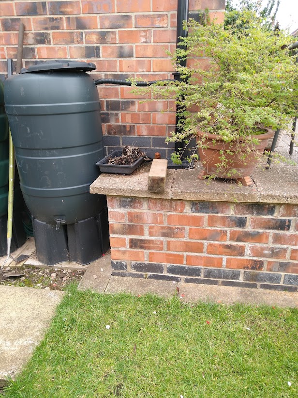

Well I have, and even my half decent attempt to do a patio support wall is better than the above. The brickwork on the building to the left was done by a proper brickie and is to a standard that should be achieved i.e. bed and perpends filled and pointed, and clean brickwork (although not great an issue if the blockwork is being rendered although have also included a photo of finished blockwork that will never be seen again)

I suspect the builder does not want to pay a pro brickie so he use some numpty who has not got a clue. As Woody says at least insist its done to an acceptable standard or risk the rest of the build being rubbish. Building inspector known and arranged by builder is a red flag also.
While it is at this stage it can be knocked down and redone without too much hassle, let it go on further and its going to be harder to stomach.
Stop the builder while you can, until this gets resolved.
