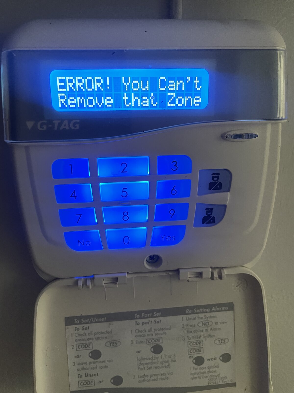

From the attached image, I enter the User code, option to set alarm, if I put yes, alarm goes off, if I put no then just goes to all other options. No way of cancelling the set

CPX will be like the 595 panel in programming it will have removable - or + as an option , this doesn’t affect wether that zone in on or off in part set ( just wether it can be manually removed ) also if it’s an EN version you have to enter user code and start setting , then put in the engineer code before it insets , then again to enter programming mode
dont think they can get into engineering as maybe they dont have the eng code.
the above should allow the zone to be omitted, if its been programmed as omittable if read the user manual correctly.
if its not then look at getting into engineering with codes available.
Entered user code from main screen ”enter code, check” no option to cancel the set. Asks do you want to set system, whatever code I enter, just sets off the alarm again. If I go through the menu, to remove zones, greeted by this.

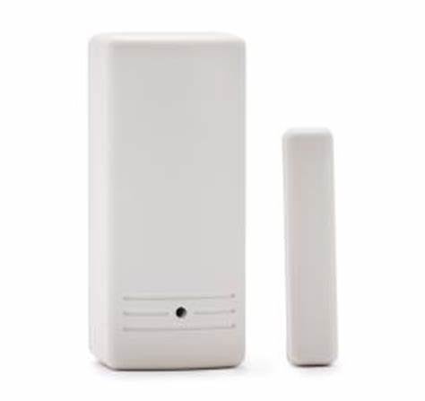

Thank you. I have tried using the master code to set the alarm, it just goes off straight away (because the problem is still there) before I have even entered the eng code, I enter it anyway, and just keeps going off until I use the master code to shut it up. looks like I’m just going to have to just replace the battery and set the alarm off, which I don’t want to do, especially as there is a way of doing it without settling the alarm off …..also I am not sure what battery is in the door sensor until I open it….but have an idea thanks to YouTube
normally door sensors are not omittable so that will probably explain why it cant be omitted.
I suspect it be CR123A as they will be the bulky door contacts.
