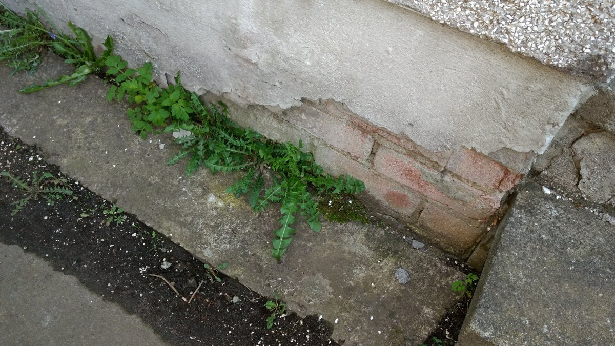

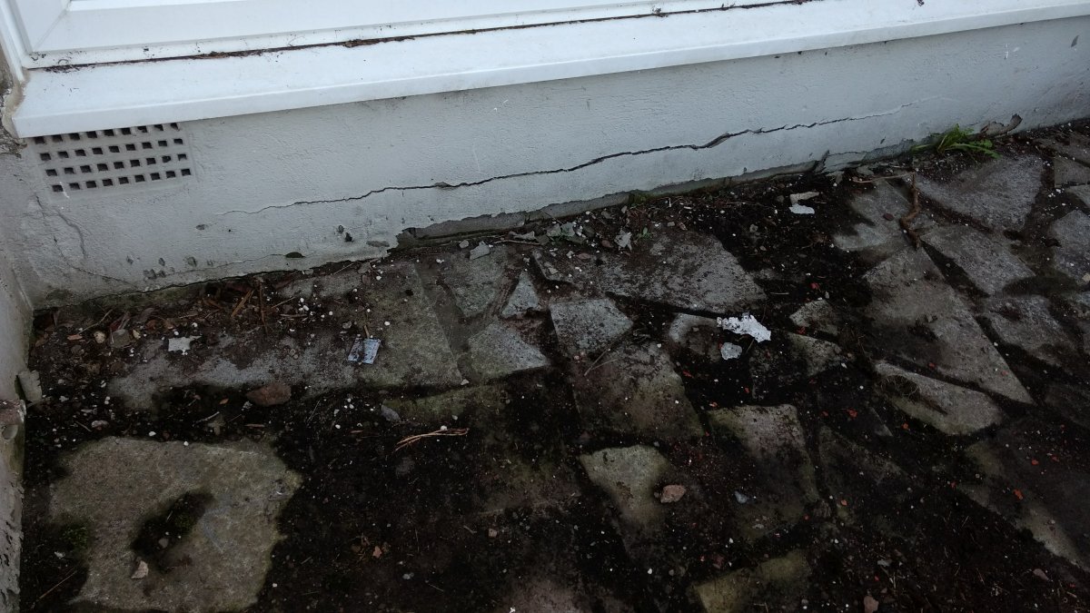

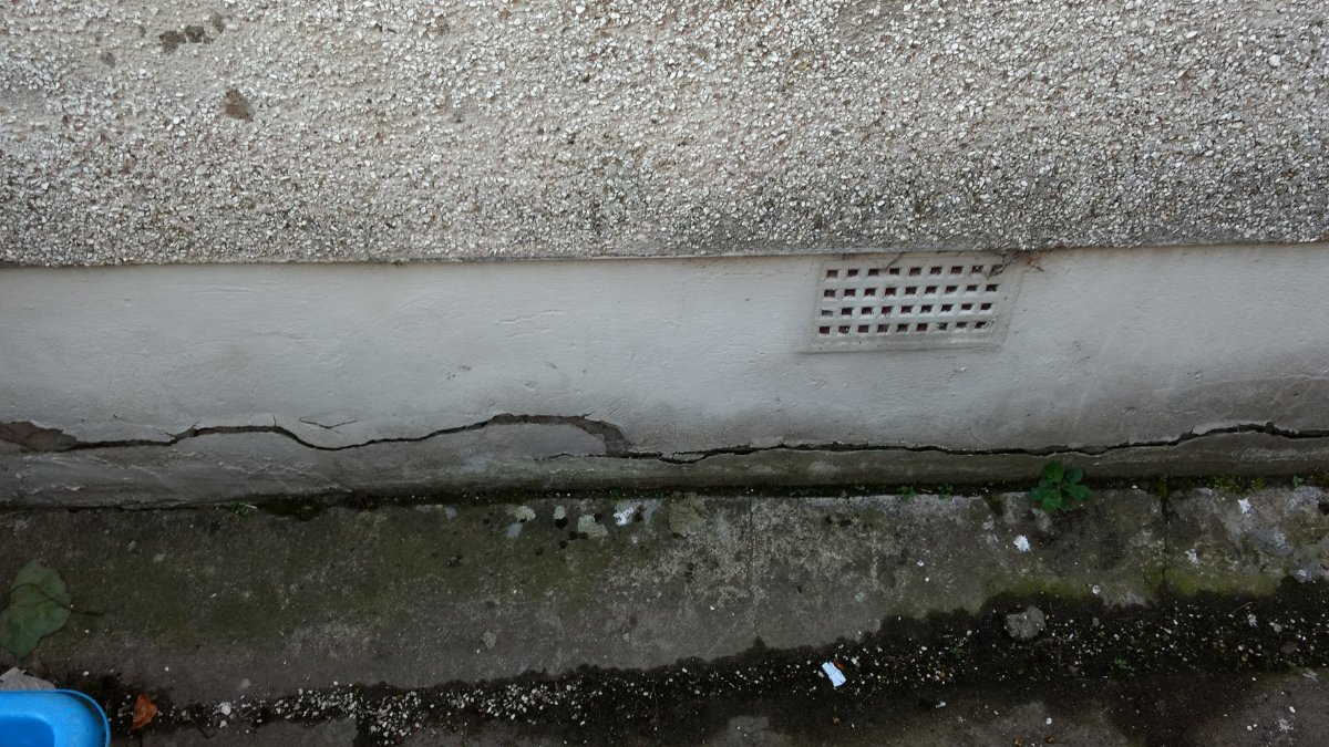

Hi there,
Just moved into a new house,a semi detached and it needs work. Part of which is addressing the cracked and broken render around the base of the house . See image below. In some sections the brickwork is exposed. Obviously it needs repaired, but just how serious is this?How would you go about repairing it ? Im guessing its best to remove it all and start again. What plaster / render (not sure on the terms) would i use.
Im happy to give the job a go if its not too big a job and doesnt take days to do do, otherwise id get a tradesman in - Would a plasterer do this work ? Any youtube videos on this? (i dont know the exact wording so cant find anything)
Cheers folks

Personally I'd knock all that render off... not the dashing.
Normally render shouldn't go to ground level, as it will soak up the water and possible breach the damp course.
I've similar dashing on my house it stops about 3 brick course from the ground.
Not to ground level ? really, my whole estate has this, probably around 1000 homes. Surely its better that the render gets the damp opposed to the brick work ?
OP,
Hack off all the render below the dash.
Rake out the pointing beds and perps to about 25mm deep.
Repoint.
You could then re-render leaving a gap of two courses (150mm) to ground level - render must not be in ground contact.
You should find the external DPC line and make sure that its not being bridged by render.
There is a flagstone in one of the pics that seems a bit high?
Are there any signs of damp on the interior?
The Pvc sill has not been extended properly and the end is gunked up with a wad of caulk which is allowing moisture to penetrate the render below - clean out and silicone re-seal.
