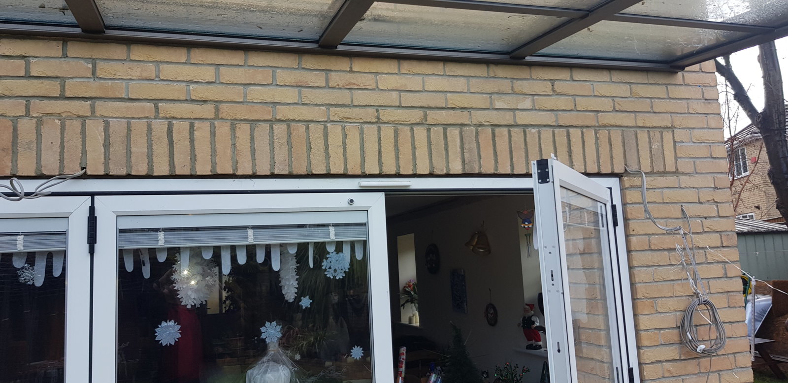

Is there a photo showing the head of the opening looking from outside to show how the beam is faced ?

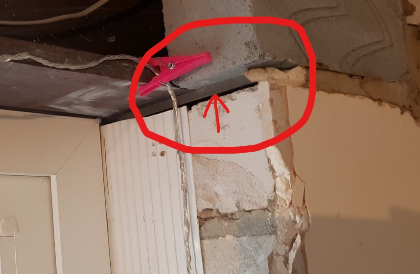

So the bearing plate to the inner leaf is sat on thin air and the "builder" has just face pointed it. The infill block is also just resting on the bearing plate with no mortar bed. For the life of me I cannot figure out what is holding up the inner skin above. How the hell did this get signed off by building control?

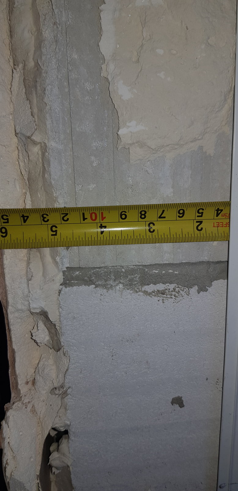

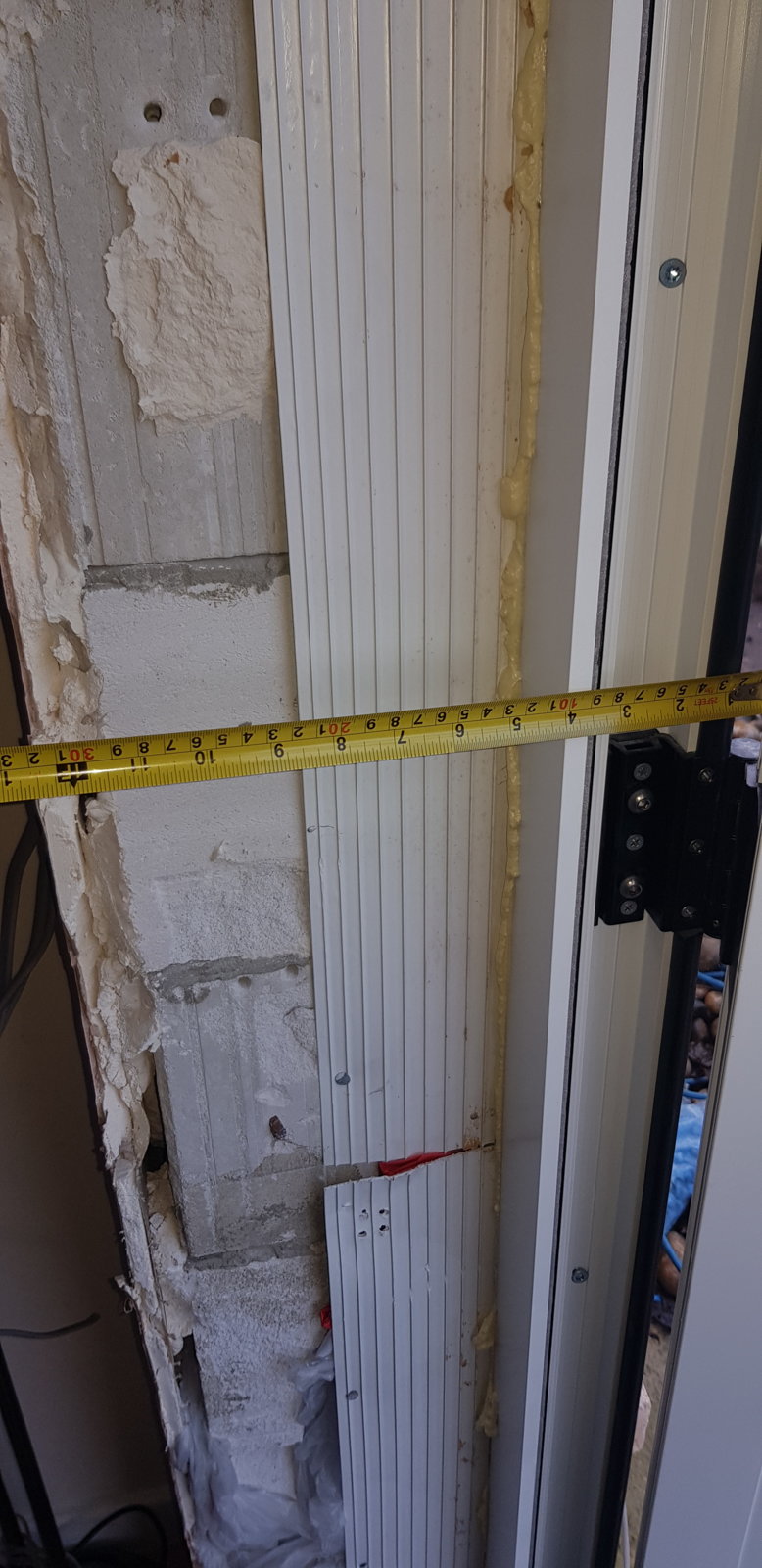

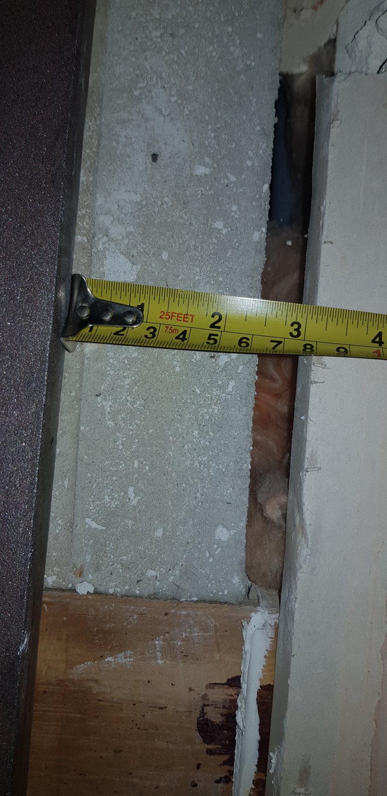

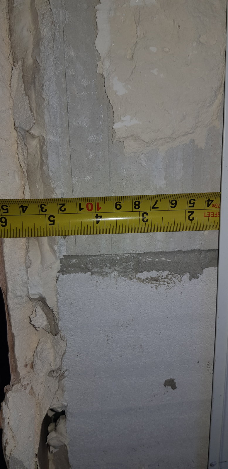

@tony1851 I've uploaded a picture of the measurement of the outer brick skin to the inside blockwork.

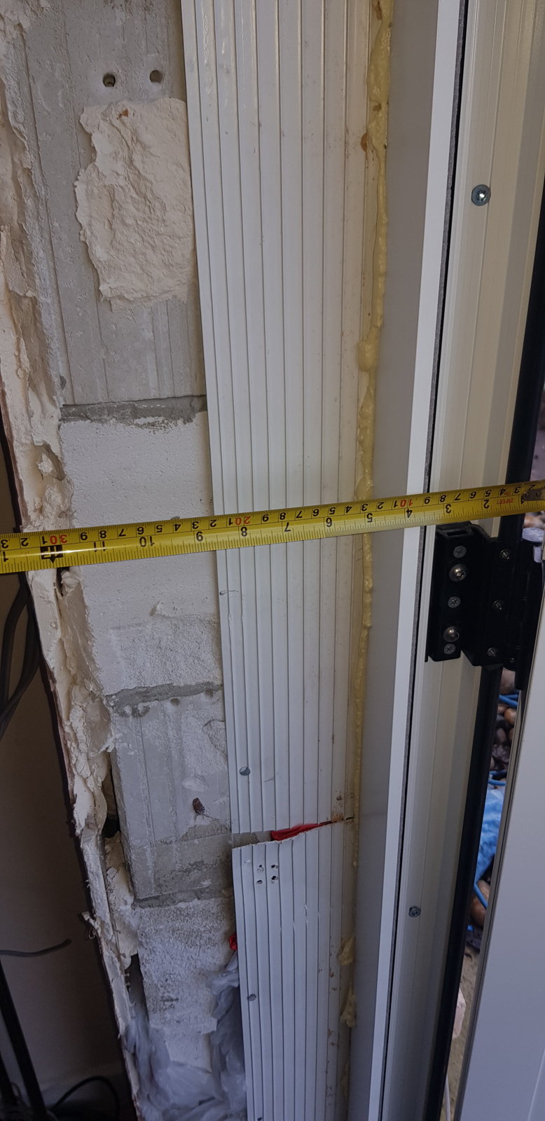

The blocks are approximately 120mm thick and 60mm of this is not being supported by the RSJ.
@Leofric I've uploaded some pics to this msg and also more uploaded at the initial link.

If the inner blocks are 120 thick, and they overlap by 60, then structurally that is not acceptable. The old rule of thumb is that you could overlap a skin of masonry up to 1/3 its thickness, so the maximum overlap in your case should be no more than 40mm.
It is astounding that your building inspector has not picked up on this.
The photos and the wall build up do not tally. Is that facing brick to the outer leaf or brick slips? If they are facing bricks the wall must be considerably thicker than 300mm.
We are just going around in circles here. You need to get on the phone to the structural engineer and get them to come out and take a look.

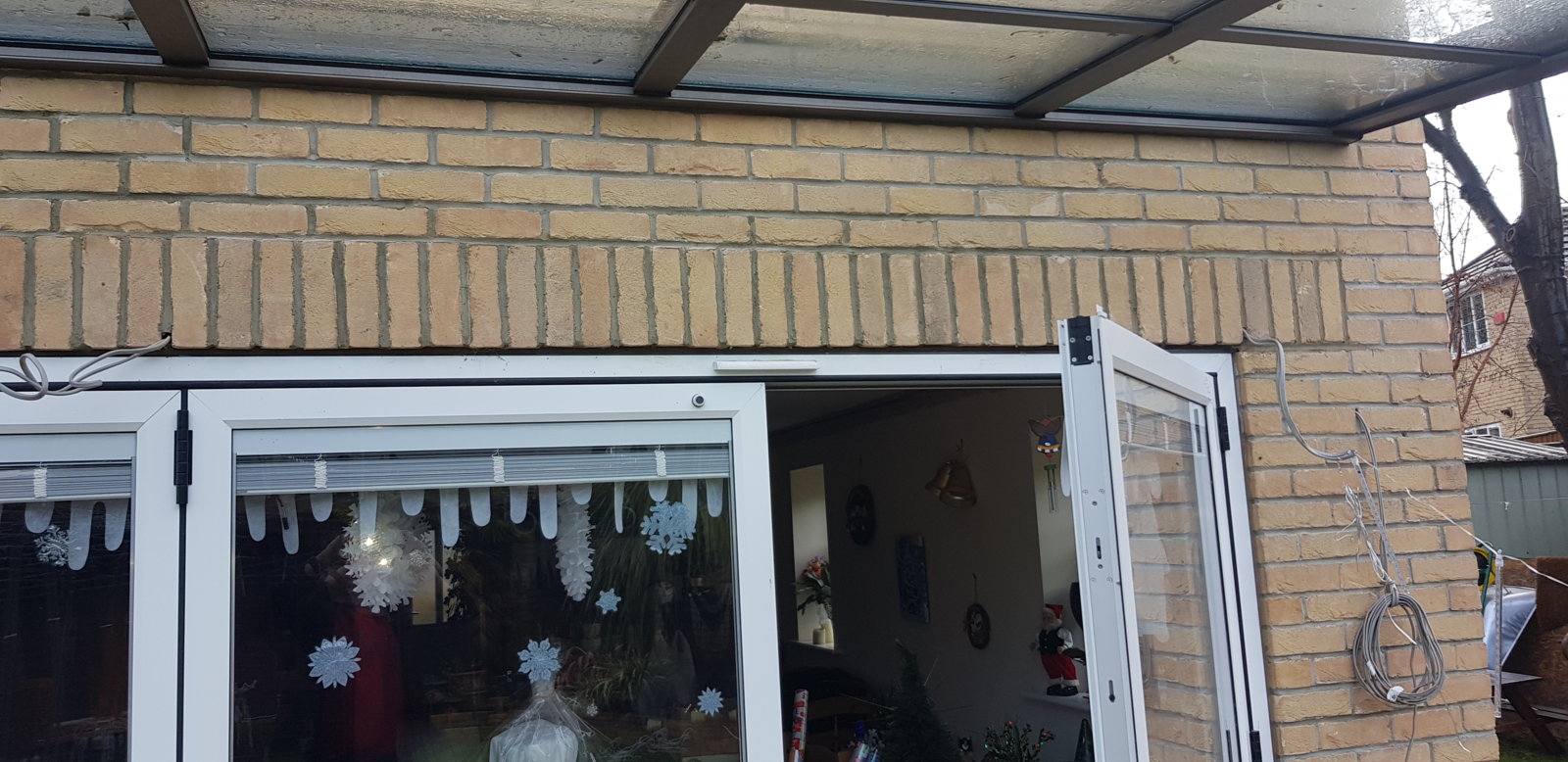

I agree with what the others are saying - this is not good building practice. There should be a dpc cavity tray over the head of the opening with weep vents at 450mm centres -can't see any in the photo. The bricks on end are usually 215mm high but appear to sit in the steel beam ! As for cold bridging and insulation! If the structural engineer could draw a section through the head of the opening to show exactly what has been built and approved by building control I think it would get pulled to pieces on here.
The usual detail for a steel beam over a fairly large opening in an external wall is to fully seat the internal leaf of blockwork on the top flange and support the outer leaf of brickwork on a steel plate welded to the bottom flange. Even then you need to minimise the risk of condensation through cold bridging across the fairly thick continuous bottom plate by using insulation and a vapour barrier.
ps the SE might have calculated the beam size but I can't believe they envisaged this construction.
