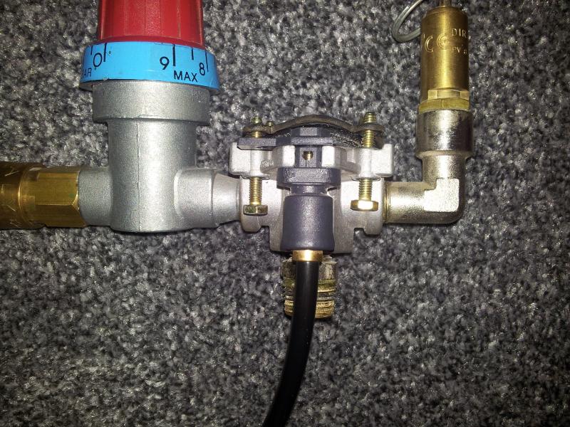

I bought a craft TA25/180 compressor 5 years ago through ALDI and the automatic shut off valve stopped working years ago, I always manually knocked it off via the guage but that has now failed. Everything else works fine so seems a shame to throw it away, I have removed all the electrics and gauge but cannot see any auto switch.

I've included some pictures here.
ordered and fit the new air compressor switch and for some reason it is the same as the old one when the compressor is filling up when it gets to about 95 psi the relief valve opens instead of the switch cutting the motor out.
These are supposed to cut the motor before the relief valve opens aren't they?
What pressure is the compressor supposed to run at.
The air receiver (air tank) will have a rated working pressure WP stamped on it.
Either the switch set point is too high or the relief valve blow-off point is too low.
Either way you must NEVER exceed the WP of the receiver.
Well the original pressure switch never used to cut out the motor so I replaced it for this one which I bought and it still doesn't cut off. The pressure rating is 116 PSI (8 BAR) The pipe is connected correctly from the tank to the switch and I've checked its not blocked, surely the new switch can't also be faulty.

Now resolved, just needed the pressure screw wound out a little under the cover to make it shut off at 90 psi before the relief valve opens.
