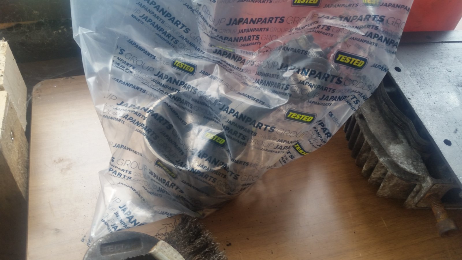

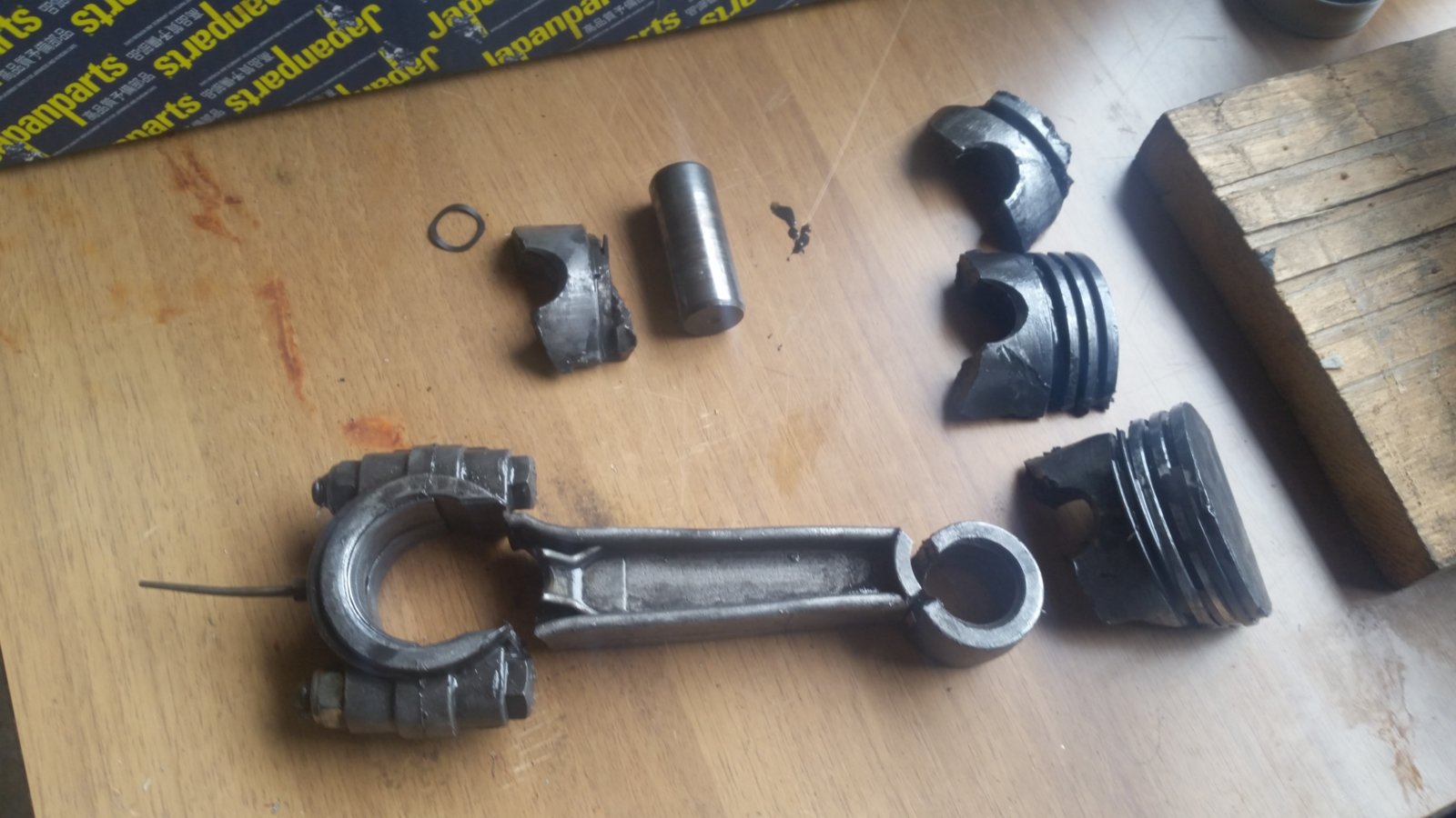

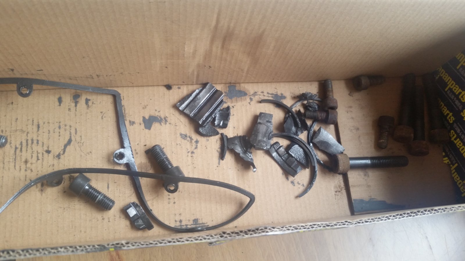

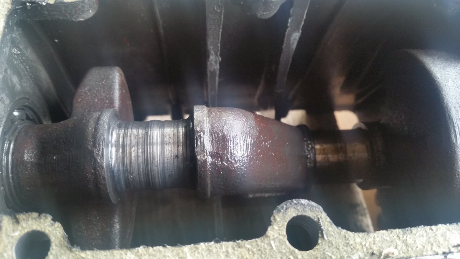

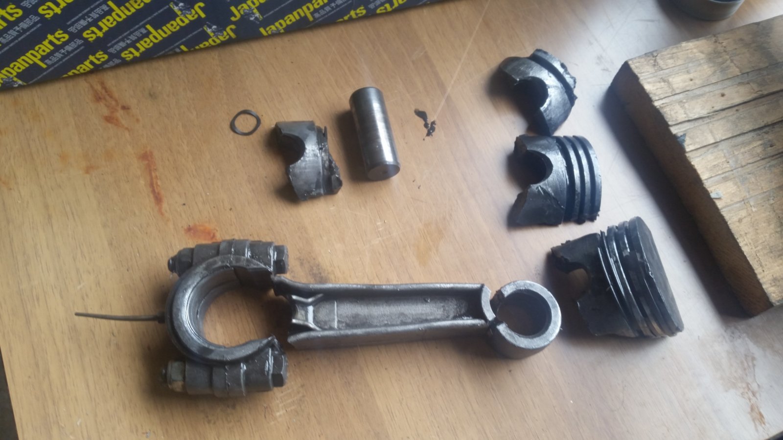

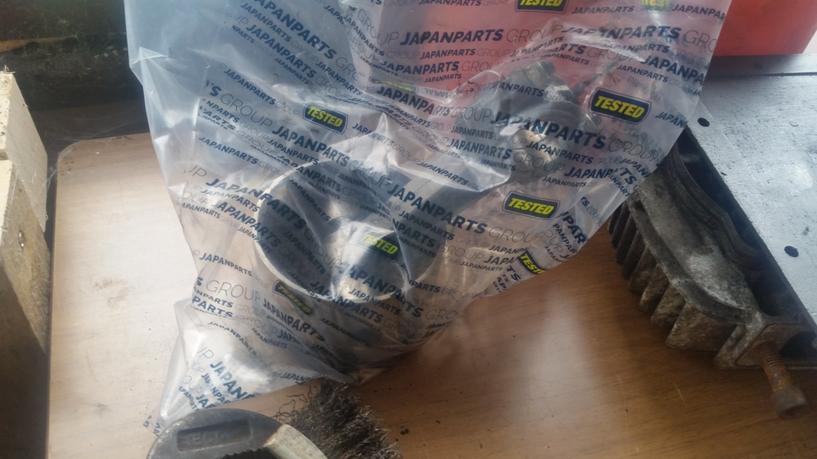

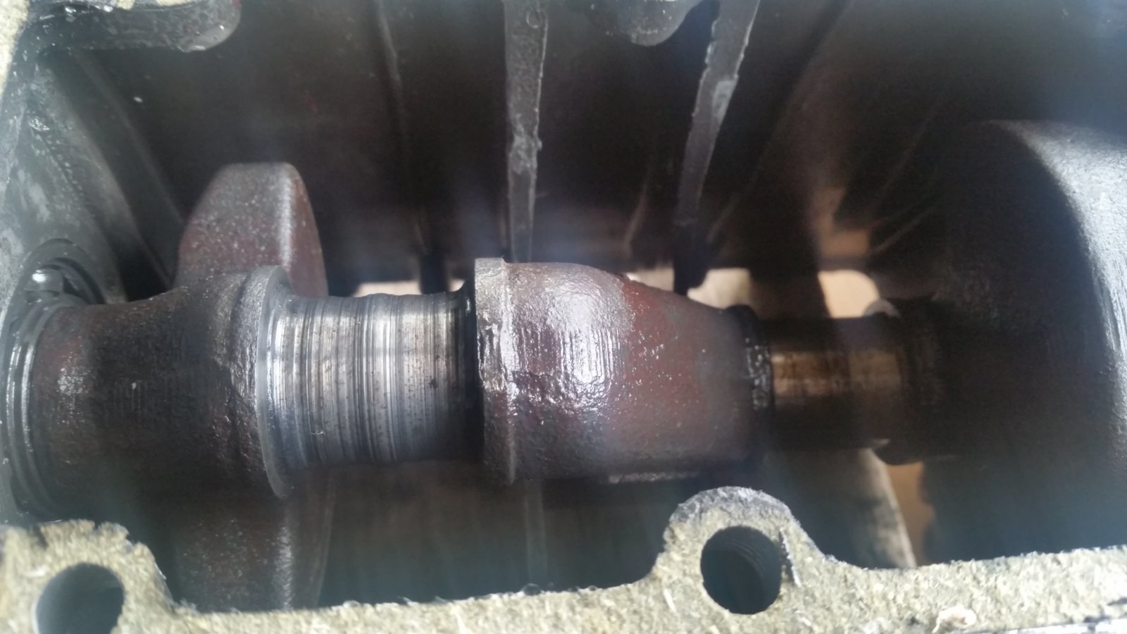

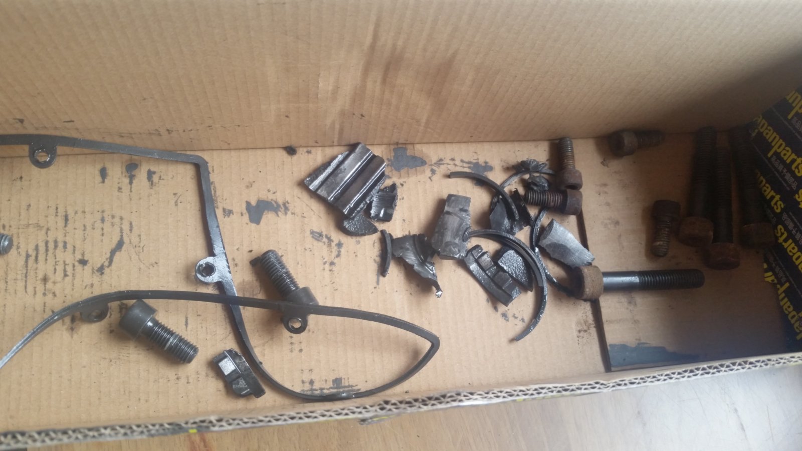

Aftermath of someone elses "care", pictures...
Saved low pressure piston. LP side of crank is also fine, no scratches/grooves.
And surprisingly cyllinder inserts/liners are absolutely pristine, both of them.
If not for the chip at the bottom of HP liner, cyllinder block would have been ok as well...
So, at this time i would need to replace:
1. Crankshaft
2. High pressure (smaller) piston head, rings, tierod, crank bearing
3. Cyllinder block
Yeesh...
