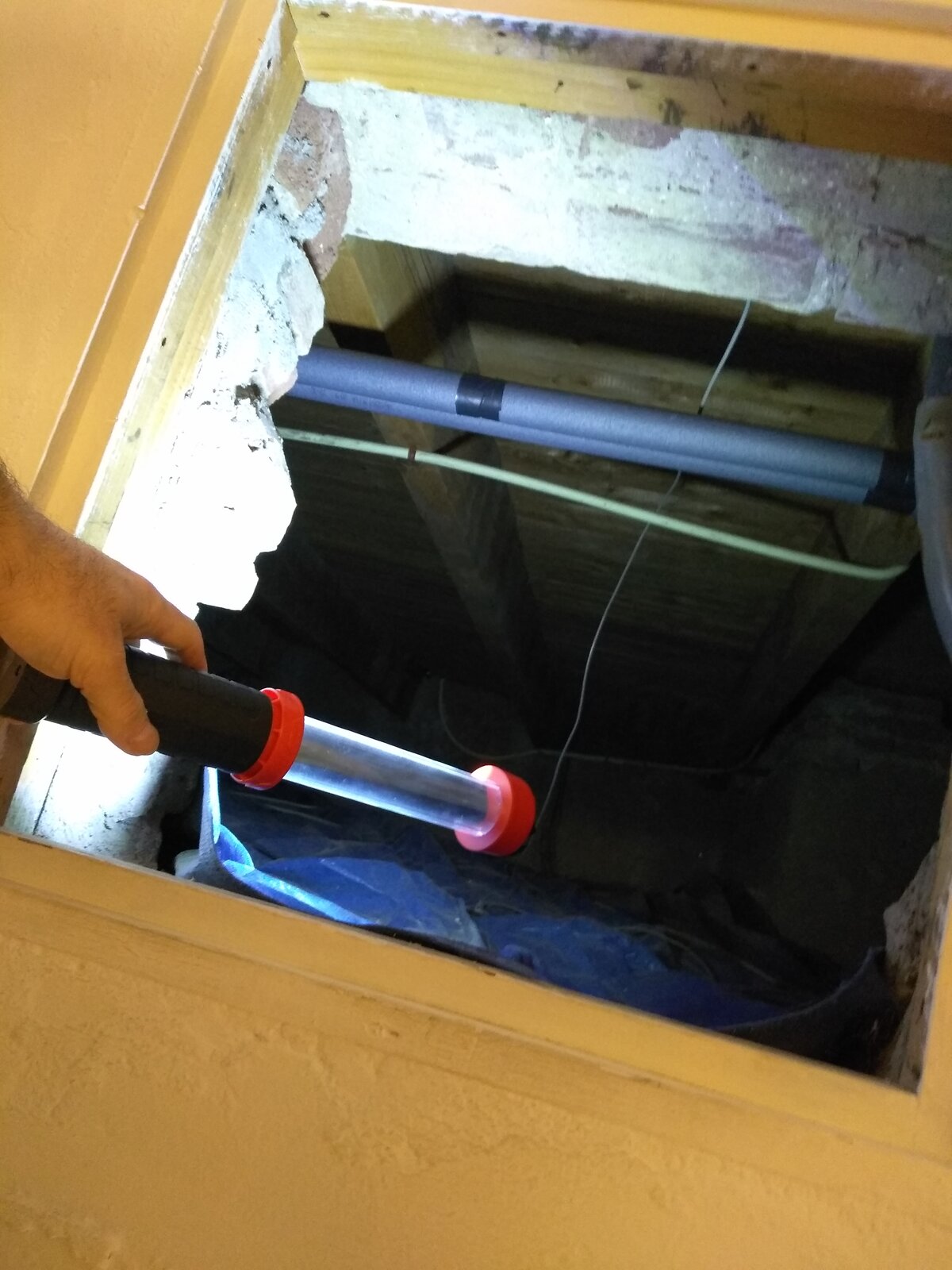

Hi, my ground floor wooden floor is quite cold. Underneath there is vented crawling space and I have access from a small window. I am thinking to add rock wool insulation under the floor between the joists.
How thick should be the insulation?
Except from chicken wire, any other ways to support the insulation?

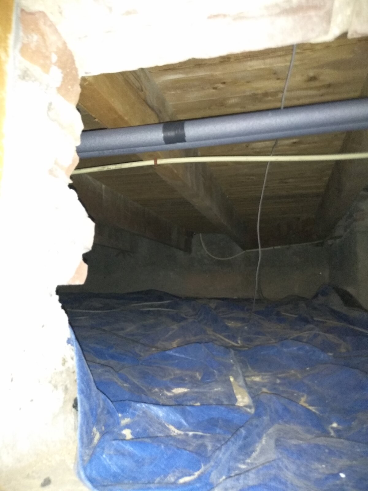

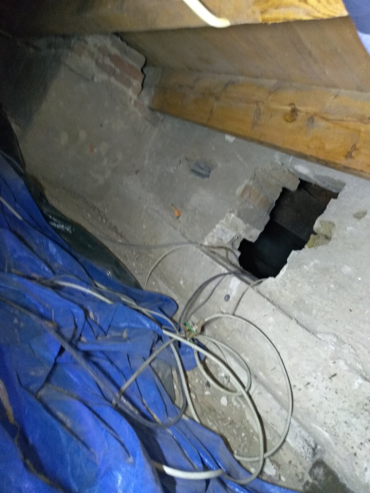

I did a bit more checking today.
There is a first window to access the crawling space with about 62cm diagonal opening, then a secondary window with 55 diagonal opening. So rigid PIR insulation would not go through, only option is rockwool rol that is flexible enough to squeeze through.
The original would floor had 22mm thick original boards with filler in between gaps and was painted with no visible gaps. Then added 12mm chipboard and 8mm oak floor planks glued/nailed on top. So about 42 mm thickness.
Would 100mm rockwool insulation be enough?
It is easier to fit the insulation at the bottom of the space between the joists leaving an air gap between underfloor and insulation. Then secure with plastic net attached with staples. That will leave air space between the floor and the insulation. Will this gap reduce the insulation? Or shall I try to fit the insulation so as to touch the floor underneath?

What is your joist spacing? Usually around 400mm centres, so you could pre-cut the PIR to 400mm widths and that would fit through your 62/55cm entry way?
As mentioned you need the insulation to touch the floor boards, any air gap can allow condensation to form and get trapped.

The crawling space is separated in two areas divided by s supporting wall. The first part has 62cm space between the joists. The second has 54cm between joists. I am thinking to buy rockroof flexi roll which comes in 10x100x500cm. It is quite wide so I can use 62x100 and 54x100 pieces. Cut outside before installing underneath.
You could make the second hole bigger without serious consequences, especially if you added a couple of wooden uprights.
It wouldn't gain much, but would be less of a squeeze.
