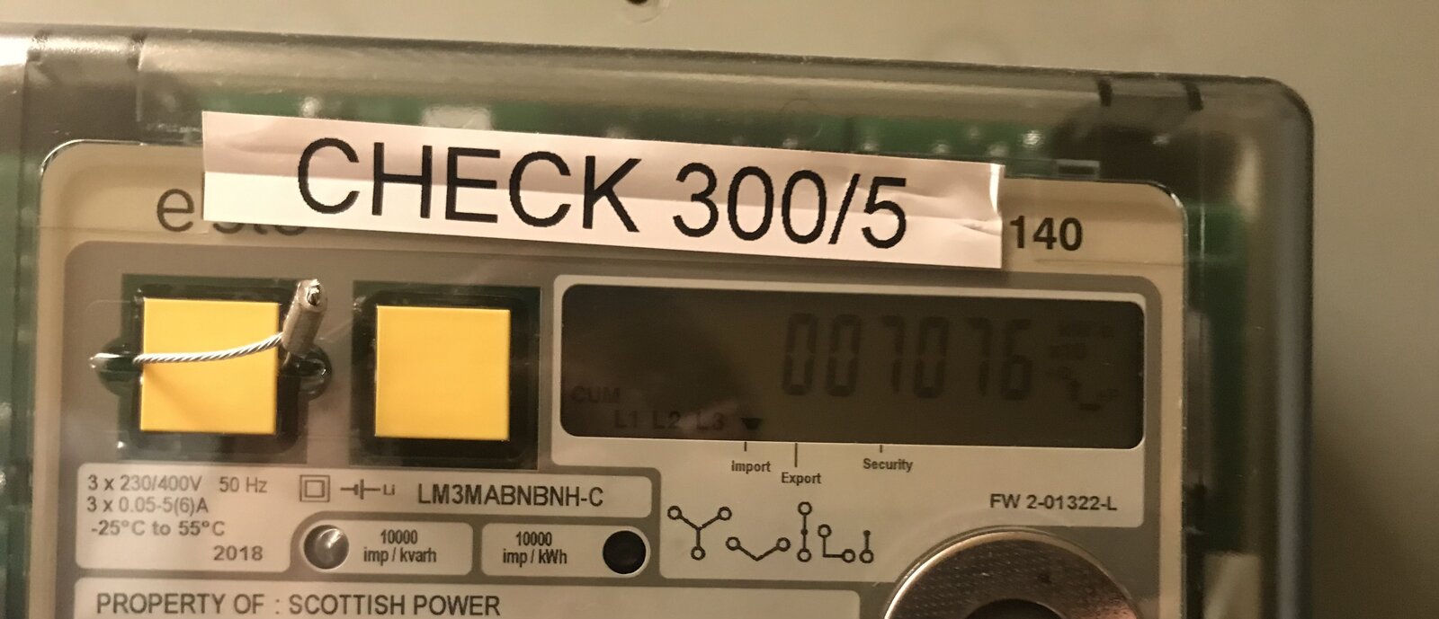

I’m with a large energy supplier (begins with O) and have what is known as a CT Supply meter. We are a small dental practice and our energy consumption is relatively low. We’ve been experiencing erratic bills and even no bill for six months. I have an active complaint ongoing since January and again since a July with the regulator now involved but they are hopeless.
We’ve suddenly received a bill for July for £5300 and another one for £450 pm when last year, when we took over the business it was about £80-100 pm.
I believe our consumption to be about 10kw per day because I’ve measured the 4 digit digital meter reading many times over the year including intraday sometimes. After a long investigation by the supplier they are now saying the charge is correct despite initially saying they agreed it was wrong after I sent pictures of the reading. They say that my CT meter is actually 5 digits and that a data reader dials into my meter (it’s not a smart meter) and they see 5 digits and not 4 (which is displayed on ours).
They say that our meter reading consumption needs to be multiplied by 10x. The means we’re using 100kw a day is impossible.
Below is their detailed email explanation. I’d really appreciate some help on this because something is not right.
Supplier response:
Your meter is shown as 4 digits meter readings, the 10x multiplier on your meter which means while your meter is showing a consumption of 10kWh, this is 100kWh as the remote meter reading is 5 digits. This multiplication factor is due to the CT supply (Current Transformer) and the meter has been configured due to the expected consumption in your property.

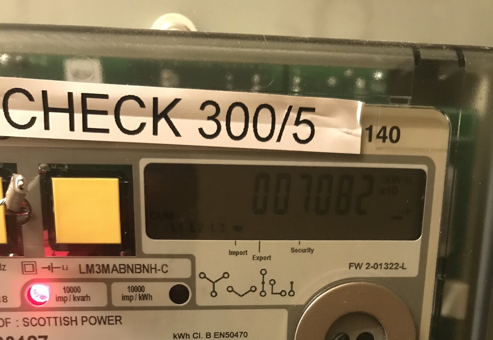

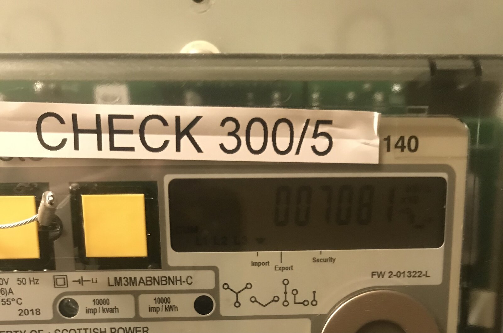

The two pics attached here show a meter reading at 512pm yesterday and 912, 4 hours later. The surgery was empty with myself and a colleague doing admin work with no machines on except a few lights, a computer and a small kitchen fridge running.
It shows 1 unit of electricity consumed meter reading 007081 and then 007082. 1kw I can understand but under their formula and this being a CT meter, we’ve used 10kw. No heaters were on either.

Your meter does have 'x10' displayed on the right hand side, but will no decimal point it is making the readings 10 times higher than they should be.
It looks like someone has configured the meter wrong - the difficulty is proving it.
Surely you meter reading of 007082 is a 6 digit reading?
Also, remember your usage is measured in kWh (kilowatt hours), I don't want to sound awkward, but you never know with the person on the other end of the phone/email.
