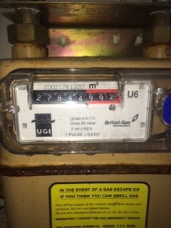

And a photo of the meter might be interesting.
You're not reading the decimal figure, I'm sure. You seem to be using 20 cu.m/day, where I've used average 5 in that period.

Nope not reading past the fifth digit. 27844
Agreed using 20m3 a day

In short the opening reading on the bill was not what is supplied and in fact 1200 units less than its actual value was photographed by me.
I had supplied the readings myself so incorrectly assumed they were billing me correctly.
Only after going through another phone (with the image) did I discover the error.
