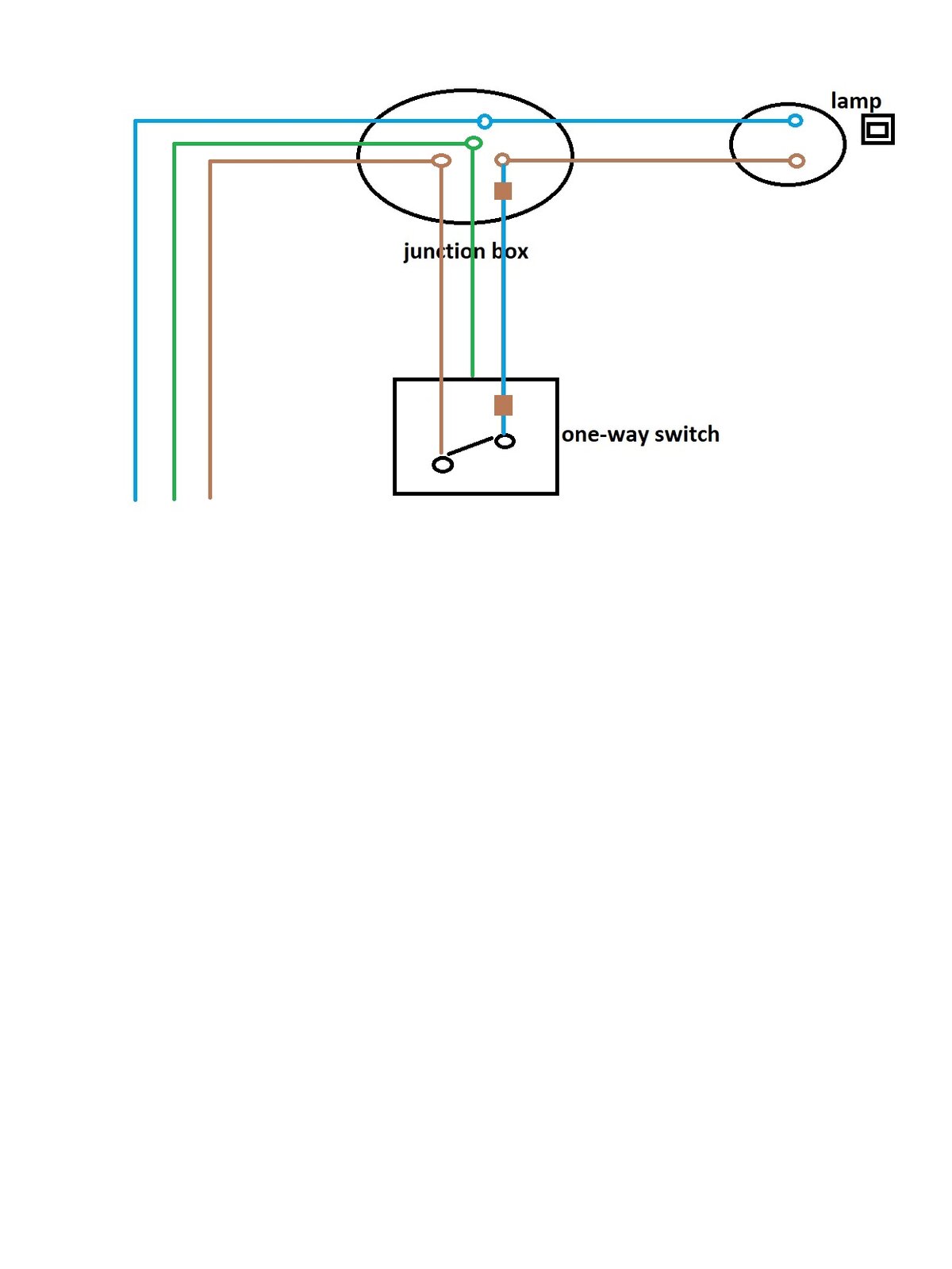

Here's what I'm planning.

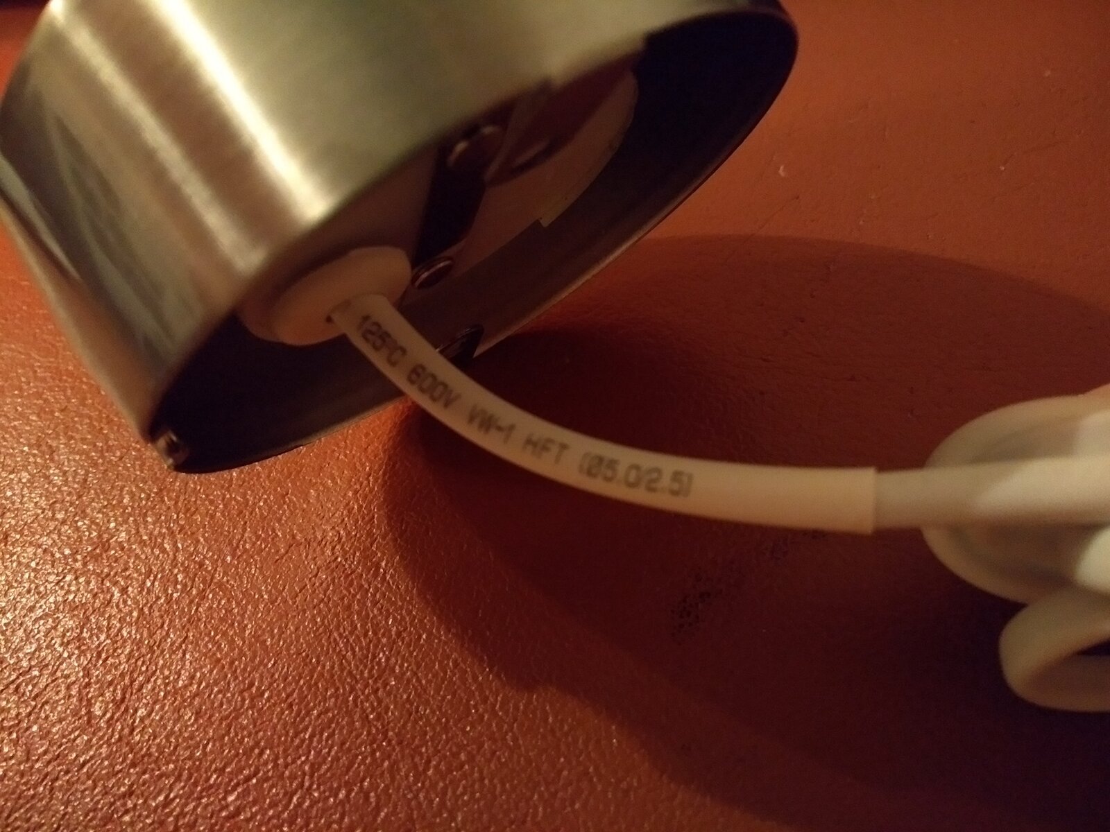

Picked up one of these lights:
https://www.toolstation.com/laghetto-240v-led-round-under-cupboard-light/p22705

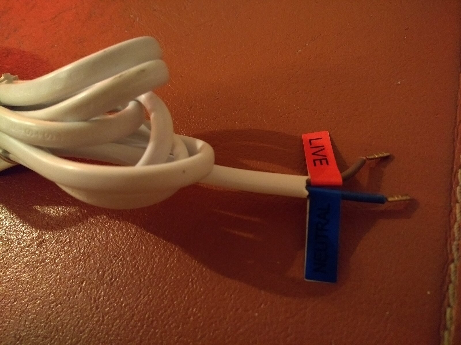

It's double insulated and comes with what looks like 0.75mm flex cable??
Intending to use these junction boxes:
https://www.screwfix.com/p/5a-4-terminal-standard-junction-box-white/8906d
Diagram shows one way switching for the one light, but I'm intending on extending the circuit from the first junction box and wiring it all up in exactly the same way for the second cupboard light and switch.
Look ok?
Given the wattage and type of bulb (LED) is this still a fire risk if left on accidentally?
Just to say thanks all for commenting.
Rigged up the cupboard lights and all good.
I wouldn't think so, as long as the fittings are mounted the minimum distance from another object and the fitting is F marked (if mounted on wood).
Cannot find the full instructions online, but it is said to be suitable for mounting under cupboards, so it must be F marked.
